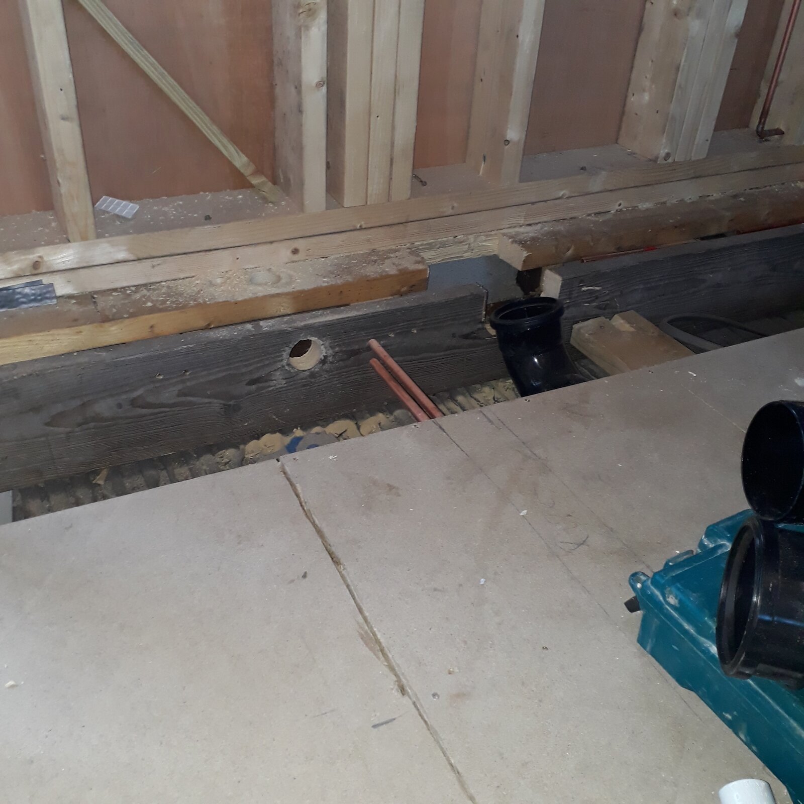

Hi,
I have connected the break in the run already but found it coming loose. Can I sandpaper off all the glue and redo it as it is? Or would I have to do it the harder way?
Many thanks in advance.

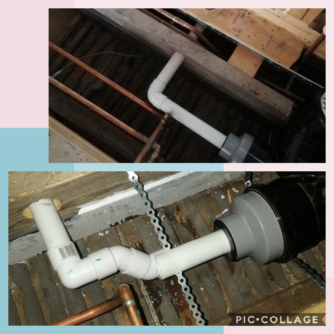

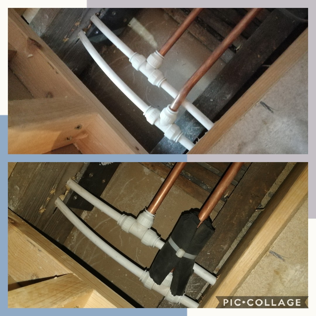

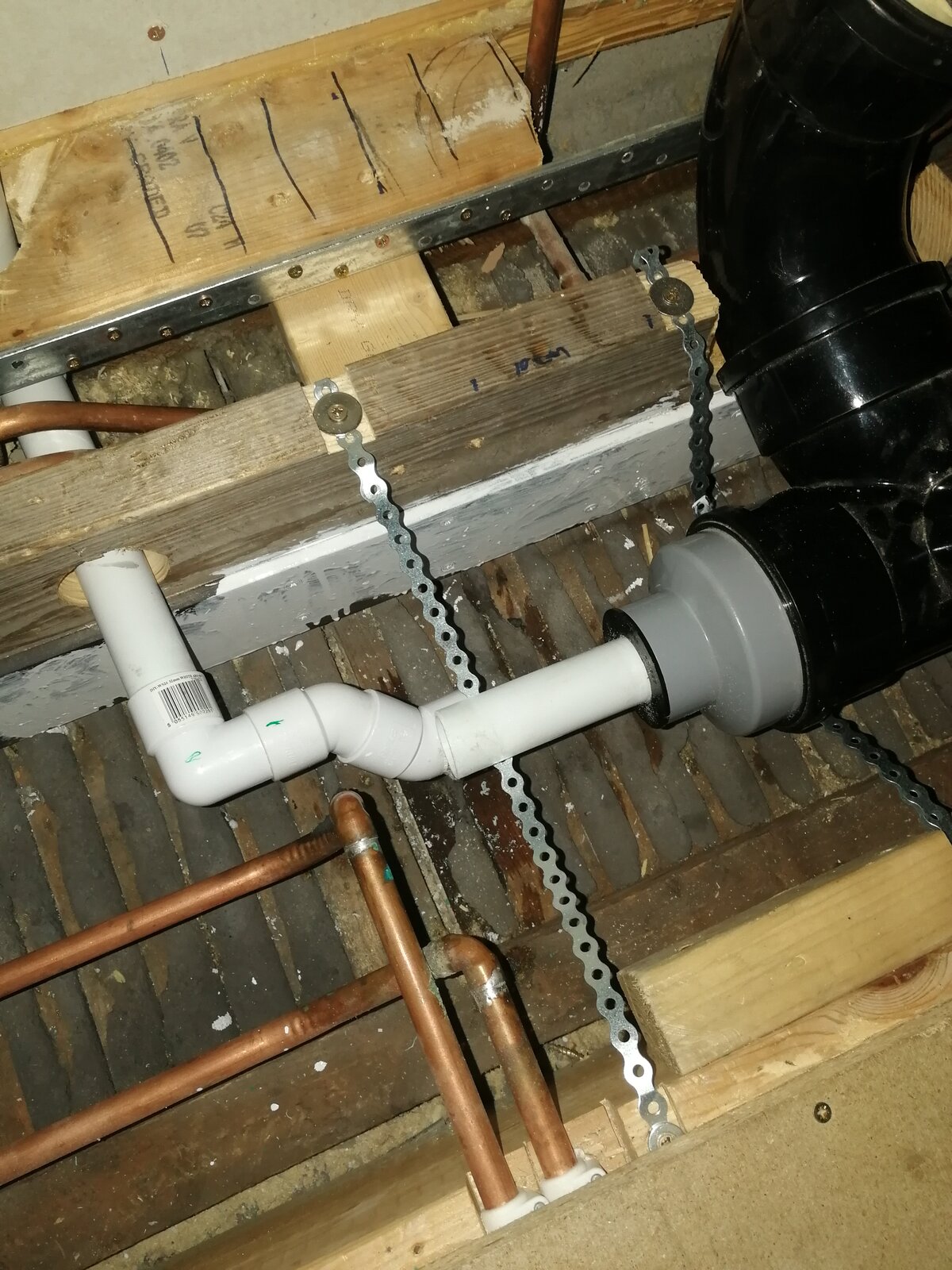

Those crossing copper pipes look a bit close together or is it camera angle that makes it look that way
It's the camera angle thankfully! It was this I was more concerned about (all strengthened now tho). The last pipework pic is my fault to be fair.
