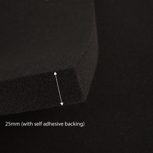

I used an 25mm acoustic foam (Self adhesive option - see link where i got it from) to deal with a noise issue i had.
http://www.fabricuk.com/fabrics/935-acoustic-foam-25mm-self-adhesive-backing.html
This is what i done :-> Fixed 30mm battens onto party wall, Stuck to the party wall in between battens 25mm acoustic foam self adhesive, which left me 5mm void gap (intentionally) then fixed plaster boards over the battens, this reduced the neighbors noise drastically.
