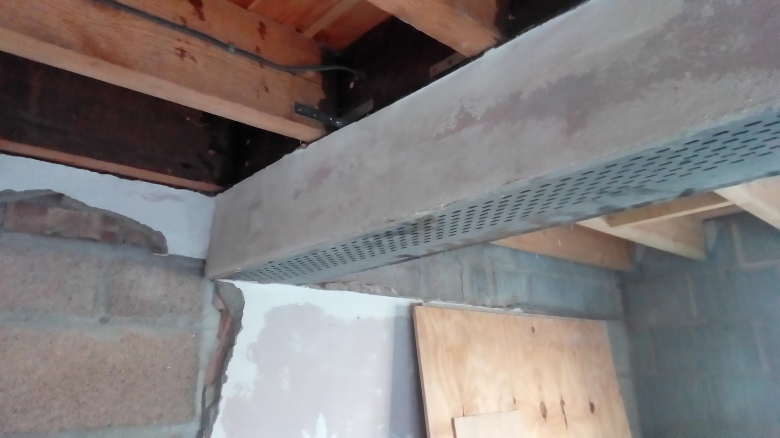

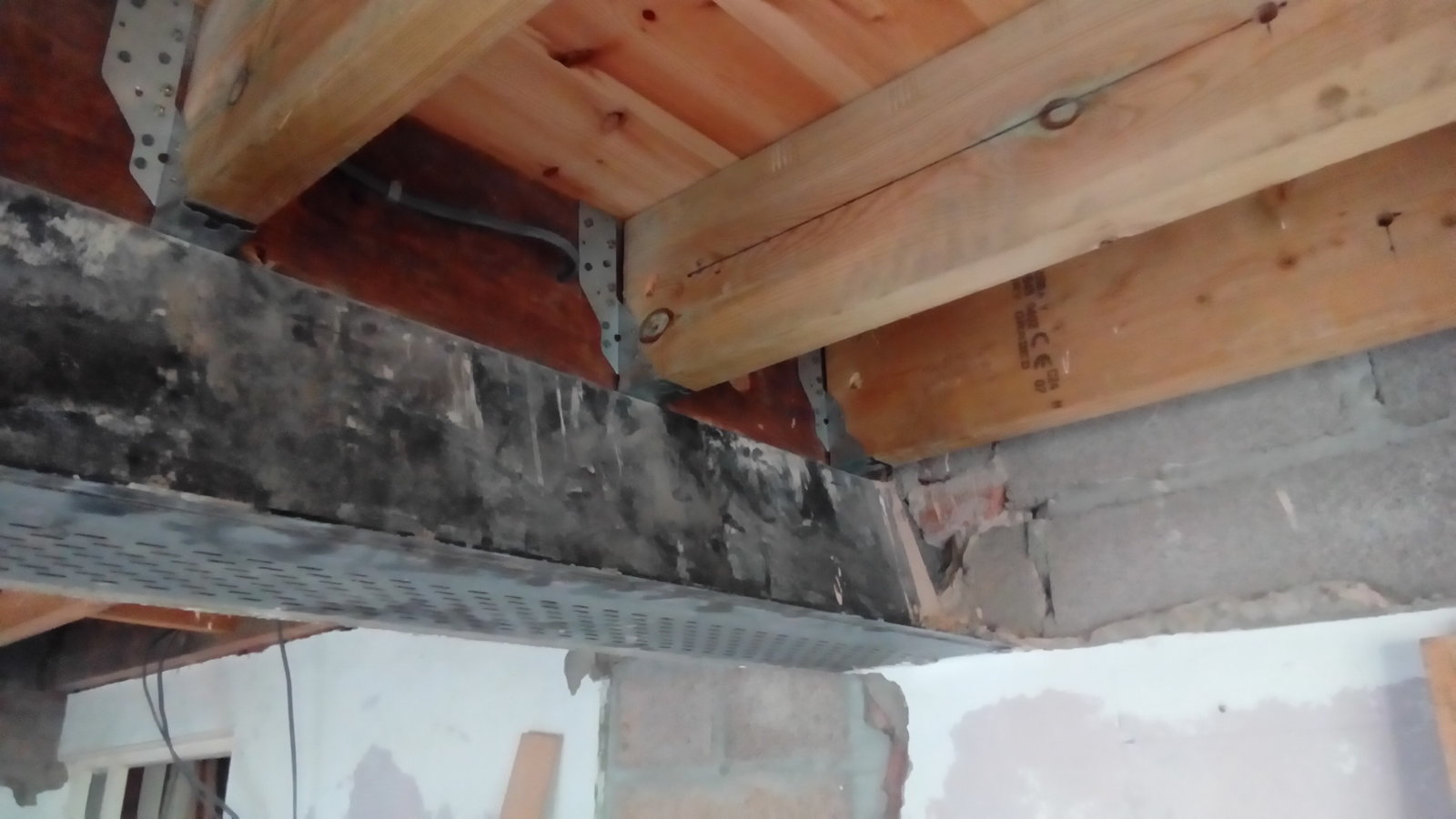

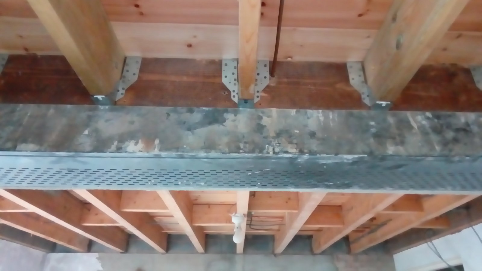

P_20190429_174452.jpg P_20190429_174431.jpg P_20190429_174525.jpg There was a dbl balcony door set into a 4m wall above this steel lintel, but no longer, it just supports floor joists these days.
Will regs want it clad with 2 layers of plasterboard? And what type and thickness?
Thank y'all kindly
if it's doing anything structural then yeah, the normal is 12.5mm pink fireline board or double normal board.
