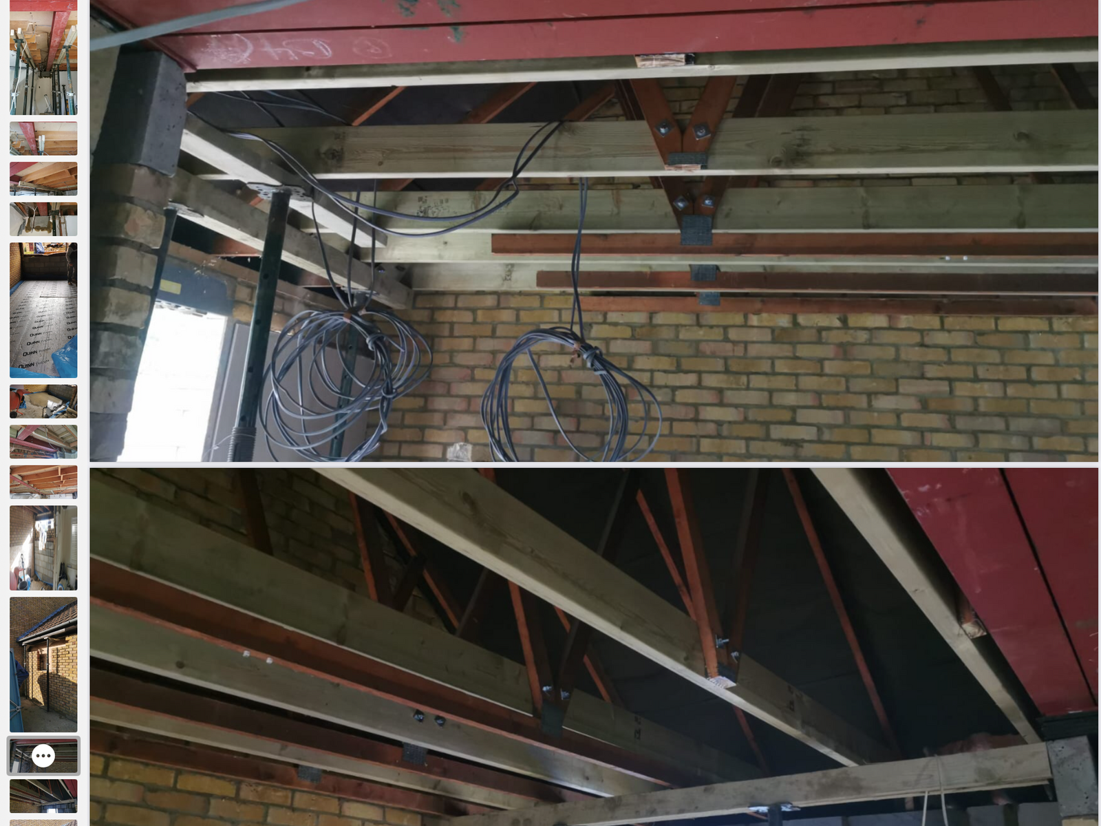

2. Calculations are required for the spliced floor joists and the cut trussed rafters.
3. No restraint straps have been provided the roof/new infill panel.

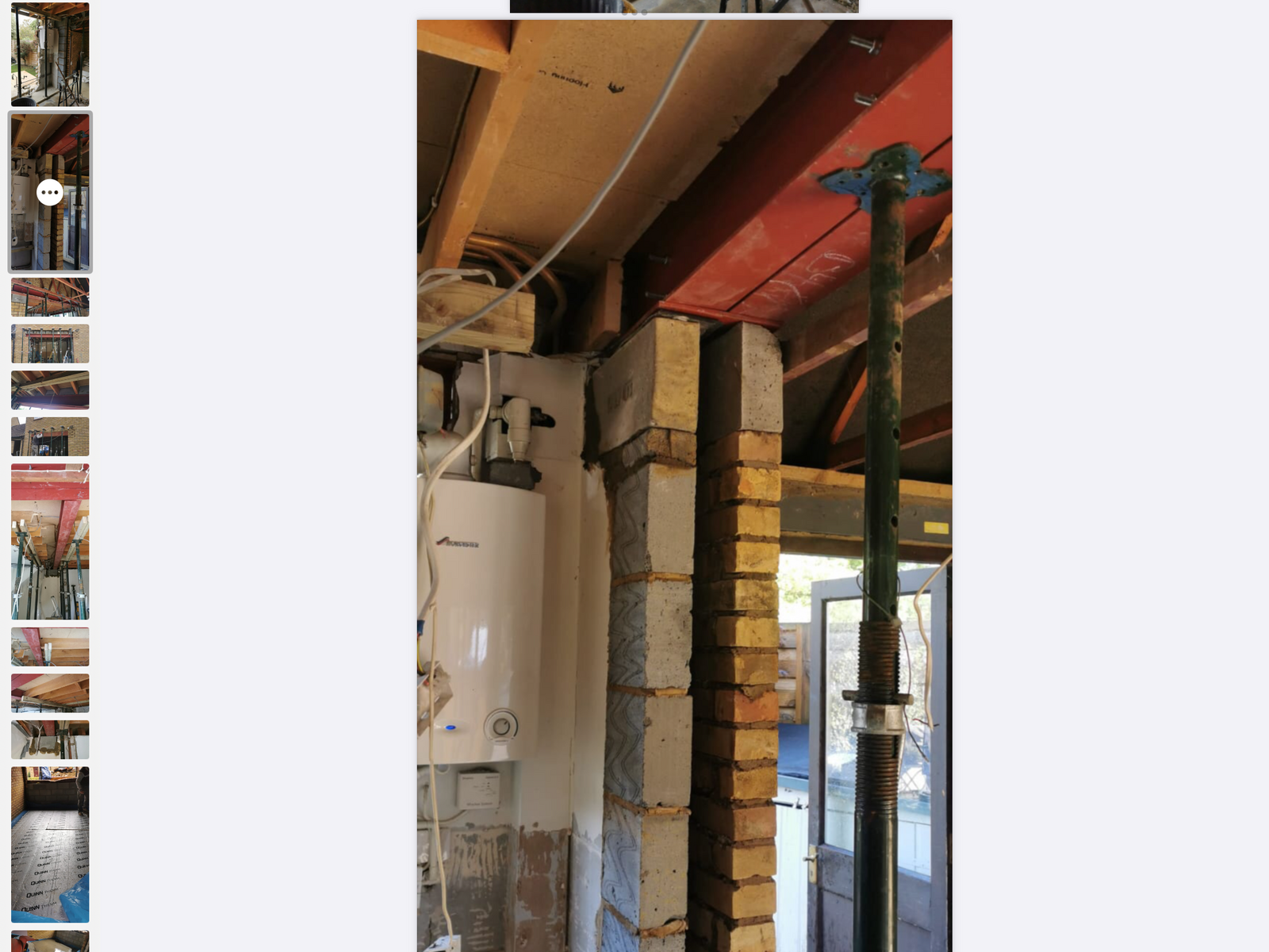

4. There appears to be non-metallic material between the steel beams and the concrete padstones. Please clarify.

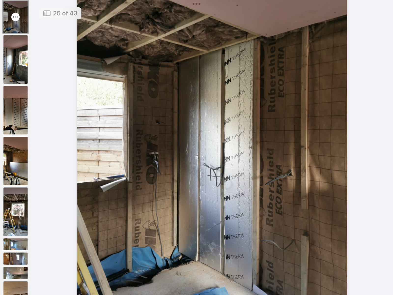

11. The screws fixing the battens to the walls have pierced the membrane. This will lead to damp penetration. In addition, the IKO Rubershield ECO EXTRA is a breathable roof membrane. Please provide the manufacturers details to confirm that can be used in the position indicated in the photographs.

could someone tell me/explain what this is on the RSJ in-between the flange plate & pad stone?
asking as the inspector has asked.

as the timber rafters are bolted to the old timber rafters does it still require a restraint strapping?

3. No restraint straps have been provided the roof/new infill panel. They need to be fitted if necessary
4. There appears to be non-metallic material between the steel beams and the concrete padstones. Please clarify. You need to identify the material and clarify it to Building control, if it's slate or metal for example it will be fine, if it's a bit of old newspaper it may need changing.

11. The screws fixing the battens to the walls have pierced the membrane. This will lead to damp penetration. In addition, the IKO Rubershield ECO EXTRA is a breathable roof membrane. Please provide the manufacturers details to confirm that can be used in the position indicated in the photographs. You'll need something like a BBA certificate or something from the manufacturer to prove screws though the membrane are acceptable.
