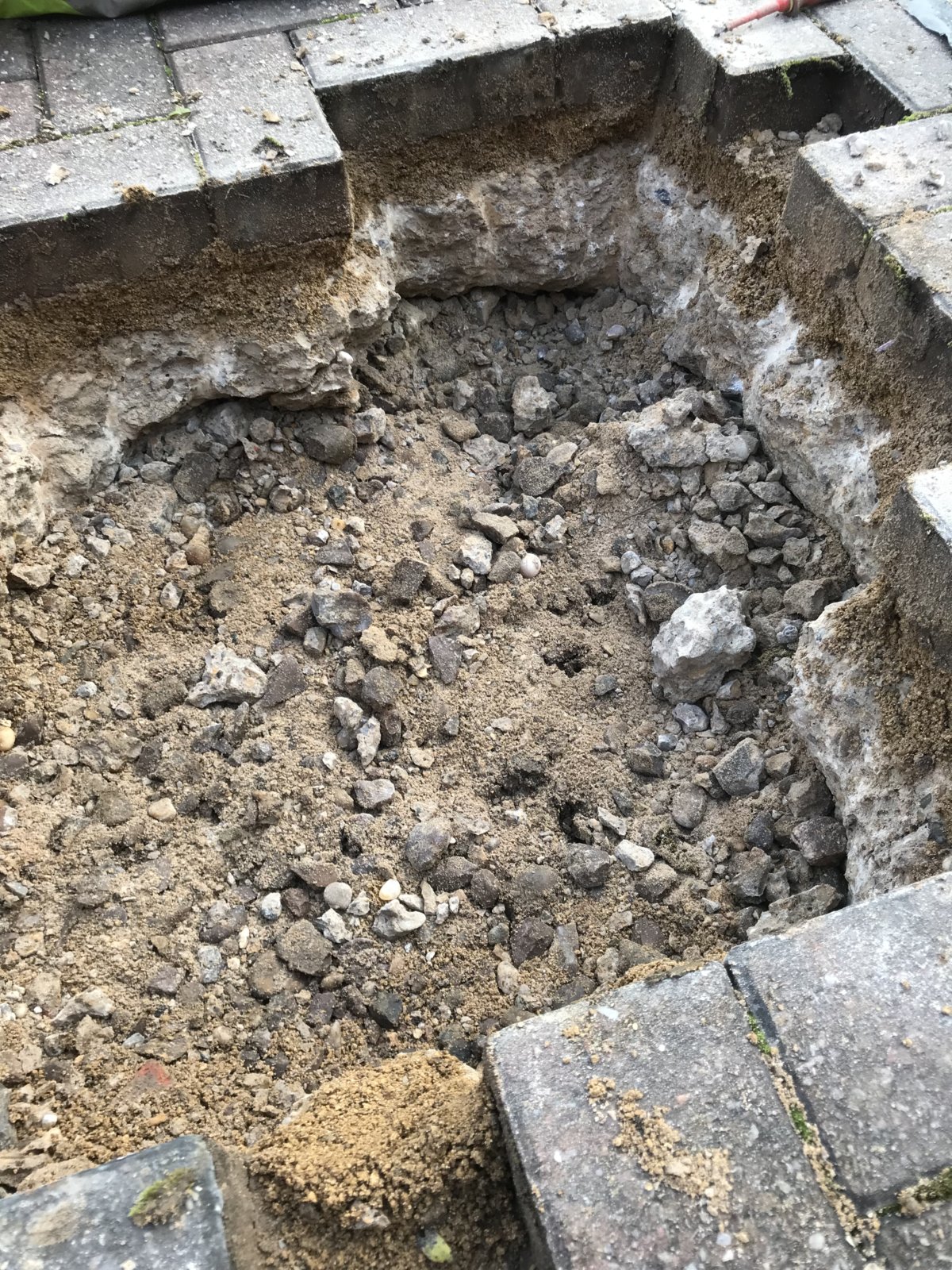

I’ve just done a job on a block paved driveway that was on 40mm of sand on top of concrete and it was fine:
