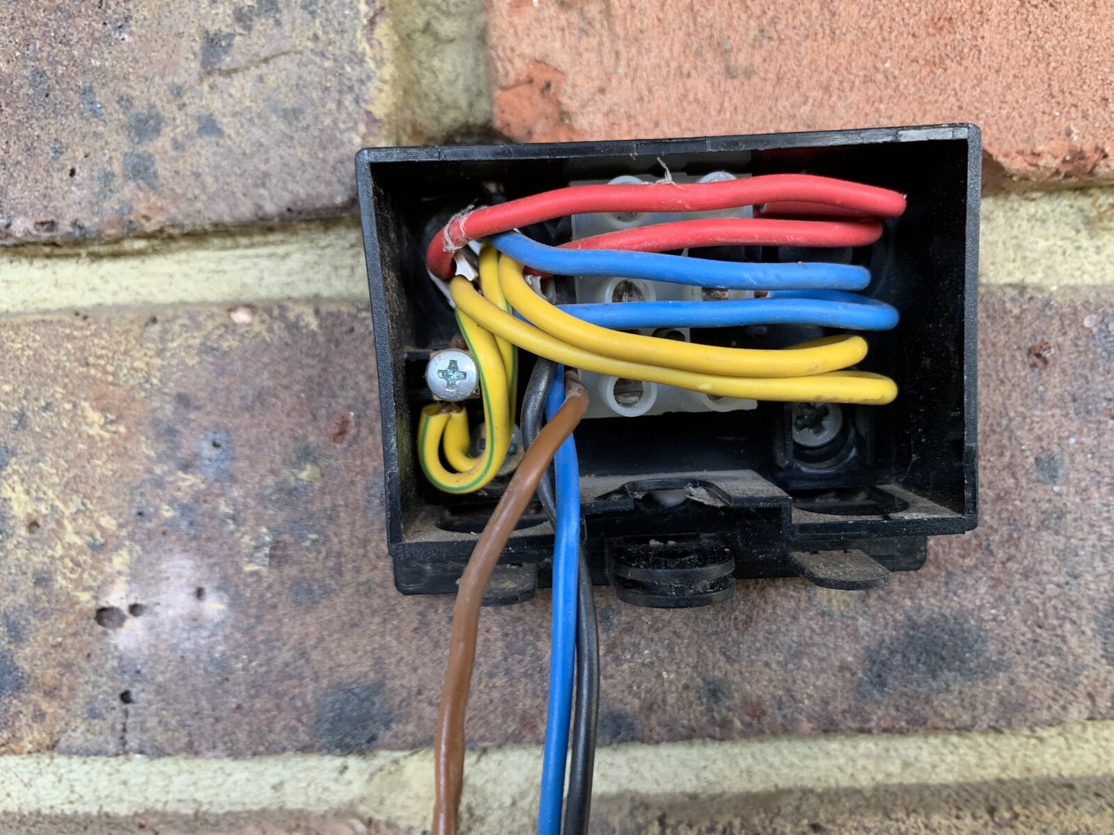

However, when I look at the wiring inside the old Steiner PIRs, it all looks in order. And the PIRs click at night if they detect movement, but they don’t switch the lights on. The wiring is old 3core and earth btw.
Any idea what the electrician has done to stop the PIRs working and what I need to change to get them working again?

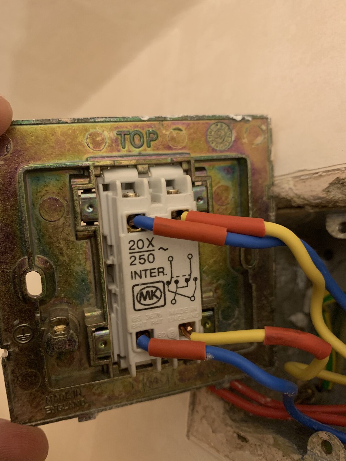

This is the intermediate switch that controls the lights - red wires connected together and blue and yellow into the switch.

have a look in the back of the last switch or first light, see if that helps

There is no colour code, so you would need to test to find out what is what, pictures are of very little help.
Thank for replies. I checked all switches and lamps and wiring was fine.
Just seen an extra PIR on other side of house which had the switch live wire (yellow) disconnected, so I reconnected and the lights are on.

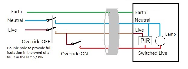

Some can have a switch in parallel others can't, and without instructions you don't know. I seem to have installed a succession of them, here most were solar powered, work for 6 months, then fail.

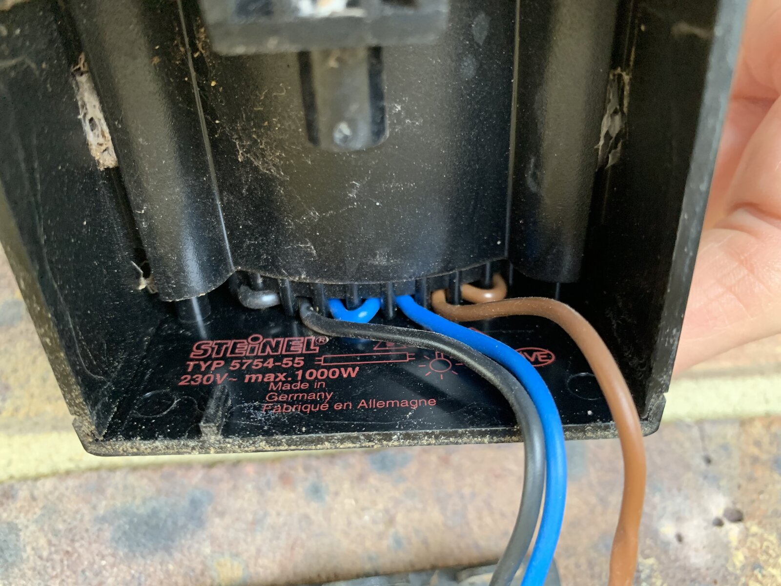

From memory I am sure that the Live in a Steinel PIR will be Brown, Neutral will be Blue and Switched Live from the PIR to the Lamp will be Red.
The wires in the Steinel are black, blue and brown.
I have old 3c & e coming from the house supply and then on to the lights.
Have connected Steinel brown with yellow 3 core, Steinel blue with blue 3 core and Steinel black with 3 core red as per the previous image.
Finally got it working - there are actually 6 x PIRs all around the house and they didn’t work before because some had the yellow wires disconnected.
The lights needed to stay on override switch for a few minutes and then when switched off they revert to PIR control. I will give it a few days and see if the PIRs are overly sensitive and turn the lights on needlessly. If they do I’ll decommission them again. Thanks for all your help.
