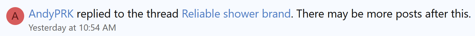

Well that's bizarre - I got an alert to say you'd replied:
and that was because I was subscribed by virtue of having posted in this thread, and your reply looks like it's an answer to the question I asked you.
But my post has gone ... :confused:

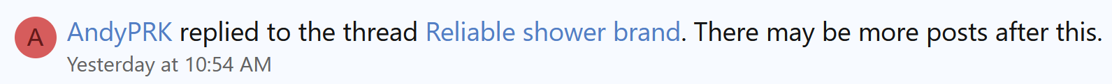

and that was because I was subscribed by virtue of having posted in this thread, and your reply looks like it's an answer to the question I asked you. But my post has gone ... :confused:
Indeed. Your post was there, and I 'liked' it, because it was asking the same question as I was about to ask Andy - but, as you say, that message of yours has now vanished. Goodness knows why!
