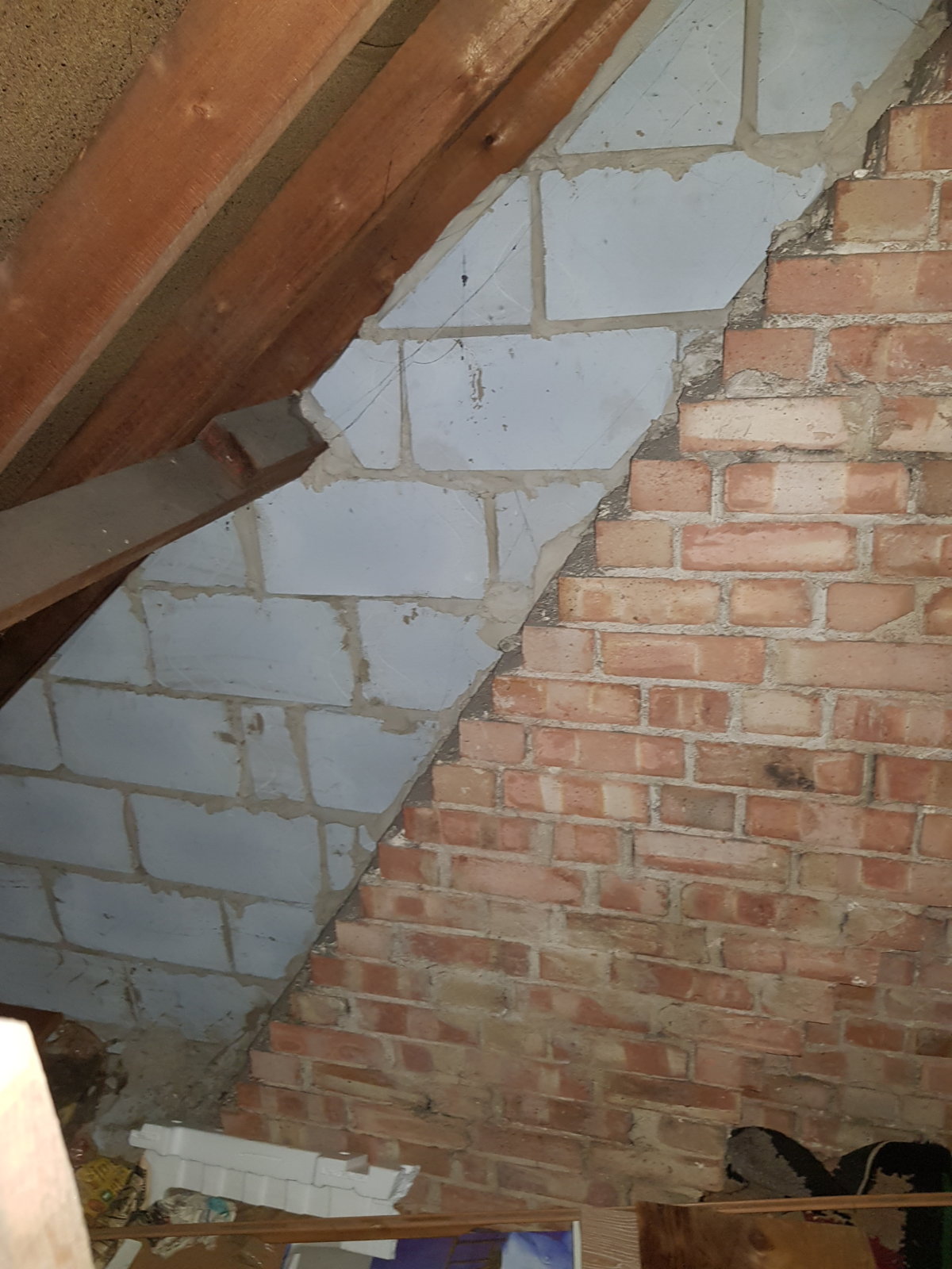

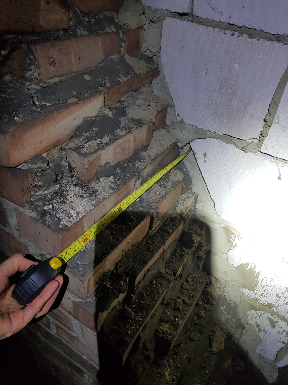

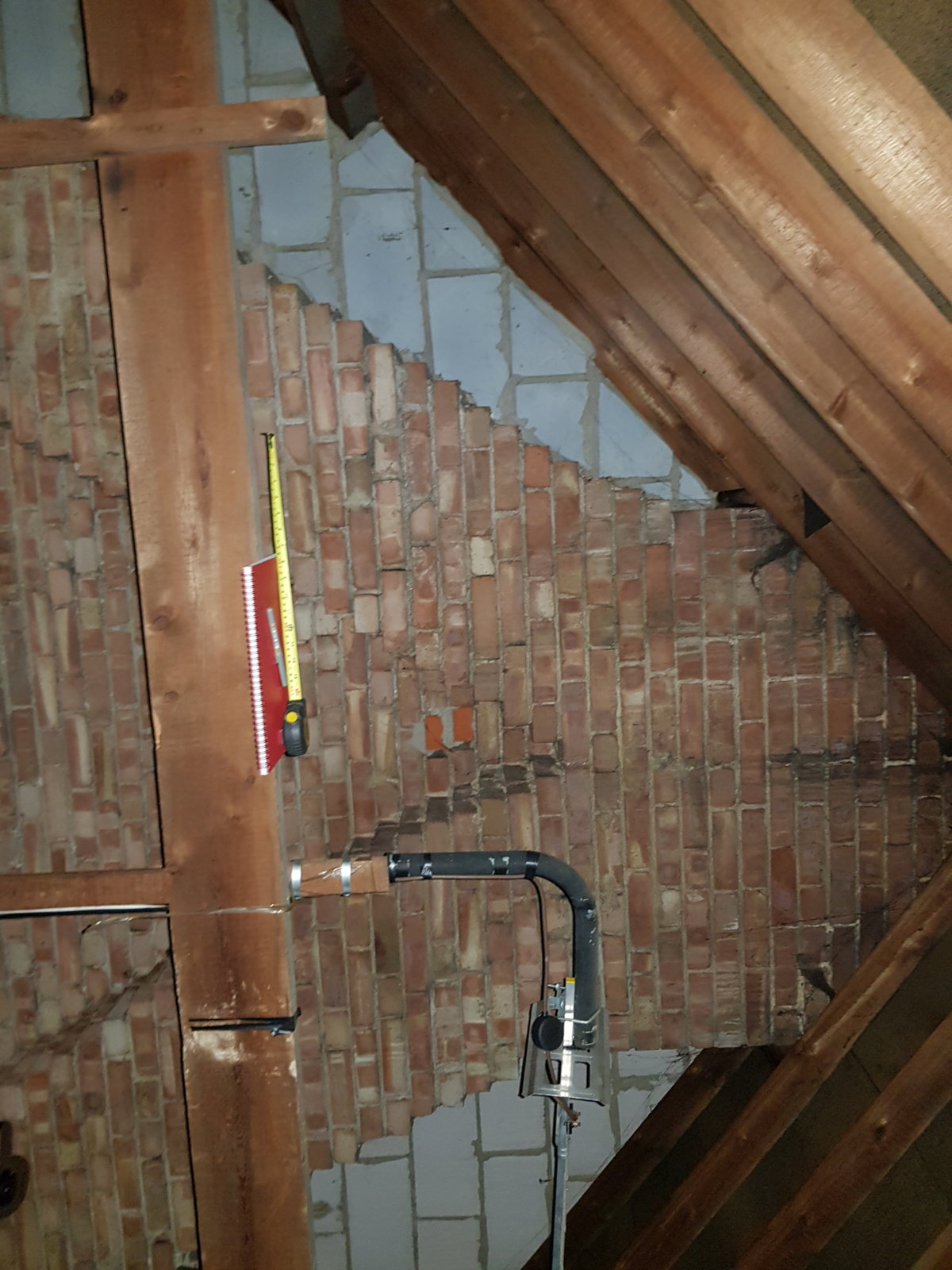

I'm going to remove chimney breast and leave the stuck outside the roof. My idea is to leave the stuck 1 meter below the roof.
The problem I found today when I made a survey is that the party wall has an extra layer of the blue block looking like a thermo block.
What is very strange is that the brick wall between the 2 breasts is 280mm and bricks are visible. on the left Breast, I can only see the blue block and the projection from that is already 300mm. On the right breast has a projection of 450mm from the blue block.
Building control has asked for drawings and advised to use standard details but I don't understand where is and if there is the brick wall behind the blocks.

That's one hell of a shared stack with non standard loading from the blockwork and neighbour's flues.
Party Wall Act wil apply and make sure it's an experienced structural engineer who knows about flues as well as structures.
I doubt gallows brackets will be acceptable for that.

I would guess that you have a Victorian semi/terraced house. What would have been an open loftspace across the two properties has had a block wall added on top of the party wall to separate the two properties. The blockwork is adding load onto the stack rather than providing any support. The stacks are disproportionately large and probably contain four flues in each stack (2 from your property and two from your neighbours).
You have no chance of using gallows brackets and you're going to need a party wall agreement and a good structural engineer.
