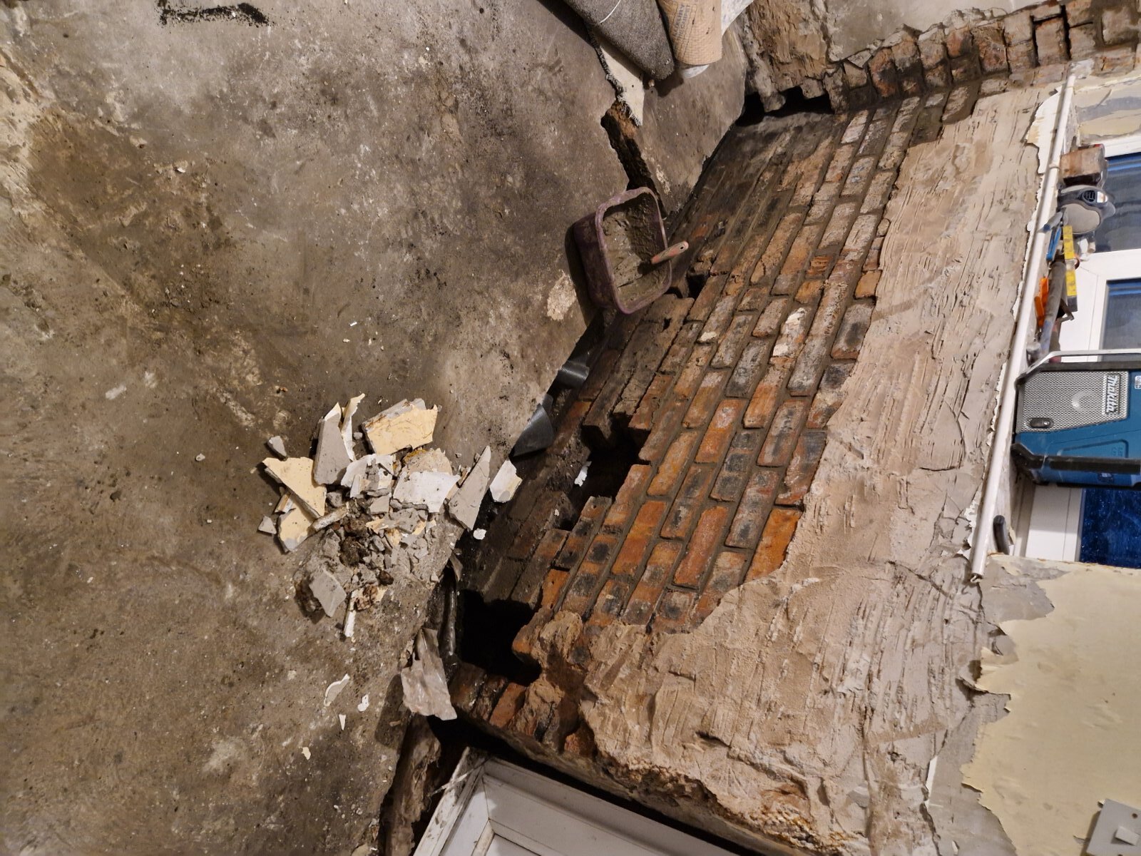

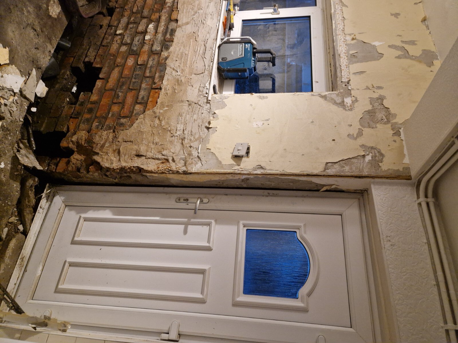

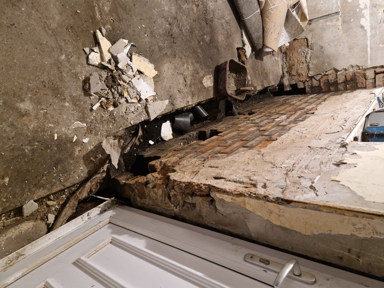

Hi guys attached few images so you can see where im working on , the end part of the wall where the door is used to be a return for the end of the house before a extension was added where they have broken the end of the wall off its all a mess and i want to rebuild but there is 3 lintels coming into this wall so would i need to add support for these ?
1 from the door 1 from the window and one from the new opening

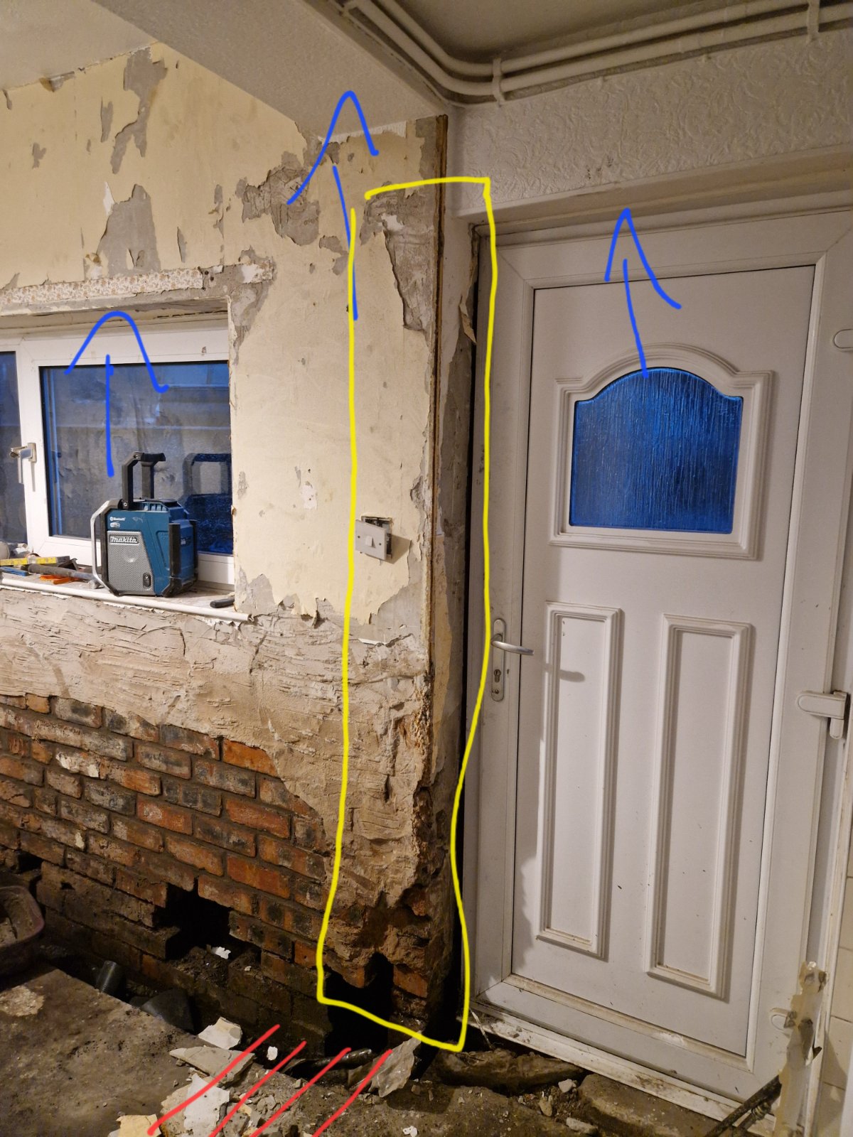

There will be some loading that low down, although increasing in risk as you remove more masonry and the more you climb above floor level. As a precaution, we would prop the beams and maybe include strongy prop just to prevent localised dropping.
Don't forget to include DPC in your repairs if you disturb the existing.
Thanks yeah , im fitting a new dpc along the whole of the inner skin i have this last section to do but ive uncovered how poor this corner is , like i say the house once returned here so this would of been the corner of the house and carried on where the red lines are , the builder ad the time has just smashed this off and its all well ruff and patched up with cement and missing bricks u want to rebuild the yellow marked section but would i need to prop where the blue markings are as i presume all weight will be on this corner
