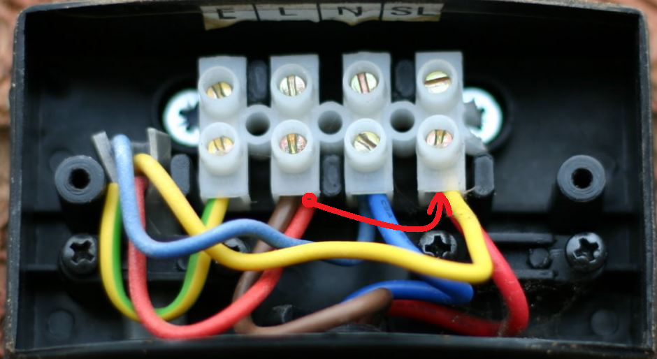

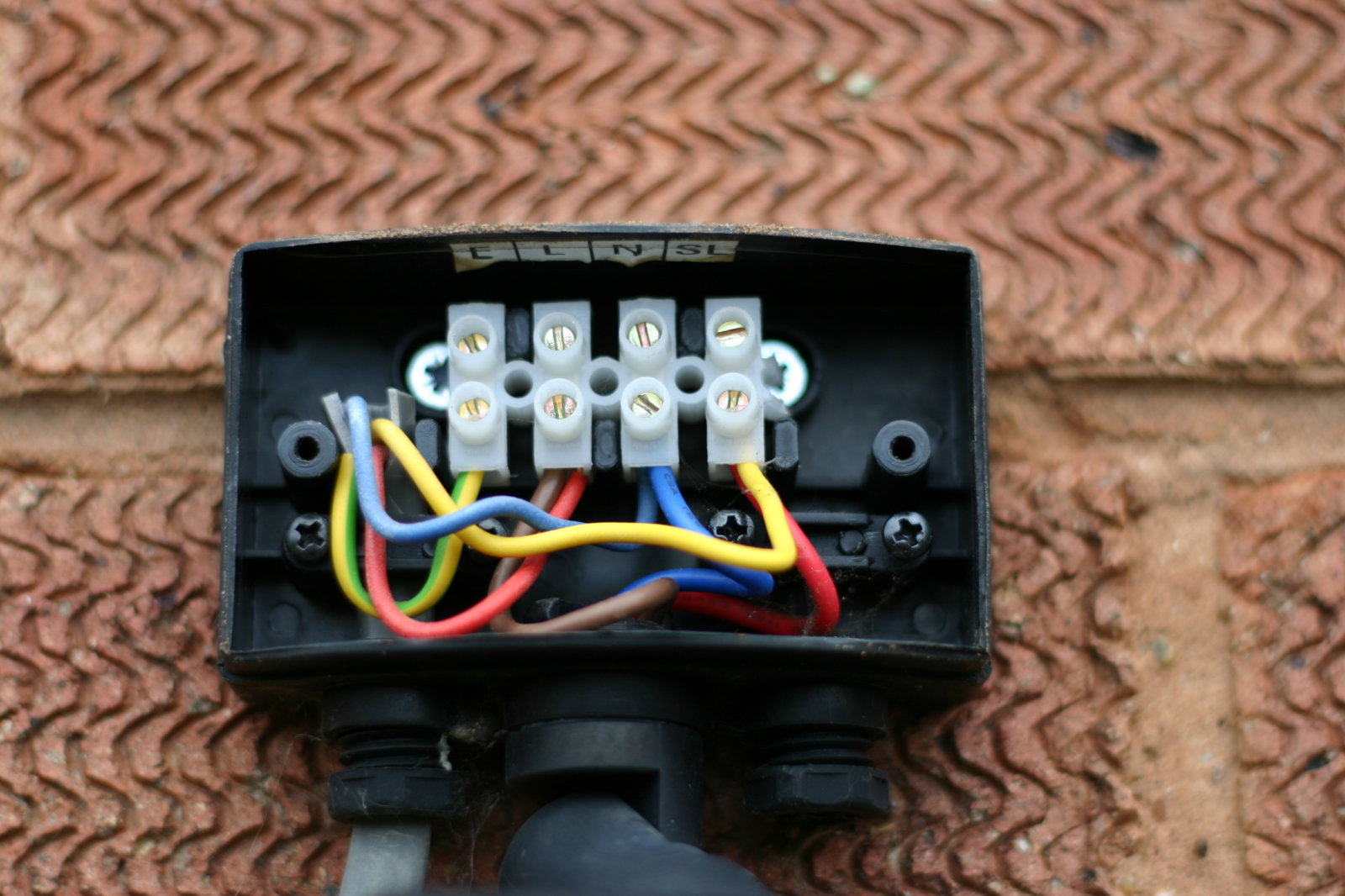

Here is the photo and based on the first two responses to my question, I think I know what I should do. As 333rocky and EFL explained.
The issue I have with the current PIR switch arrangement is that the bloody thing is so insensitive and has such a short on-time that by the time I have gone from the backdoor to the garage and back again, the light is off and I have to leap around to get the PIR to 'notice' me and turn back on again. So I could replace the PIR sensor or just get rid.
You could do this.
but, seeing how it is wired, if you want to, you could remove the PIR and cable from light altogether by altering the wiring at the light.
There are a couple of ways to wire the switch so if, after you have done this, the light stays on let us know.
They do have adjustments for time and sensitivity.
Are they both on minimum? Obviously it could just be faulty.
Thanks again for the advice. I have put a wire link from the 2nd to the 4th pair of terminals (using a short length of insulated wire taken from a mains flex). The switch now turns on/off the light and it stays on as long as the switch is on and only turns off via the switch. Exactly as I want! The sensor itself is 20 years old and pretty cruddy. I have fiddled with the adjustment screws but the maximum on-time is not long enough and the sensitivity setting is duff. I think I will just leave it at that. Someone could always replace the sensor in future if so desired.

No, not a link. Move the red wire from one terminal to the other.
Edit - it won't alter the function but it will remove the power from the PIR part.
Ok. Removed link. Moved red wire from 2nd to the 4th pair of terminals as you have advised. Thank you.
