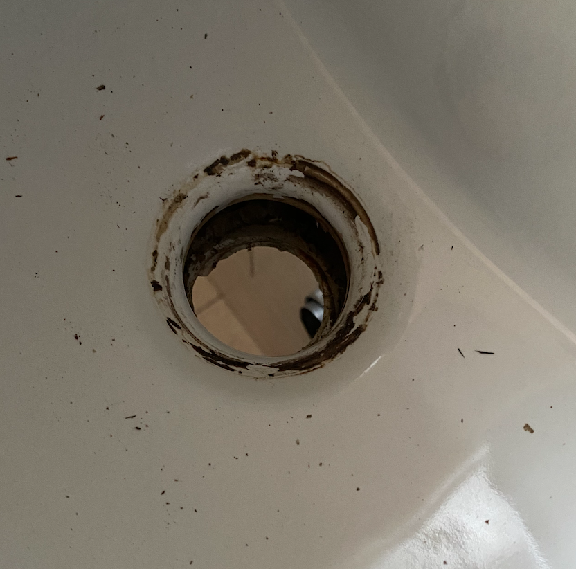

Hi, I am replacing the pop-up waste on a small basin in my toilet but parts of the old rubber seal are now stuck.
Is there a simple way of removing this from the basin without me damaging anything?

A small gouge chisel would help on curved sections. Or you could grind the end of an old screwdriver blade to make a DIY gouge/scraper.
9 Apr 2010
14,060
2,334
Hertfordshire
Ignore Harry, that would scratch the basin, just use a Stanley blade held at an angle. It will clean it up in no time.
Andy
20 Mar 2009
8,966
1,747
Potters Bar
As per Andy.
Stanley blade (not in the knife/holder)
Or I use the foil backed razor blades that go in window scrapers.

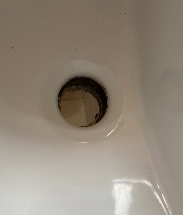

8 Aug 2006
43
Nottinghamshire
I took the advice of Madrab and used Meths but this did not remove the rubber marks.
However, the white spirit removed it instantly.
Thanks everyone it is now sorted.
