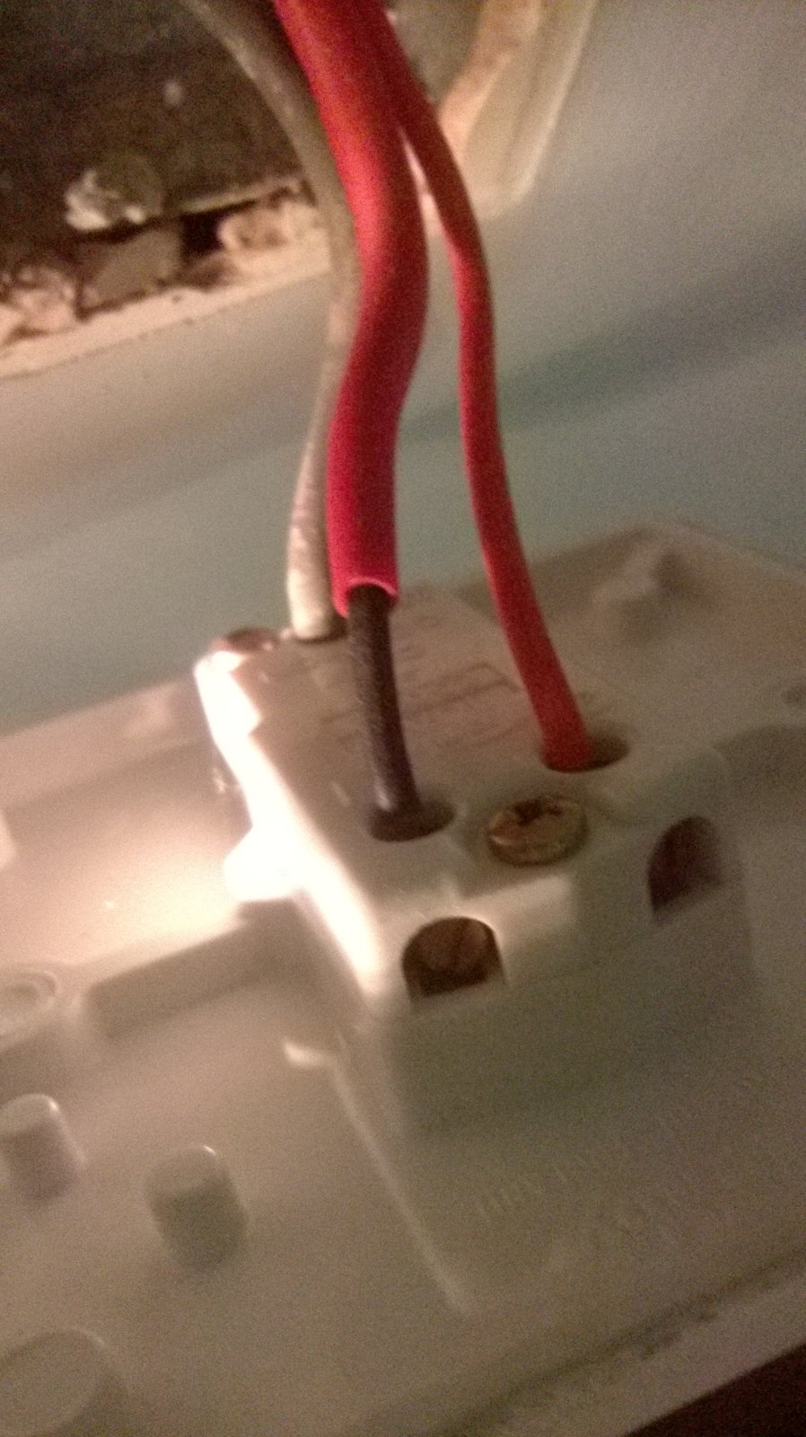

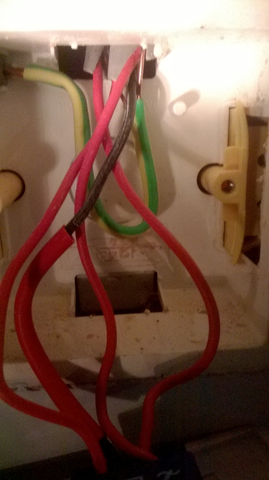

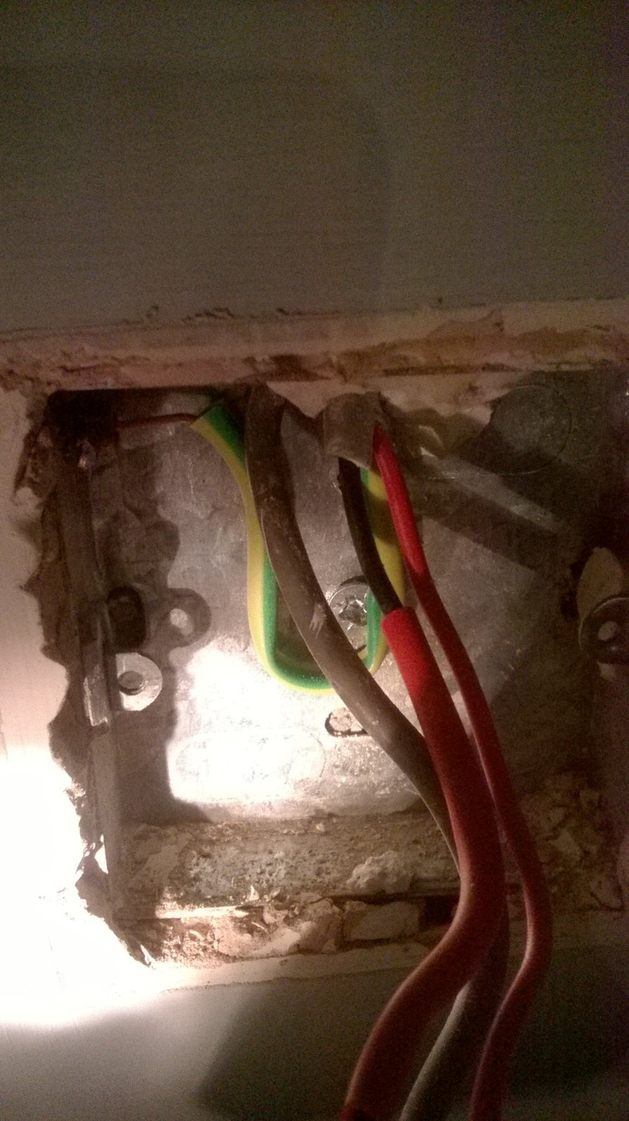

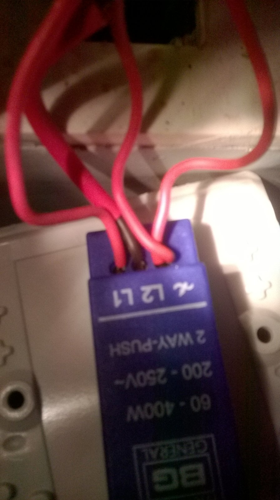

I've taken some pictures, apologies, the cable to the dimmer switch I want to keep is a single 4 core.
The cable at the switch I want to remove looks like a twin and earth and a separate single cable.
Dimmer Cable

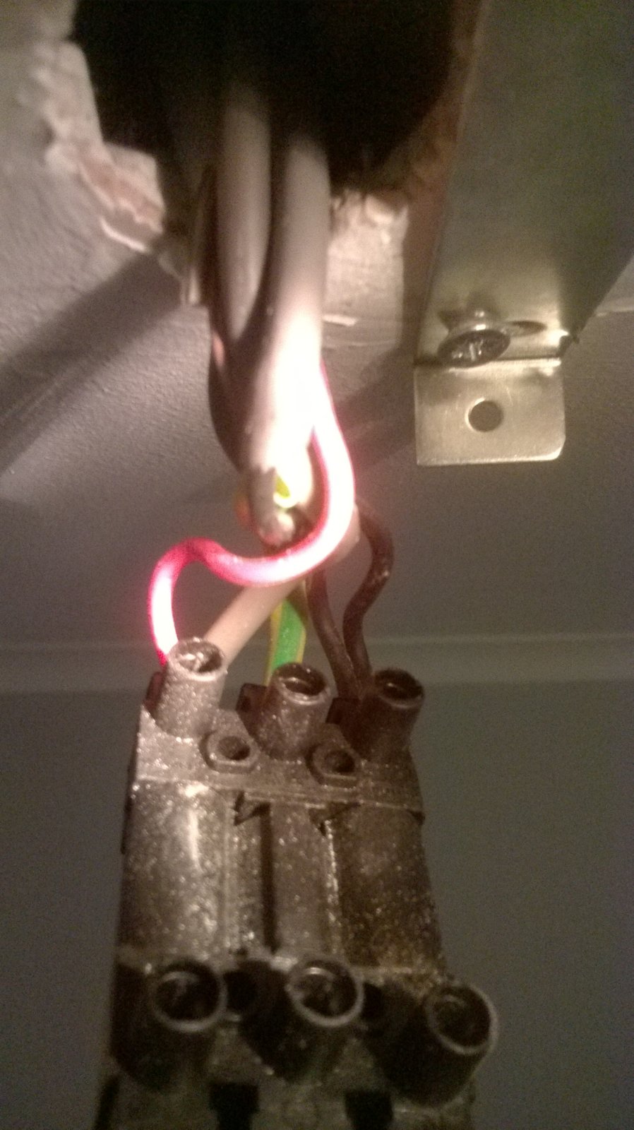

Redundant Switch I want to remove

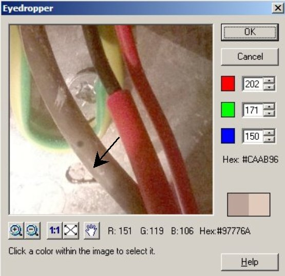

"Grey"? Really?

I'm seeing brown.
Indubitably.
Using Instant Eyedropper at no point do I pick up RGB values which are anywhere near close enough to each other to be any shade of grey.
I'm seeing brown. Indubitably. Using Instant Eyedropper at no point do I pick up RGB values which are anywhere near close enough to each other to be any shade of grey.
Interesting. The top ~40% in the version you posted does look a little 'brownish' on my screen, but it is in partial shadow and I therefore thought that was the reason. Whatever the RGB may be, I have to say that, for the bottom ~40% in that picture, I would not have dreamed of regarding it as anything other than grey!
So, whatever the explanation, the OP is certainly not alone in thinking it is grey!
It still looks very grey to my eyes (on my screen), but I agree that it's a bit short on blue - about the 'greyest' I can find is ...

From its dimensions (as compared to the visible Red and Black[Red-sheathed] insulated conductors) the colour of the third single conductor "cable" at the redundant switch in Picture 4 is that of its TPS, under which there will be insulation of another colour (possibly Red) covering the actual conductor.
Surely, this must be the single wire cable going to the light fitting.
Which is the colour of some TPS.
It's grey.
No doubt about it.
I think the confusion stems from the original post that stated that switch contained one cable.
Grey of course is the colour of the sheath of that cable, as already commented on.
I too would guess that grey goes to the light.
I would guess that at the OTHER SWITCH, which you want to keep, the two reds in one terminal are the main live feed.
This makes removing that switch extremely difficult.
If you were to simply form a joint here, you then have the problem of wires then being plastered over, and invisible for anyone drilling holes in the wall in the future.
It's likely these cables will not form a 'safe cable zone'.
A blank plate, possibly painted, won't look great, but be ok for you.
Otherwise you will have to gain access above the ceiling above that switch, and fit a junction box.
