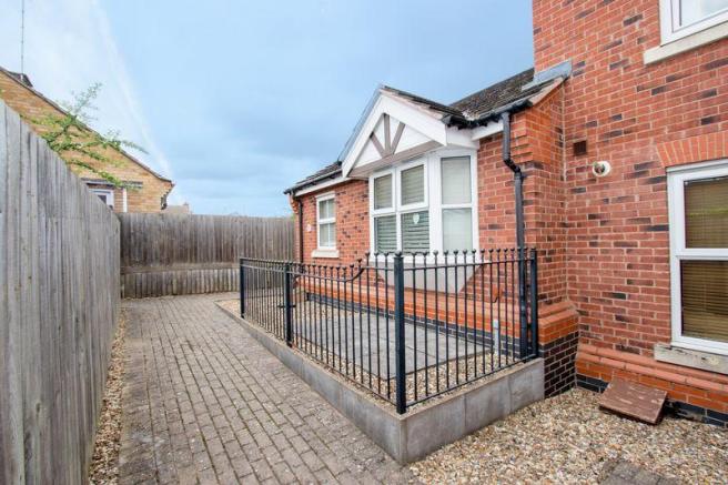

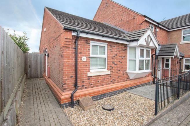

Hello. I am looking for some advice as to whether removing this bay window and replacing with a normal one would be a huge job (for professionals)? I would want to remove weird cladding around it and make the roof just in line with the rest of the roof. Any thoughts or advice welcome. Many thanks.

Not a huge job no, as long as there is face brickwork beneath that insulated sill bulkhead. The soffit can be replaced with a minimal amount of cradling, plastic fascia /soffit board and trims.
The roof could be made good so that the valleys are removed and then reinstated on the existing line.
That’s excellent news, thank you. If it is non-supporting etc, do you think I’d need any sort of planning or other permission to remove the widow, replace with a flat one and join up the roof line? (Apologies if it’s an ambiguous - how long piece of string question)
You may need an application to BC or at least a phone call. It will depend on what is going on with the roof and the new window etc. Looks to me like the window may qualify for safety glass.
Not sure about planning but my gut says no.

Just to add: Whom ever does the job will likely need to do a bit of legwork prior to the job starting, i.e. remove the detailing around the bay window, get a stone sill made and have the window made ready to go in. Probably mean money up front etc.

if you intend to take the Oriel cant bay back to flush with the outside wall surface then you may as well remove the roof down to the extn roof plane and do away with the intersecting pediment roof entirely.
ie. totally remove the bay and its roof and make good to the extn roof.
that way you eliminate valleys and any weird lookingness.
its just a job, no big deal.
given you are downslope on a hillside with a retaining wall then you might have a bit of damp where the extn returns into the main house.
i can see why they built the raised standing but maybe it wasn't the best solution.
