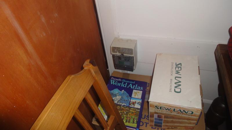

Hi, looking for some general info. The house I’m thinking about buying used to be subdivided into bedsits at some point in the past so many of the rooms have separate electric consumer units one for each of the old bedsit/bedrooms – see first pic below.
In order to return the house to a single dwelling I want to remove these, there is nothing to suggest the wiring in the house is sub-standard so I just want to remove these with as little cost/disruption as possible – can anyone advise on what the options are so I know what to ask for when I speak to an electrician.
Any guidance on cost/complexity of the work would be appreciated - good to know these things before making an offer for the house and its not easy to arrange for someone to go into a house you dont own yet to give you an estimate for work.

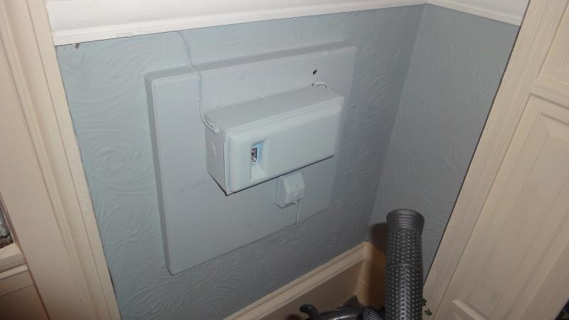

Also, the main fuse box is an older style unit, I’d want to update this to the new style also – see second image.

It will all depend on lots of things that can only be determined by a site inspection.
To go back to a single fuseboard you will obviously need one of these (unless you have a largish one adjacent to the incoming mains supply).
Also the socket and light circuits in each separate "flat" would need to be combined into properly organised circuits and connected back to the new main consumer unit.
How this is done will depend.
It may only be possible by rewiring the place.
As for the cost. Just allow about the same as a family holiday.
Could be a weekend at Butlins, could be a round the World cruise.
There is one massive item - it was bedsits. That means 99% certainty everything in the place has been bodged up by individuals who not only didn't have a clue what they were doing, they also wanted to do it in the cheapest possible way. And that's before the tenants started making unauthorised modifications.
You should budget for a total rewire.
Under all that grey paint is metalclad Memera KSM series fusebox, which was a popular item in the 1950s. Yes - over half a century ago.
Not only does it need replacing, it should have already been replaced several decades ago.
If it contains ceramic rewireable fuses, note that they have asbestos pads in them.
That weedy little wire from the top left of the box is probably the main earth for the entire installation.
Does this entry from a 1956 catalogue look familiar?

Everything has been checked over per TheGayOwl's suggestion and the eletrician reports all the work is up to code and the work has been "done well" - vendors are offering to repalce the outdated main unit at their cost.
So, only question remains are what are my options for removing the smaller units in each of the bedrooms at a later date, can they just be removed and the wiring behind connected up tobe fused via the main board or is there a slimline unit i can replace them with so its easier to place furnitute etc. in the room - just now they take up too much space.

I'm not clear on how the individual fuesboards get their power from the main incomer.
A photo of the main incomer would be helpful.
How is each flat metered?
Where are the meter(s)?
The usual arrangement is for there to be a largeish fuse for each flat and this is downstairs. A separate meters are there to record each flat's consumption.
Then a thick cable takes the power up to the fuseboard in each flat.
The flat's fuseboard has then smaller individual fuses for sockets, lights, etc.
If you want to make it all one system then the socket circuits in each flat would need to be connected up together and the circuit extended down to the main fuseboard.
You would have to do this for each group of circuits (sockets, lights, etc etc)
You would need to ditch the old fuseboards, whatever you do as they will not be up to today's standards.
Also, make sure that the consumer unit that the vendors have agreed to pay for will meet your requirements for the future.
Don't leave the old fuseboards there, or replace them. They'll just be in the way and an eyesore. Now is the time to get it the way you want it, don't cut corners, you'll regret it later.
