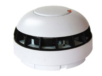

Removing Rafiki Twinflex Multipoint Detector
There's a special tool... :rolleyes:
You'll want steps so that you can look through the black slits. There's a little catch on the upper side that you have to push in with a small screwdriver which will allow you to twist the black slits a little anti-clockwise and pull down. Then there's more gubbins inside to remove...

Just to clarify, this is my own house. I found the Twinflex alarm system installed when I moved in. It doesn't work, and I'll either get rid of it or get it fixed at a later date. But regardless, I'm re-decorating one of the rooms and I need to remove it temporarily to fix the damaged plaster on the ceiling, and the cabling to it is inside some ugly surface mounted trunking.
I bought the head removal tool and removed the outer plastic cover, but I can't see any fixing screws inside the unit. http://www.directtradesupplies.co.uk/media/catalog/product/m/u/multipoint_head_removal_tool.jpg

Look at page 22 (28th page). Another special tool and a plug-in module. The base will be screwed from below... It's probably a good idea to power the control panel down and disconnect the batteries inside before you start ripping things out.
