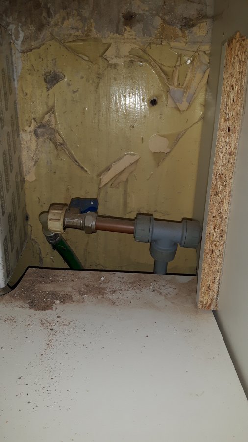

Hi.
I'm looking to remove a t-piece that is used to feed water to a fridge freezer.
Here is the pipe work.
Going left is he the outside tap. Going down is the fridge freezer. Left is into main circuit.
So I need to disconnect the fridge freezer part but connect the outside tap still.
You could use this as a chance to plumb in your garden tap properly instead of that cheapo DIY kit.
You need to remove that valve and hose pipe, add in an ISO valve, double check valve, then a drain then a piece of copper through the wall and join that to a wall plate elbow and then add a bib tap into that. Easy Peasy ;)
