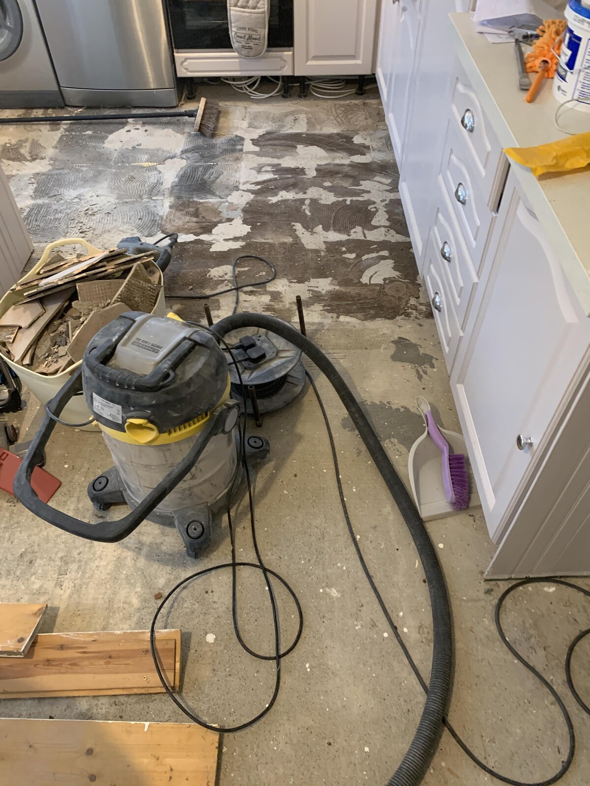

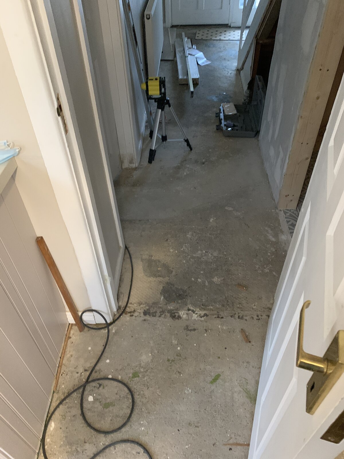

Hi all.
I am putting down 12mm floating laminate floor right throughout downstairs with the hope to flow the laminate through doorways without a transition strip for a really slick look at the end (same level subfloor important).

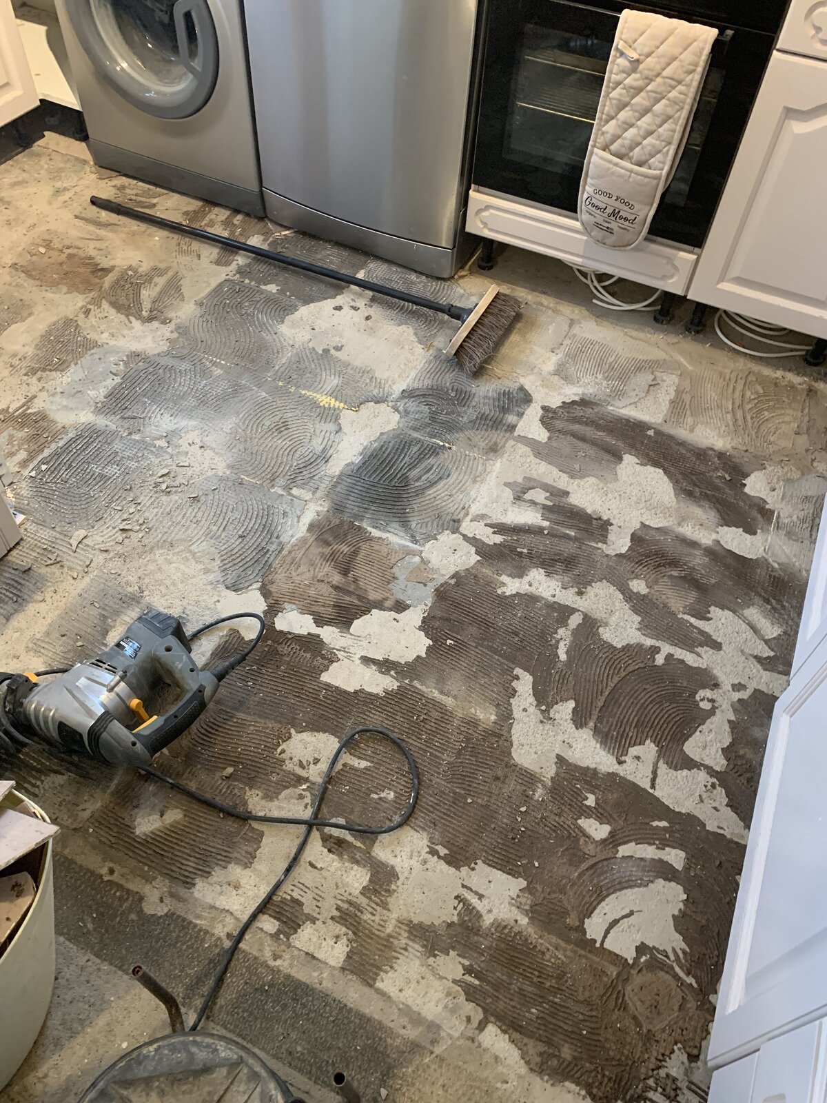

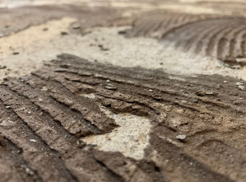

It is a concrete subfloor. Most of the floor is really nice and level but there is a section of tiling I just pulled up that has naturally left tile adhesive behind on the subfloor, see pictures.
Is there an easy way or trick to getting tile adhesive up off the subfloor? I know many would probably lean towards self levelling compound but Id rather not raise the level of the floor in that area as I would either need to have a transition level change somewhere or pour SLC everywhere....neither of which i particularly want.

I'm literally doing the same myself. I purchased a cheap SDS rotary hammer drill and a specific tile lifting chisel from a well known retailer. With a bit of perseverance it removes the old adhesive very well.
Be prepared for a lot of dust! I butchered an old flexi tub by cutting an opening on one edge and put a hole in the top for the henry vac hose to attach into, turn it upside down and jobs a good 'un. Seems to reduce the dust quite a lot and keeps the area tidy ish!
