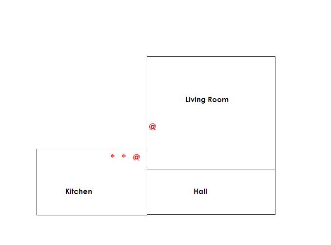

We removed the kitchen wall cupboards the other day, which had three under the cupboard type lights. We WILL be replacing with new lights, so these don't need covering or removing. However, what I noticed was that whilst two of them had single wire feeds, the one nearest the living room had a two wire feed. It got me to wondering whether this might have something to do with the feed we need to get rid of in the living room.
Here's a diagram showing the room layout and details. The two red * in the kitchen are the single wire feeds. The red @ i the kitchen is the double feed, and the red @ in the living room is the wall light we want to get rid of.
What I wondered was whether there is a way to find out whether this double feed in the kitchen is connected to the wiring in the living room light we no longer want.......but without removing carpets and floorboards upstairs?
