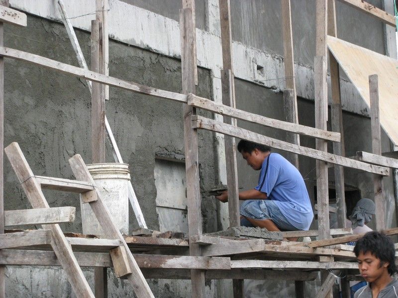

I can't do this, never tried myself, but the guys who are doing our house render the whole concrete block building with an inch or so of cement. They throw on a base layer with a trowel, leave it to dry for a while, then build it up and smooth it using a various tools and aluminium battens.
Their base height is set using nails and string lines.
For columns and beams, corners etc, they run a string line again.
It comes out as smooth and level as a pool table. :D
And they have never heard of PVA. (or health and safety, apparently)

That's not a crack, but the top edge of the rendering, and the flash of the camera made it stand out. The lazy buggers didn't take it all the way to the roof, doubtless because it will be covered by the dropped ceiling....
