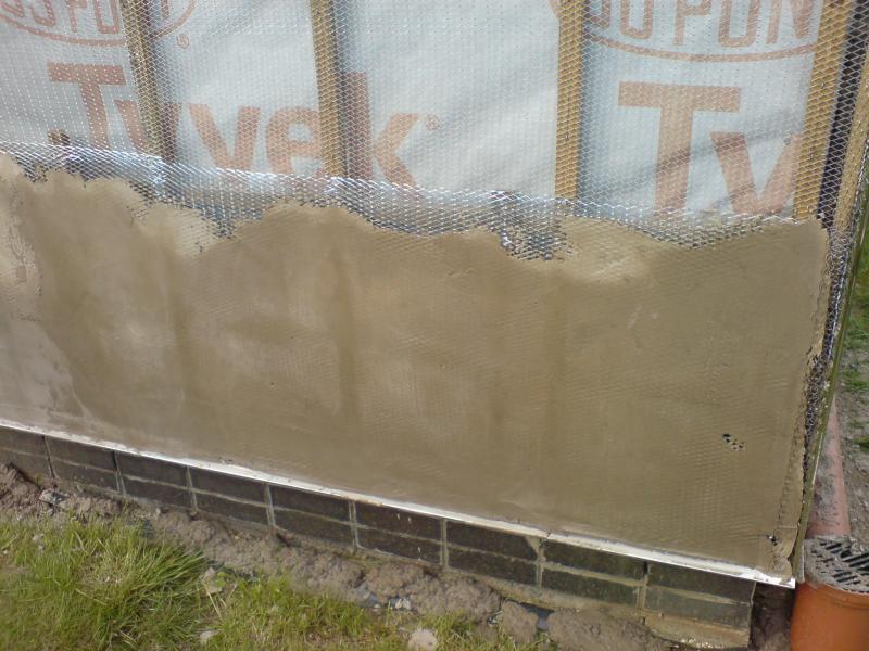

I have already consulted NHBC regarding the mesh. I am a structural engineer and I have designed this building myself. It's in a sheltered, inland location, with one wall that faces southwest. Had I not designed a cantilevered roof to protect most of this elevation, I would consider using SS mesh on this one elevation only, but since I've taken that into account I see no need (and neither do the people qualified to check what I'm doing) to specify SS mesh. As far as I'm concerned thats the end of the galv/stainless debate - Ok? :lol:
I passed on your concern that the 2nd coat wouldnt key to the 1st coat. He said he would use pva unibond on the base coat to bond 2nd layer in, plus a few scratches here and there.
Is this a viable solution? Or is he still covering for not being able to do the 1st coat properly??

You must not use PVA outside - it is not the stuff to use rendering. This guy uses it inside, does not know outside work. He should not have left his first coat like that, probably would have gone straight over it if you had not mentioned it. (Anyway iF it is the solution , why use a few scratches here and there?)
Without going over old ground too much, that guy does not know what he is doing . What has he done right so far??
He didn't quote right, did not know how to deal with eml, did not apply render right, filled cavity, CAN'T apply it right, did not allow a key for the next coat, suggests a solution (which is only needed because of his inability to do it right first time) that is wrong, wants two layers eml etc.
You said above you can't keep going back to him with internet advice - likewise if you decide on using him, then let him do it, but don't keep expecting to go step by step thru what he does.
Straight talking - We are back to cost /benefit - get someone who has done it before, ask to see the work and talk to clients . Don't pay this guy a penny - he cannot fulfil his contract.

Instead of PVA, use SBR mixed in with OPC:sand (1:1:1) for slurry, it is waterproof, will flex better and is designed for use with cement. You don't want to be just painting with PVA or SBR and then slapping a coat on render on.
The PVA you linked is 'Waterproof PVA,' as opposed to ' PVA ' that your man mentioned . Note it says in the spec for " intermittently wet internal and external service conditions" would a week of rain be classed as 'intemittent' , never mind what we had over the past year!!!?
It "should not be used in permanently wet conditions" - again, whether this is something you'd want on an outside wall during our winters (or summers :D ) is up to you. I'd go with SBR.
SBR can be used in tanking situations ( btw used in Home OFfice Spec for high security cells ) so that is the stuff for outside.
Remember , we would not be having this discussion if your man keyed his render properly! The fact that he mentioned PVA and not SBR is a signal to me.

Nobody likes to criticise other peoples work,, but i refer back to what Micilin said about "the man not knowing what he's doing."
In this one photo,, "little things" give the game away:
In this case: 4 examples,,,,
1) The bellcast beading: most plasterers would mitre that 90% corner.
2) The drain as Mic said, left uncovered.
3) The amount he's dropped on the ground for the small area covered is ridiculous. Always hold the hawk underneath as you coat, and don't leave it "too long" before scratching,,,, and on mesh,,, scratch "very carefuly".
But for me,, this is the main one,
4) I was alway taught to start coating at the top of the wall, and work down the wall,,, whether onto brick/block or mesh. That way you are working/coating "up and into" what you are putting on. It's far easier doing it that way too, because you are working away from what you have put on. Starting at the bottom and working up the way, could cause the coat to become heavy and slump, because of the downward weight of the render.
good idea RC i diddnt even think about doing something like picking problems in one pic to show how wrong the current plasterer is, and ***** please please please listen to the advice you have bin given yes you are a structual engineer but have you never herd the saying jack of all master of none, i know plenty of structual engineers but they always rely on the skill and knowledge of thier tradesmen to assuere thier names are tied to a top quality job.

Permanently wet is underwater, as in a swimming pool. Intermittently wet is correct for an external wall. I'll make sure its the correct stuff he uses, if we continue to use him.
Im pretty sure he only started at the bottom because he wasnt sure he could continue, so it would be easier to dismantle it if it was at ground level. Then again I could be giving him the benefit of the doubt that he doesnt deserve here :?
Yeah, but if you have the choice, go for the stuff that will handle permanent. When will the 'intermittent' fail, after being wet for 2 weeks ,2 months, three?
Ask him , without leading him on, what kind of PVA he was going to use and how he was going to apply it. If he was just going to brush it on, an then render, and/or use ordinary PVA - , you don't need to come back here and tell us , just do yourself a favour.
Im pretty sure he only started at the bottom because he wasnt sure he could continue, so it would be easier to dismantle it if it was at ground level. No further questions, your honour 8)
