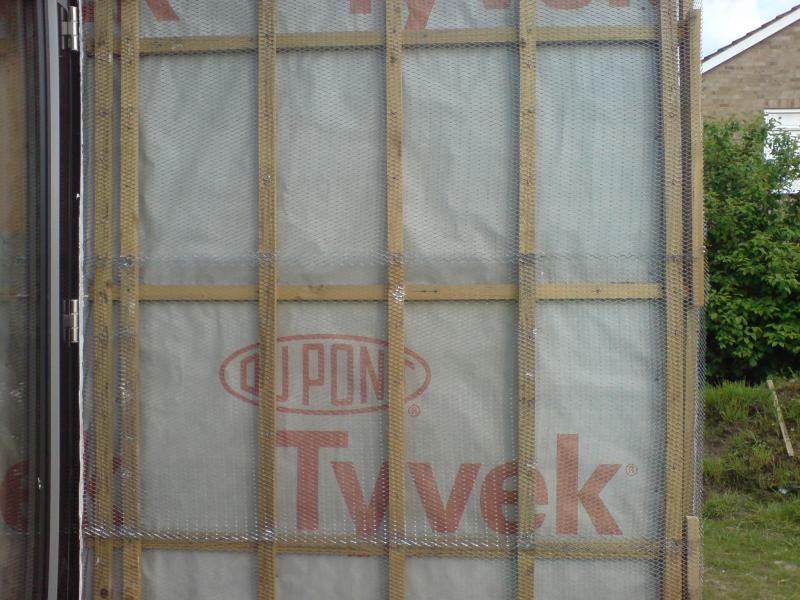

Here's a few photos:
Wall construction - there is a 50mm cavity between the face of the Tyvek and the mesh, formed by horizontal battens at 600mm centres (which are screwed to the main studs) and vertical battens at ~300mm centres which are screwed to the horizontal battens. The mesh is stapled to the battens at about 5" or 6" centres:
To counter the fact that a) you all seem to be saying we havent overlapped the mesh enough and b) we forgot the dpm strips to isolate the battens, and some of you think we should have used stainless mesh, I think putting on a second layer of mesh is probably advisable anyway. It's only going to cost another £300 and wont take all that long for me and my girlfriend to put up.

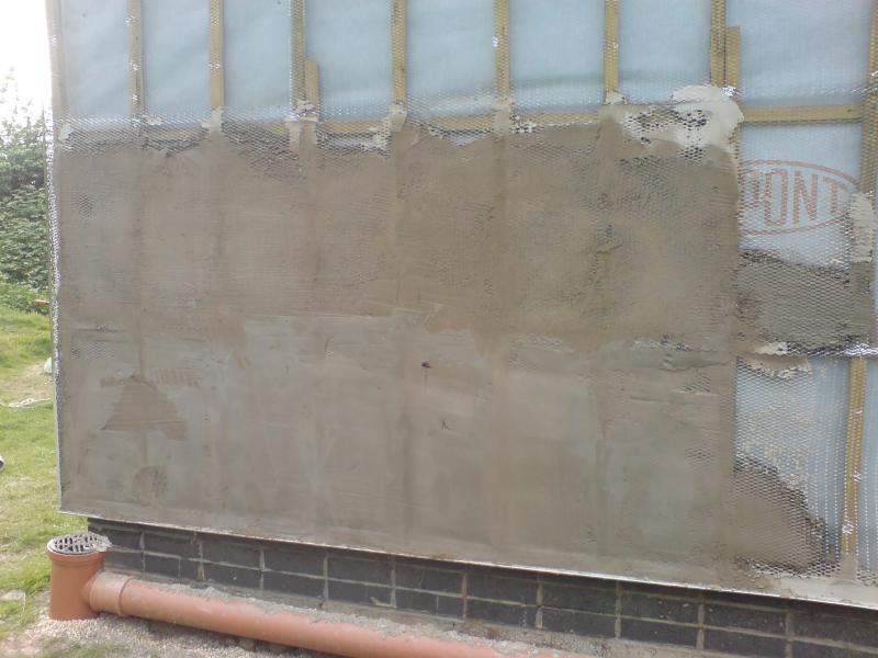

This is the bit he managed to do, filled all the way back to the Tyvek with render:

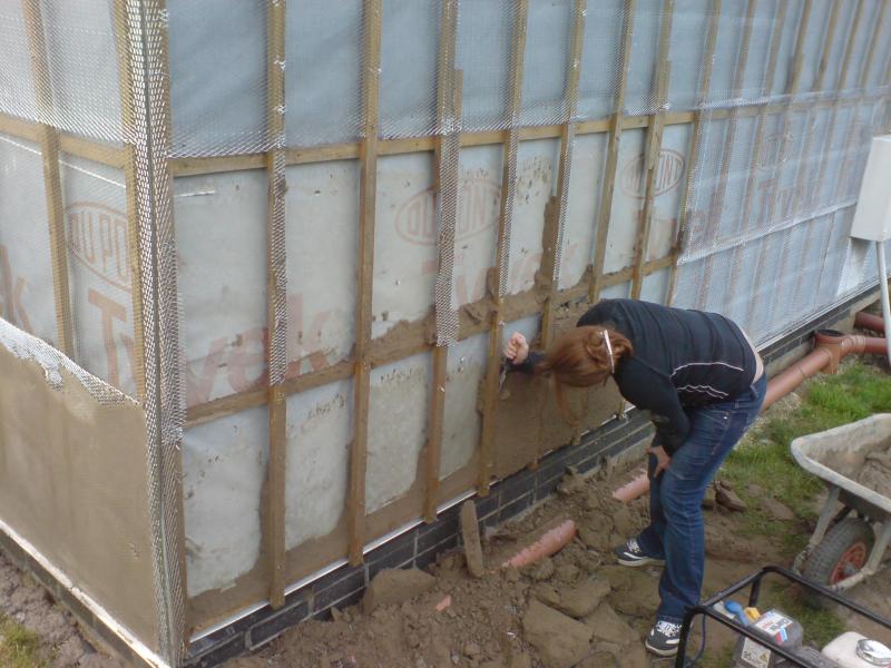

So we broke all that out before it set:
And this is the bit he did on a double layer of mesh, which seemed to work far more effectively. You cant see it in this picture obviously, but there is a clear cavity maintained behind the battens, which is what we need for the house to work properly:
I didnt realise that his original quote for a scratch coat and a top coat was not valid for this form of construction, had I known that maybe this wouldnt have happened, but a quote of £3850 instead of £2850 is still cheaper than the one we had for a polymer throughcoloured render (£4500), and is still ok in terms of price per square metre really.
He gave me a rough estimate of 2 people + a labourer for three days of £800, plus materials about £200 = £1000 to do the base coat on a double layer of mesh, then he would proceed with the quote as before, ie two further coats on top of the base coat.
