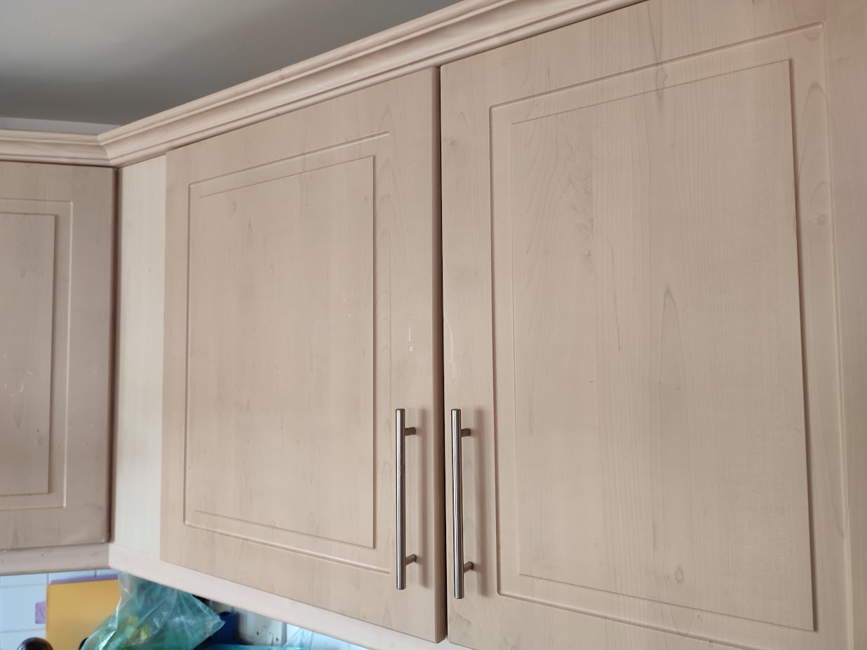

I'm looking for recommendations on primers for painting over tired kitchen cabinet doors that are made of cheapy 'plastic laminate over MDF'
They are basically sound, it is just that the colour is dated and I don't want to spring for new doors.
Hopefully someone can point me in the direction of a primer that really works for these and some topcoats that work well in a kitchen.

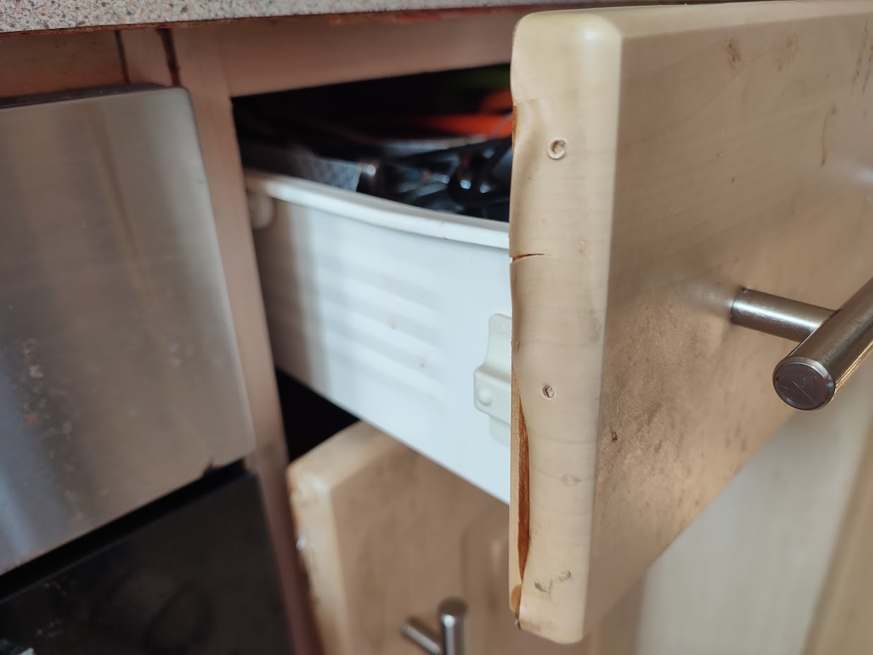

Also, a couple of them are delaminating at the edges, any idea of how to tidy them up?

I've looked at the wrap, but presumably the non-flat (what do you call those things?) front seems to make them unsuitable for a wrapping.
Can you peel them? I worry that I'd struggle to get them off - I bet that given their age, they'll be too brittle to pull off and I'd spend hours with a razorblade and cursewords.
The problem with getting replacements is that although some of them are standard sizes, some of them appear to be non-standard - at least looking at the usual places.
I'm not overly keen on paint, but I'm struggling to find an option that isn't getting new doors/drawers custom made

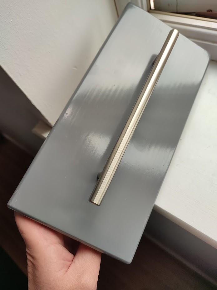

3 - I took the doors down, soap and water to remove dirt/grease. Sugar soap to prep.
4 - This stuff works very well. Great coverage, goes on really easy.
The big downside is that it is brutally unforgiving. You have to be on top of your brush game and get each stroke right the first time.
It does not naturally level off, so use brushstrokes that are sympathetic to the imagined wood grain.
5- Claimed to be touch dry in 3 hours and fully cured in 3 days. That's optimistic to say the least. At least 24hours before it's completely dry and I
I'm keeping doors wedged open for a few days
6 - if you are good with a brush, the results can be very good:
They do recommend a roller, but I just can't believe it will do anything other than make the surface like a rough army blanket. The paint is just too thick for it to smooth itself out.
I could try thinning it with white spirits, but I worry that would negatively affect its adhesion to the melamine - which is tricky at the best of times.
If it lasts a few years, then it's done the job that I want. Worst case, I sand it down and repaint it - I can live with that.
