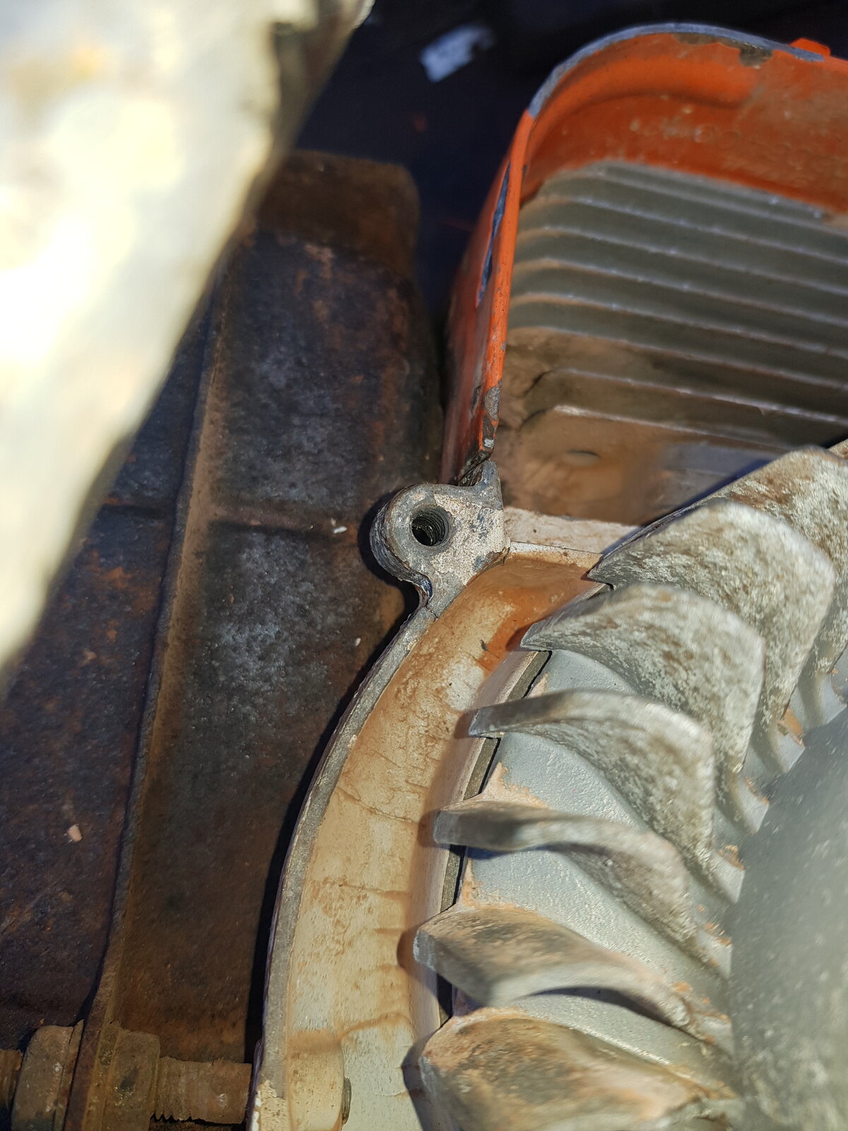

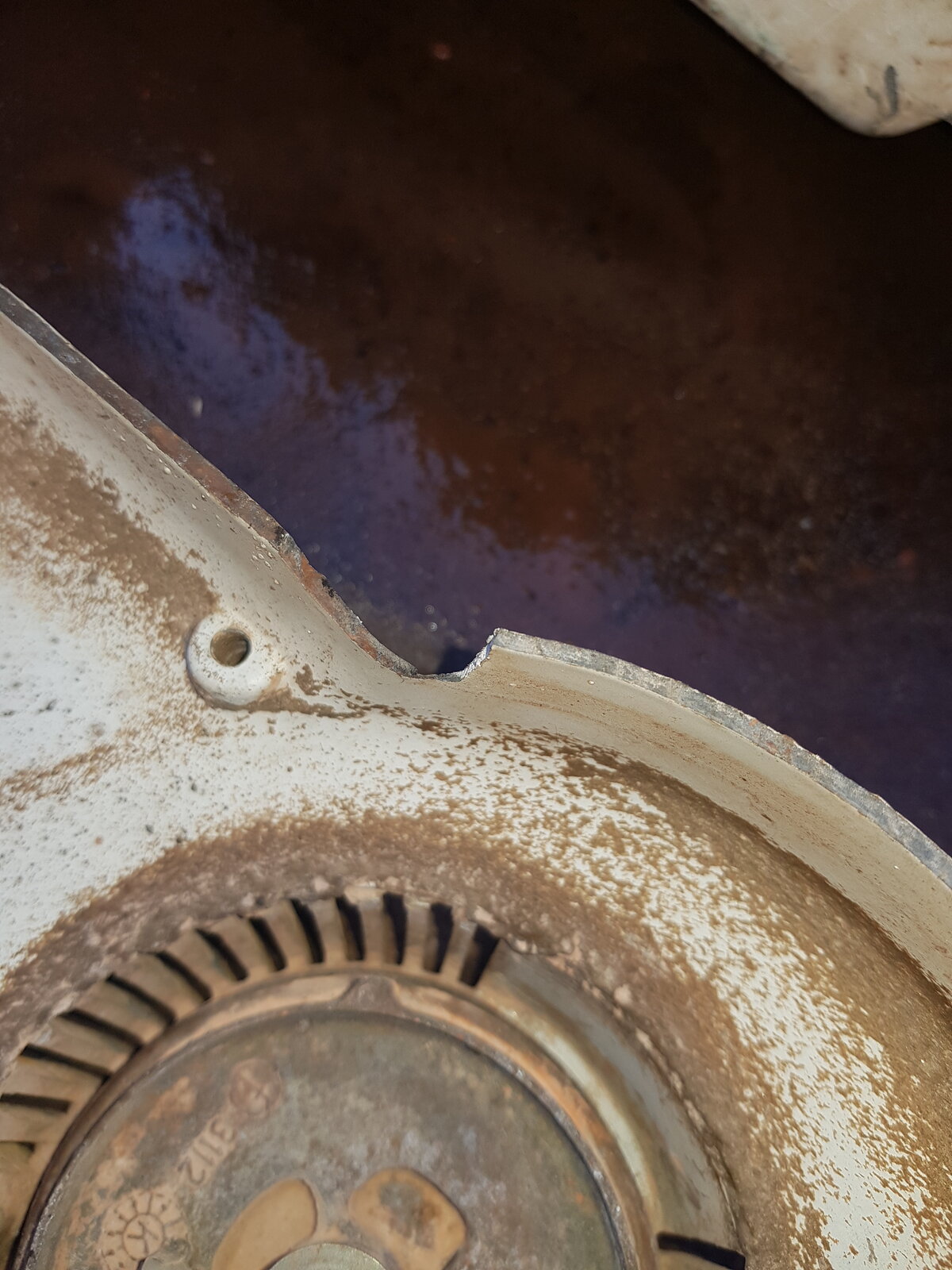

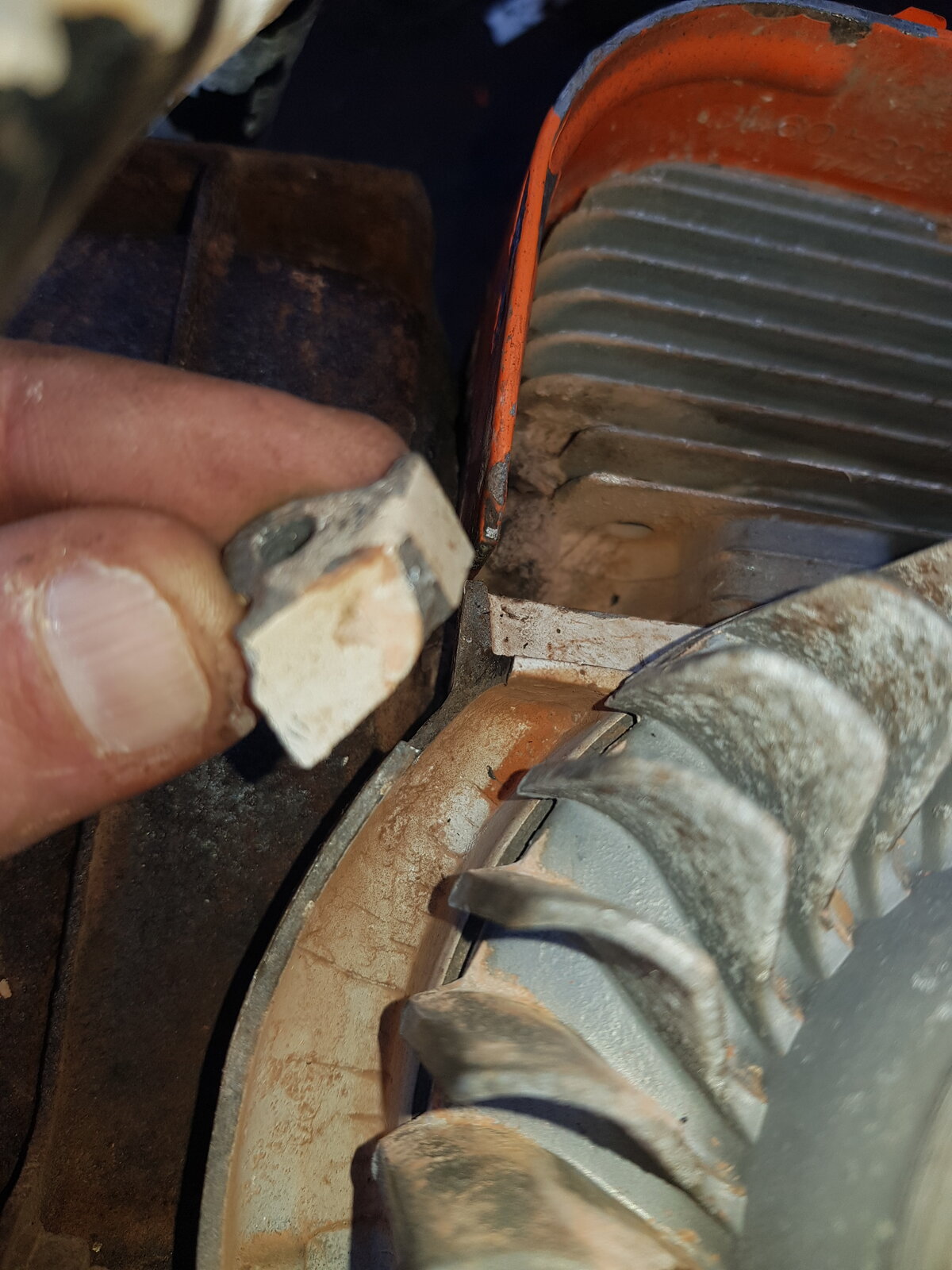

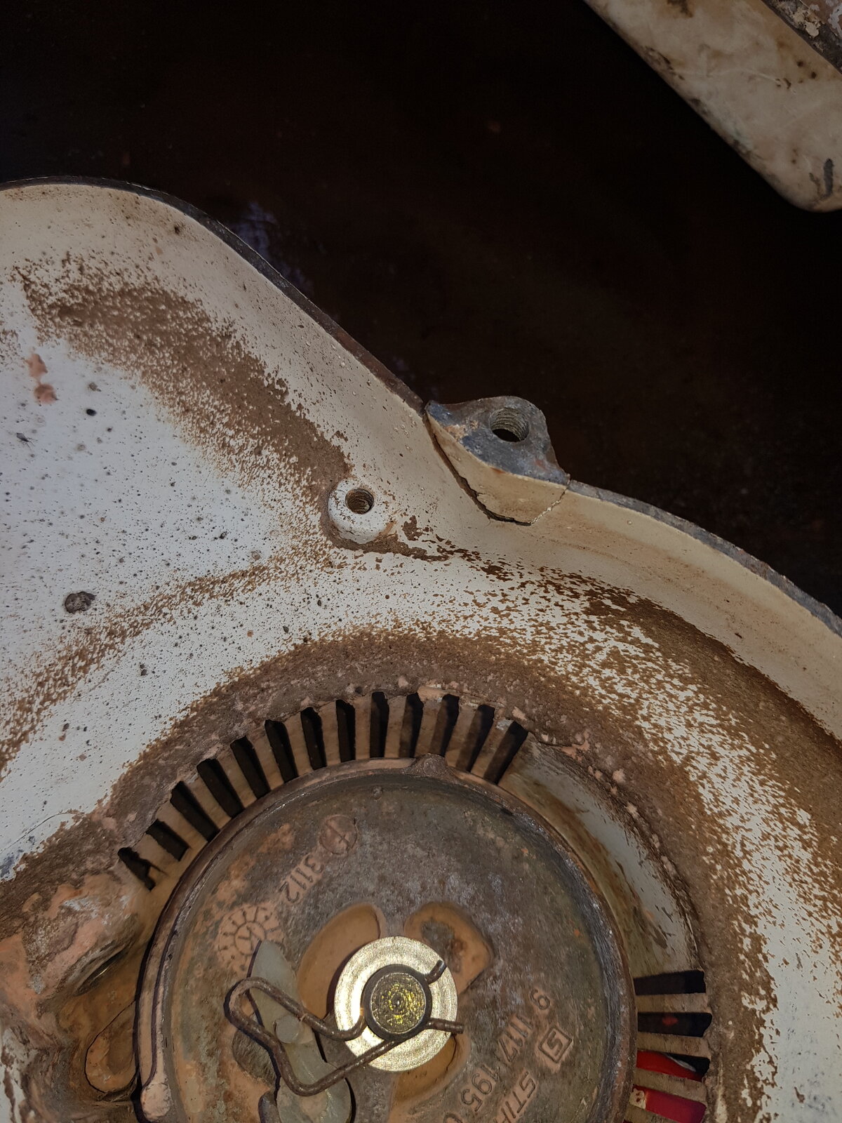

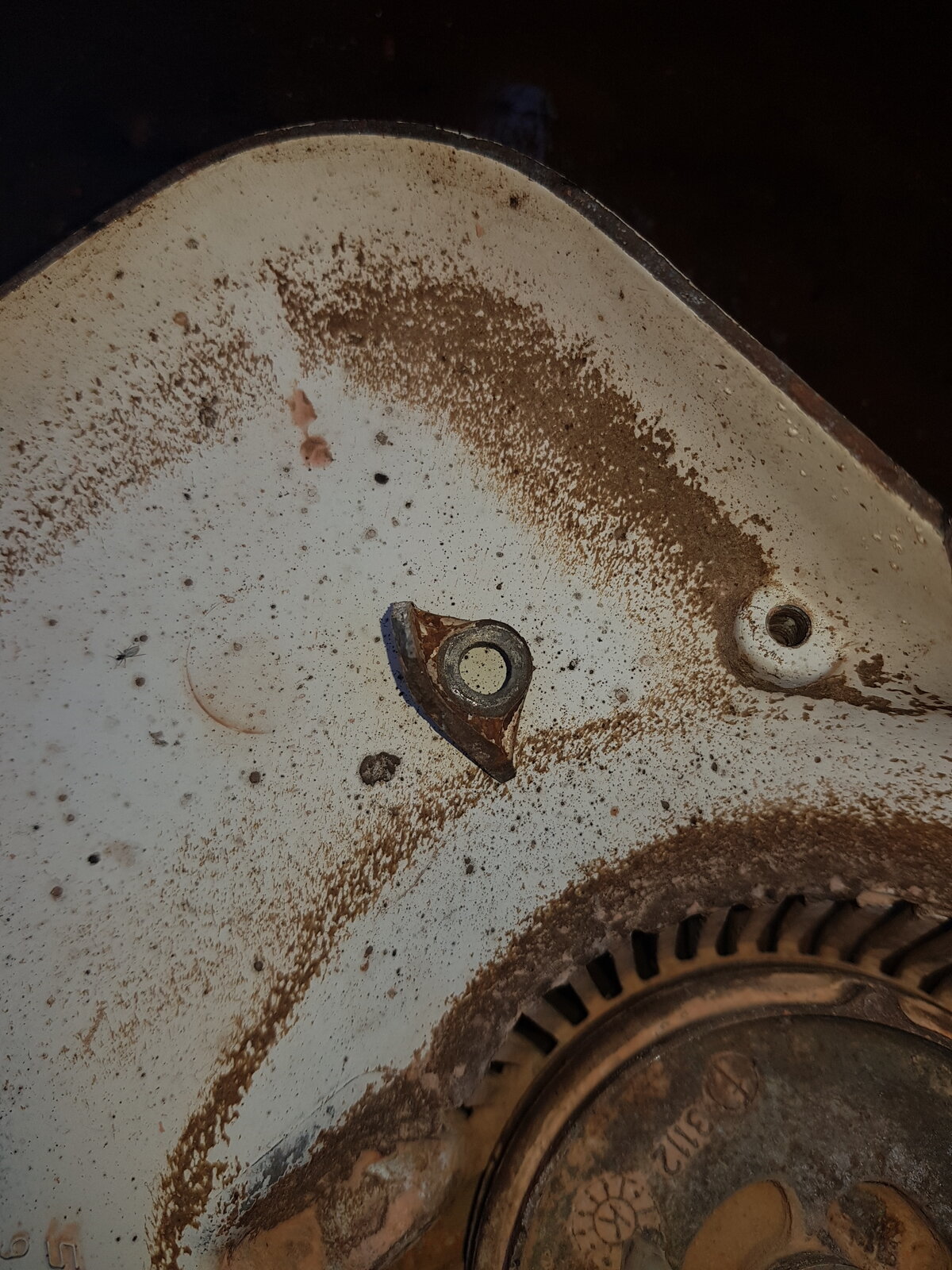

Apologize if this is not related to car repair but still about mechanical equipment and maybe someone could help me.
I have picked up from a friend an old Sthil petrol cutter which had all the nuts holding the recoil pull start completely locked. Look like they attempted to unscrew and with some brutal force they snapped the aluminium case. See attached photos
I know it may sound silly and someone just say get replacement parts but as these are more expensive than a brand new machine, I would like to try and put back togheter. I do not have access to tig or mig welding. Is there any epoxy or other product the could be used to stick these together again?
See photos
Nothing would glue that, your choices are find someone who can alloy weld back in place, or......
Shape a piece of steel to fit snugly inside the casing, so it can be bolted the remaining solid bits of the case. That could either poke out of the case to form the lug, drilled and tapped - or the existing broken bit of lug bolted to it, then the lug re-drilled and tapped.
If that is only to clamp, either epoxy might glue it, with plenty excess so long as it doesn’t foul, or use expoxy putty shaped to fit. Leave it a week before trying.
another option is stuff like lumiweld. Use with a hot blowtorch/ MAP gas. Build it up and shape
Must be cleaned surgically

I've tried it, no problem. Not the same brand, but it still worked. Try on some scrap first. The melting point of the ali* isn't much higher than that of the rods so you have to be careful to put in enough heat to melt the rod, but not so much to melt the base material. Like all these jobs, make sure it's clean and grease free. I can't remember if flux is required... but the instructions will tell you :)
I had the parts I was 'brazing' together enclosed in a corner of house bricks, just to keep the heat in. As you might know, aluminium is a good conductor so the heat you're putting in on one spot will be conducted away.
