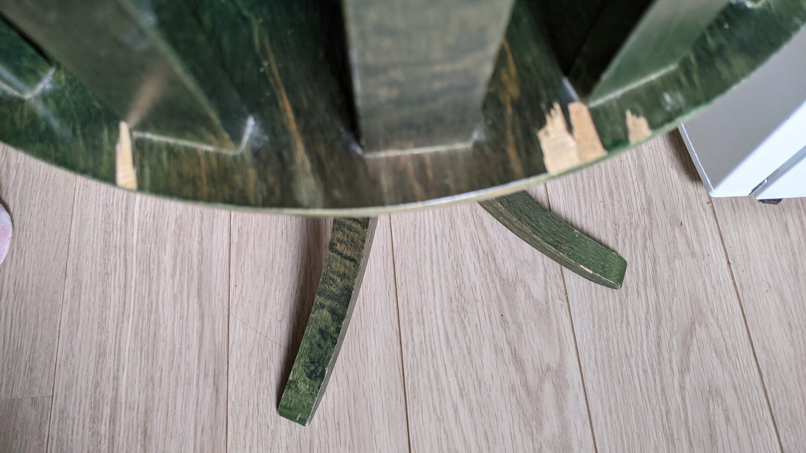

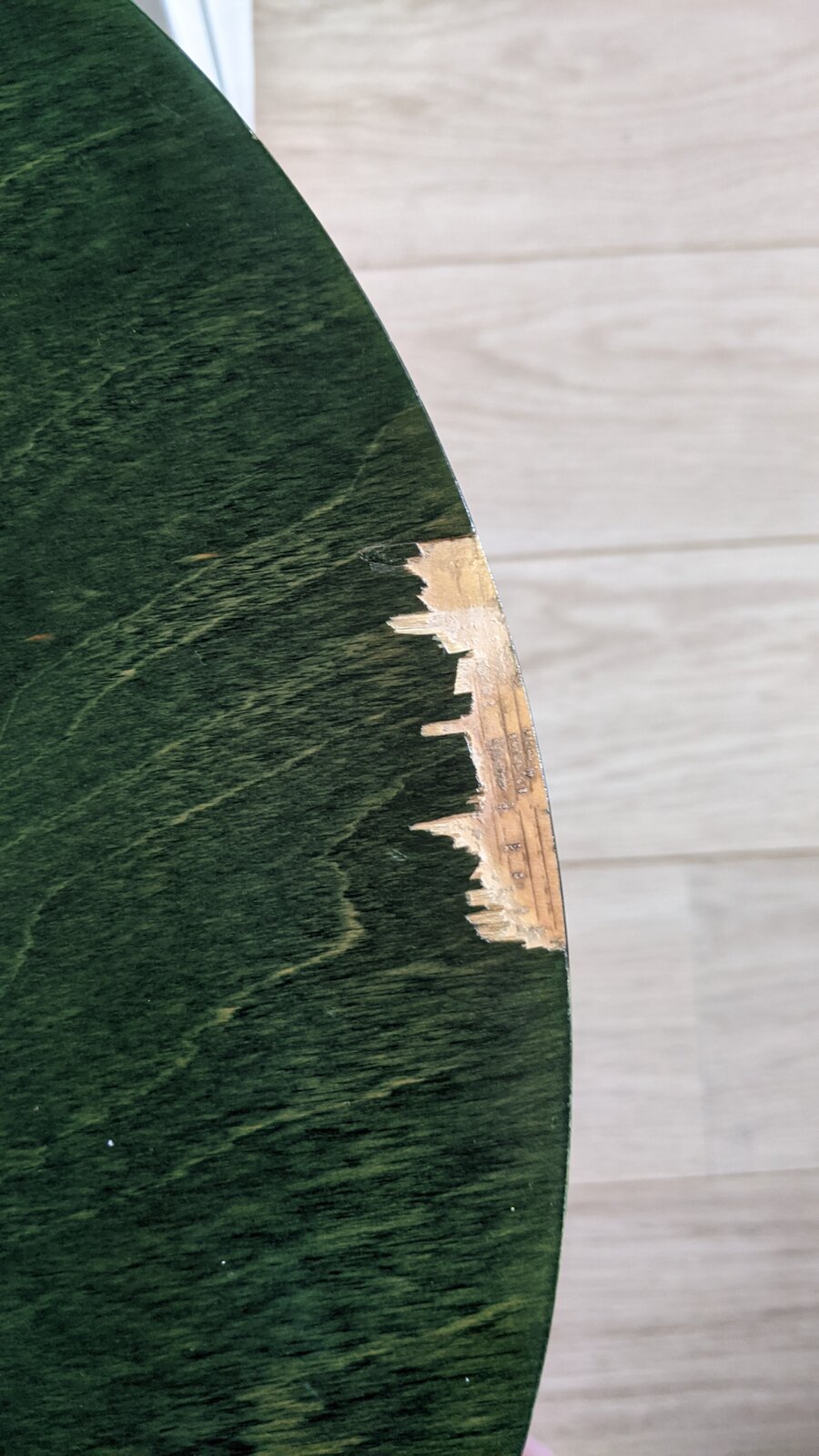

Thank you for your advice. I'm attaching some photos of the repairs I'm asking about. Initially I didn't do as you suggest and didn't remove the old glue so I'll do that this next time.
By contact glue do you mean original Evo stick, red can, or the wood Evo stick I used before? I was thinking of buying some small clamps. As you can see they would need to be small as it's the edge. Many thanks
Evo Stik wood glue, the white stuff in green or blue polythene bottles is actually a PVA glue, not a contact adhesive. Whilst it can be used for veneering, it often isn't ideal for small scale repairs because it requires clamps and cauls and takes 24 hours to fully set.
Evo Stik contact adhesive is better for small repairs, but a spray contact adhesive, such as EverBuild Stick2 is going to be a lot easier to apply and use successfully on small scale veneer repairs
Thank you. I'll look for that one. I was concerned about the glue leaking onto the good surface as it would be difficult to touch in any damage, due to the colour on the wood.
