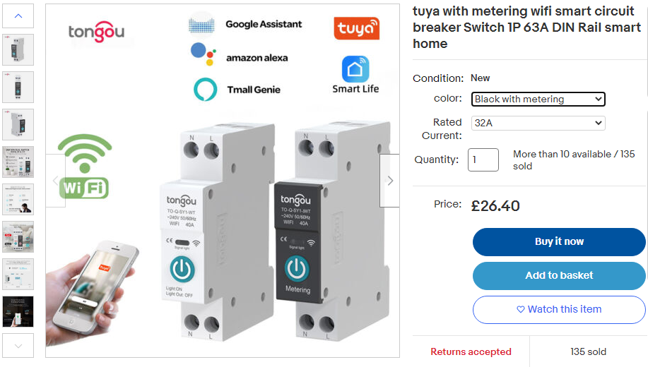

I want to monitor how much energy our electric shower is using. The shower is currently on a Hager MTN132 B32 MCB.
I assume that this Hager MTN132 B32 MCB goes on to a busbar and has a single live wire connection at the top.
On Amazon and eBay, I have seen MCB's that have WIFI functionality which include metering and other programmable functions (see photo).
However these MCB's seem to have 2 (N&L) connections both at the top and bottom, like a double pole switch. So I wonder if they can be used to replace my Hager MTN132 B32.
Does anyone know if I can just swap these MCB's?
Can I just connect the live wire into the 'L' terminal at the top. Then connect the 'L' terminal at the bottom into the busbar?
Can I leave the 'N' terminals empty? Or does the new MCB need to be attached to the DIN rail without any busbar and have the shower circuit wired through both N & L terminals, like a double pole switch?
Thank you in advance.
As it stands you would struggle to connect it in most consumer units.
However there are some Irish consumer units (GARO) that have a double buss bars for MCBs/RCBOs so it might fit those.
The easy answer though would be to mount this unit in its own enclosure and feed this from you existing consumer unit (Where the outgoing shower circuit is now connected) then on the output side of this WiFi unit connect to the shower cable.
In other words the circuit would run, like now, from your existing MCB then to this new unit and hence give you monitoring etc.

You would be better off with another energy monitor type.
These wifi breakers are all Chinese made struff thats only popular because they have the wifi gimmick.
A Hagar MCB is a a far better protection device, it's known and trusted more. (AIUI).
To use any device in a consumer unit, it must be sanctioned by the consumer unit manufacturer, to retain its type testing.
So you will need to fit a tongou consumer unit, which needs notifying to LABC so will not be cheap.

Think you have missed the point, I did consider an auto resetting RCD before they were not permitted for domestic, but the problem is to fit anything into a consumer unit, without making it into a distribution board, the items must comply with type testing rules, so the CU manufacture has to say they can be used.
We have seen the problems with varying bus bar heights, and cut outs, also there is the distribution of heat, so a bell transformer has to be same make as CU even when not connected to bus bars.
Not sure what the smart function is? Other than current monitoring, but can't see any BS numbers so not sure if allowed?

I all like RCD protection, but think missing the point, I went to the web site, and they have RCBO version, and also versions where the minimum and maxium voltage can be set, so would auto disconnect with loss of PEN. In all it seemed to have a lot of really good stuff on offer.
Some were marked CE although that's no good for UK, but no BS or EN numbers, so could use as well, but not instead of a standard MCB, RCBO.
There are versions with a mechanical reset, and marked as B32 etc, but they are double unit width, so not comparable with UK consumer units.
