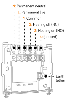

I have no permanent neutral or heating off wire. Both of which are indicated as required in the Hive installation guide.

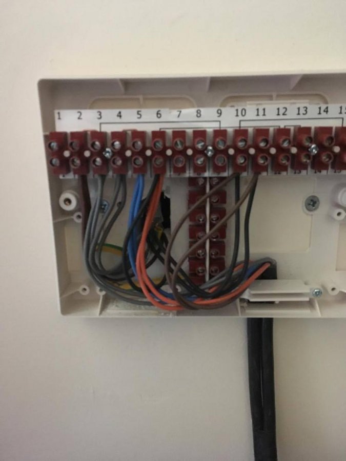

Here is my wiring behind the battery TP500
Here is the Hive install image
I do no have N or 2.

I assumed the grey wire was the live. I believe it is wired in to the multi zone valve system and on to the combi boiler.
Grey doesn't appear connected to anything and the blue sleeve would suggest it was originally intended to be a neutral.
One way or another you will need to do some rewiring to connect the hive up. Where the TP500 is, is where the wireless thermostat should go. The receiver ideally needs to be fitted either near the boiler or where the zone valves are if you have more than one for the heating zones.
These are the wires to the zone valves.

Hive Multizone. So would install two receivers and two thermostats.
With multi zone you'd need to fit both receivers next to that wiring centre. The receivers act as the switch which your TP500 currently is doing.
You have all the wires you need there, you need a bit of 4 core wire for each receiver and a few wires need moving about.
Good news all wires are there.
I found the diagram on the back plate. Are you able to tell which numbers go to the N,L 1,2,3 connectors on the Hive receiver? FYI on my valve system there is a bridge between 2&3 and 4&5.
My guess is
Hive Diagram - Valve system
N (perm Neg) - UNSURE
L (perm Live) - 11
1 (Common) - 3
2 (Heating off) - NOT USED
3 (Heating on) - 6

It hasn't been wired as per that diagram so ignore that.
Am i right in saying there are three wires in terminal 2?
If so then
2/3=Common to the TP500 and permanent live to the zone valves.
4/5=Neutrals
6=Switched live to boiler.
10/11=heating on wires to the zone valves.
Sooo...... for the hive you need to take a 5 core wire.
Hive L to 2 or 3
Hive N to 4 or 5
Hive 1 to 2 or 3 (if you wanted you could just put a link wire between Hive L and Hive 1 and just use a 4 core wire instead)
Hive 3 to 10 or 11 depending on which valve/heating zone its doing.
You then remove the wires from 2 and 10/11 that are currently wired to the TP500.
Id wire the first receiver in and pair it to a thermostat, then do the second receiver add that device to the hub then pair that up with thermostat.
