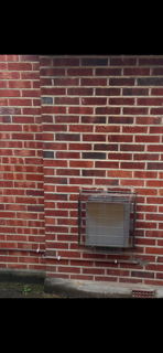

Hi Im trying to extend my garage but i have ideal Mexico boiler grill that sticks out of my external wall. It will be in the area that is supposed to be covered by the extension but instead of a chute it has a grill (see attached). Can some one please advice if i can have a standard chute instead that could stick out of my future roof in that area. many thanks
photo attached this time
Cannot alter that flue in any way whatsoever so its new boiler time
