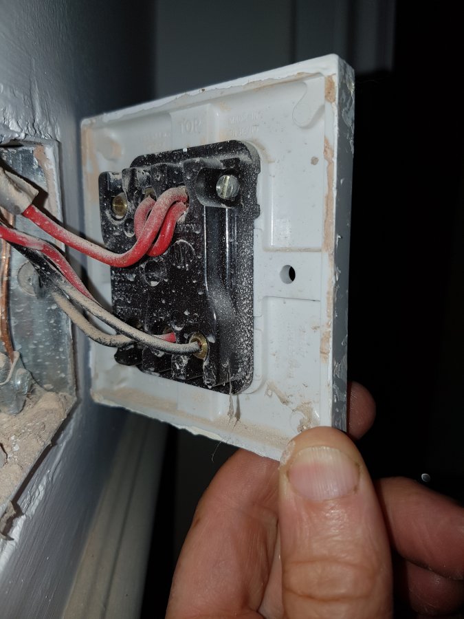

Hi, I'd like to replace the below switch with a chrome version. Its a double switch which controls the hall and landing lights separately. What do I need to buy. I'm guessing this is an old arrangement or can I buy this configuration ?

And buy some earth sleeving of those bare copper earth wires, just to tidy it all up when you've fitted your new switch :)
DS
Don't forget to earth your new metal switch.
Easiest way would be to connect another wire to the wires in the box connector running to the switch.
The one in situ has 3 points for the wire and the new ones I've seen have 4.
Your existing switch has 6 terminals, 3 for each switch, 5 used 1 is not.
The only switches with 4 are intermediates or 2 pole, neither of which are suitable. Or those horrid efforts from China which often have touch controls and other nonsense, usually sold on ebay or a similar tat outlet. Don't buy electrical items on ebay. In fact, don't buy any item on ebay.
This is the type of switch as a direct replacement: http://www.screwfix.com/p/lap-2-gang-2-way-10ax-light-switch-polished-chrome/25936
Many others available.
