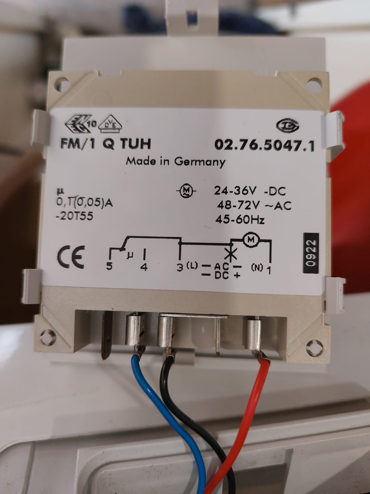

Hi, I am trying to replace an analog timer with a Hive, but the timer only has 3 wires. every other discussion I have read mentions 4 wires!
1 (timer) to N (hive)
3 to L
4 to ???
Please help!

View attachment 297921 Hive is not 48 - 72 volt AC, so can't see how you can replace with Hive without some relays etc.
That is the supply to the motor for the timer.
Theoretically, terminals 1 and 3 of a single channel Hive could be connected to the Black and Blue wires (Red being safely isolated).
The Live and Neutral to power the Hive could be picked up elsewhere.
No need for any additional relays, but using the intended terminal block would be preferable! :)

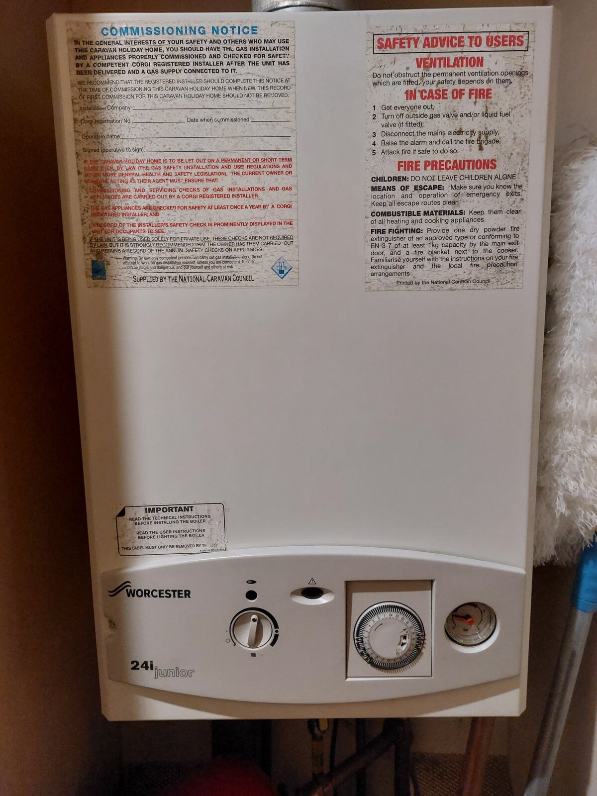

it's a Worcester 24i junior

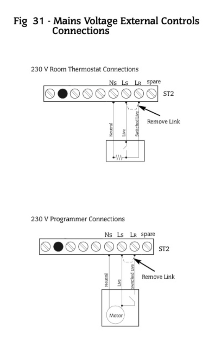

The connections for an external thermostat are on terminal block 'ST2' (Where the mains flex connects to the boiler PCB):
Remove the link between Ls and Lr on boiler.
Assuming a single channel Hive:
Ns to N on Hive
Ls to L
Add a link wire between L and 1 on Hive
Lr to 3 on Hive
Ns to N on Hive
Ls to L
Lr to 3 on Hive

Everything was perfect yesterday, but today I have an airflow fault! (Indicator light flashing fast)
I think its making all the right noises, so I hope that means the fan is OK. Gas cooker is working fine, water in taps is fine, should I get on the roof and check there isn't a bird nesting in the chimney!? Or is there anything else I should check before I call a professional?

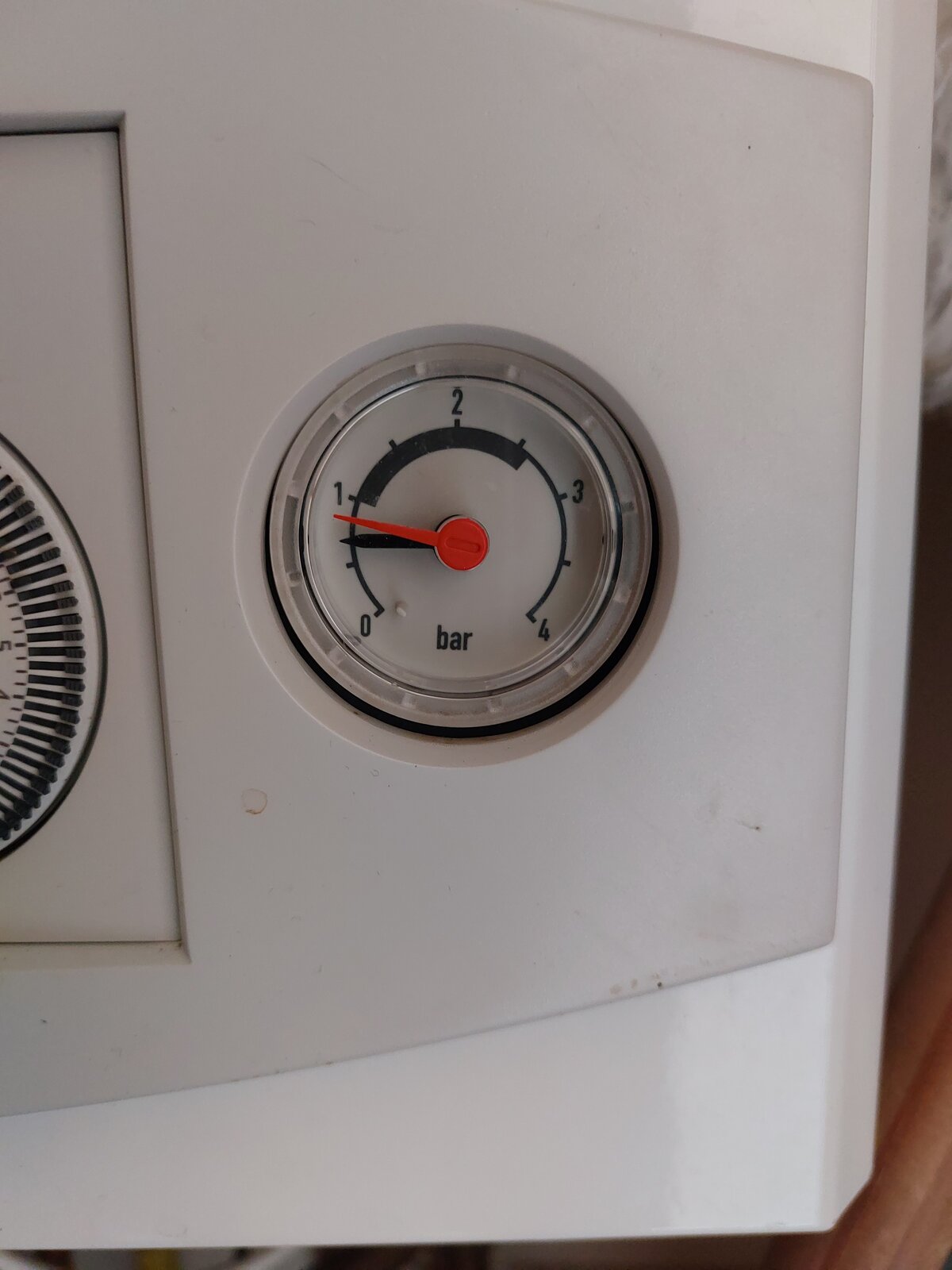

Pressure looks a bit low, but I thinks it's always been low...
Fingers crossed its only a coincidence that this is the after installing a thermostat...
Don’t think you need to get on the roof, should be able to see visually if anything blocking the flue. I suspect there‘s an issue with the boiler itself - my advice is get a professional.
