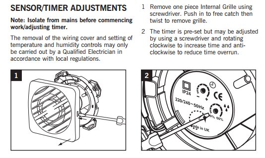

Replaced extractor fan but still no joy
just a thought, did you ensure fan blades are free to rotate after installation?
What does RV2 do? Length of overrun?
Presumably. Given that there are no other adjustable components visible, I presume that it is what one's screwdriver accesses through the hole in the cover (when it's on) ....
