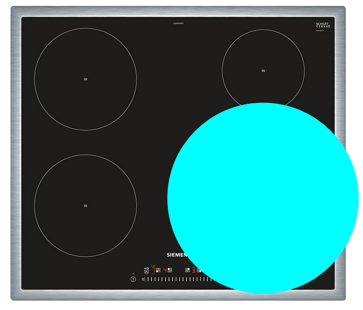

I have just been looking at Siemens EH645FEB1E induction hob, although this has a total KW7.4 rating its also has a 20 amp rating and fits straight into the worktop. https://www.johnlewis.com/siemens-eh645feb1e-induction-hob-black/p3255902

The only thing I would advise about that is that you consider the practicality of touch controls, and controls built into the hob like that.
Firstly, to adjust any "ring" you have to first select it, and then start swiping your finger. That is nowhere near as fast as having dedicated knobs which can, if necessary, be twiddled two at a time.
Secondly, you might have problems accessing the controls in the first place. This is how that hob would play with my largest pan in use:
Rather impractical.
IMO, designs like that are a triumph of trivial cosmetic appearance over sound functionality.
