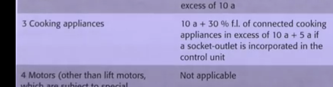

OSG (and the other two books cited): 10A + 30% f.l. of connected cooking appliances in excess of 10A....
Note it does not say 10A + 30% f.l. in excess of 10A of connected cooking appliances...
The "in excess of 10A" is an adjectival phrase which, because of its position, relates to the cooking appliance, not the full load current.
It means that the current is deemed to be 10A, plus, if the appliance has a f.l. current of over 10A, 30% of that f.l. current.
That's the way that English works.
10A + 30% f.l. of {connected cooking appliances in excess of 10A}....
As for the link to the book on TLC's site, you can either go with what 3 IET books say when read according to the rules of English, or you can decide to ignore those things because you want to believe someone else who read it wrongly.

So according to BAS.
For a 10A cooker you have to allow 10A.
For an 11A cooker you have to allow 13.3A.

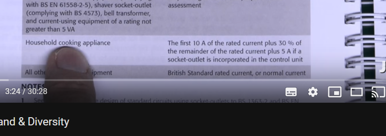

The standard wording is .... the first 10A plus 30% of the remainder.
What's going on? I am relying on the formula which has been in existance for 60 years.
I've been silently watching these exchanges with interest - since I also wondered "What is going on?". Like you, in all the years I've known about diversity for domestic cooking appliances, everyone I've known has regarded/interpreted it as "the first 10A plus 30% of the rest" - and, incidentally, that has been the basis of innumerable posts in this forum over the years, without anyone ever having previously challenged it.
Given that, as far as I know, there are no regulations which cover this, I'm not sure who/what could be regarded as an authoritative determinant of what the formula 'should be' - but I think/presume that nearly everyone relies upon the OSG.
I initially thought that BAS's most recent (grammatical) comment simply related to poor wording by people who didn't understand the grammatical nuances. However, now having looked at my (red) OSG, I'm starting to wonder. Whilst the wording for domestic cooking appliances is as has been stated, for small shops etc. and small hotels etc. is it stated as "100% of f.l. for first appliance and X% of f.l. for second appliance and Y% of f.l. of remaining appliances - so they do, in some situations, use that grammatical construct. However, for the generic/default domestic "Heating and Power (but see 5 to 8 below)", it says "100% of total demand up to 10A plus 50% of any current demand in excess of 10A" - which is consistent in form with how we have all always understood the calculation for domestic cooking appliances.
If BAS's ('grammatically strictly correct') interpretation correctly reflects the 'intention', it is surely crazy - since it means that one could have an unlimited number of 10A (or lower) appliances on one circuit with the 'after diversity' current of the lot never being more than 10A. Indeed, if one regarded all the 'hob rings' and ovens as being separate appliances (after all, they could theoretically be physically separate) one could end up concluding that a massive cooker (or, certainly, the equivalent in 'separates'), with many hob 'rings' and several small ovens/grills, could be run off a B10 with 1.5mm² cable! The interpretation which nearly all of us have always used seems a lot more sensible than that.

What then is the difference between Tables A1 and A2?
Mr.Ward did not seem to notice the difference.
As Detlef has pointed out, 11, 12, or 13A ovens, by Table A2, are therefore not allowed on 13A plugs.
This is obviously wrong so the first column of Table A2 must be an error - hard to believe such a thing is possible in the OSG.
Using diversity calculations is not compulsory.
Or the 5th row of A1 is wrong.

Irrelevant. Which is correct?
By the other two links and indisputable logic -
it must be A1

When using it, a method that makes sense is probably the correct one.
Occam's razor.
Unlikely as the equivalent of A2 is a nonsense.
