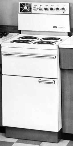

One problem here is that when the guidelines first went into the OSG, this is what a domestic cooking appliance looked like:
but they have changed a bit.....
Maybe the guidance is no longer appropriate.
If your "half a dozen 10A domestic cooking appliances" were welded together into a 6 plate hob, you'd end up with one single 60A appliance and 25 or 28A, which feeds into the idea I've often proposed which is that it makes no sense to consider, say, 2 built-in ovens and a hob as 3 appliances, each with their own 10A + whatever, because there are no electrical or usage-pattern factors which mean that if you took an angle grinder to a range cooker and split it into 3 lumps you'd suddenly be using more electricity, or conversely if you took your 3 appliances and installed them into a single free-standing cabinet with one external facing electrical connection you'd suddenly be using less.
