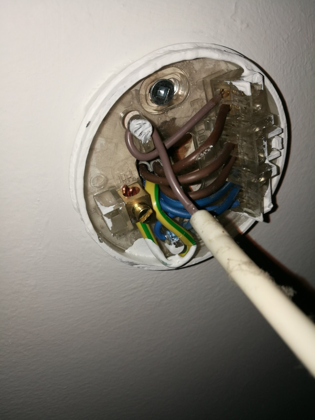

I'm currently in the process of swapping a standard ceiling rose to a nice metal fisherman style pendant and hope some of you more experienced diyers can help;

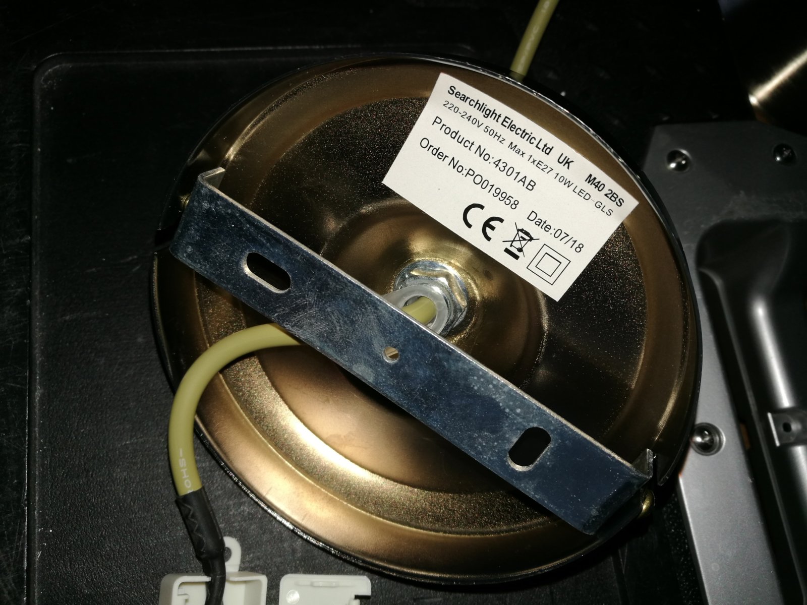

It is/was my intention to wire up the new lamp using wago connectors and house them between the lamp housing/ceiling, however the pendants have now arrived and I note a couple of things, 1. There won't be enough room to hold all my connector blocks in the lamp itself and 2. It's class 2 - so has no earth.
My query is - if I can manage to fit all wago connectors inside (which I doubt) - is this still sufficient in relation to wiring being double insulated, or will I need to fashion some sort of earthing for the cover?
And secondly - if they don't fit inside, the only alternative I can think of is to use a larger junction box for all the connections and push it up into my ceiling void (if I can create a hold large enough and keep the holes required for the lamp) - are there any alternative/easier ways to do this?
No.
I would say, yes.
Is it connected metalically to the actual light fitting? It looks like a metal rod.
I would just fit the bracket behind the rose and connect the new cable to the same terminals on the rose as the present light - plus earth to suitable ring lug to the centre nut.

Thanks for the reply - I did try this but unfortunately the cable needs shortened and uses up space within the ceiling rose of the pendant meaning there isn't the room.
I also considered shortening the flex by cutting it down to exactly what I need but it doesnt appear to be one single piece of wire within the sheath - more lots of strands with a little metal cover - which then goes into the connector. Can I shorten this and buy the little metal cover to place on my new shortened flex?

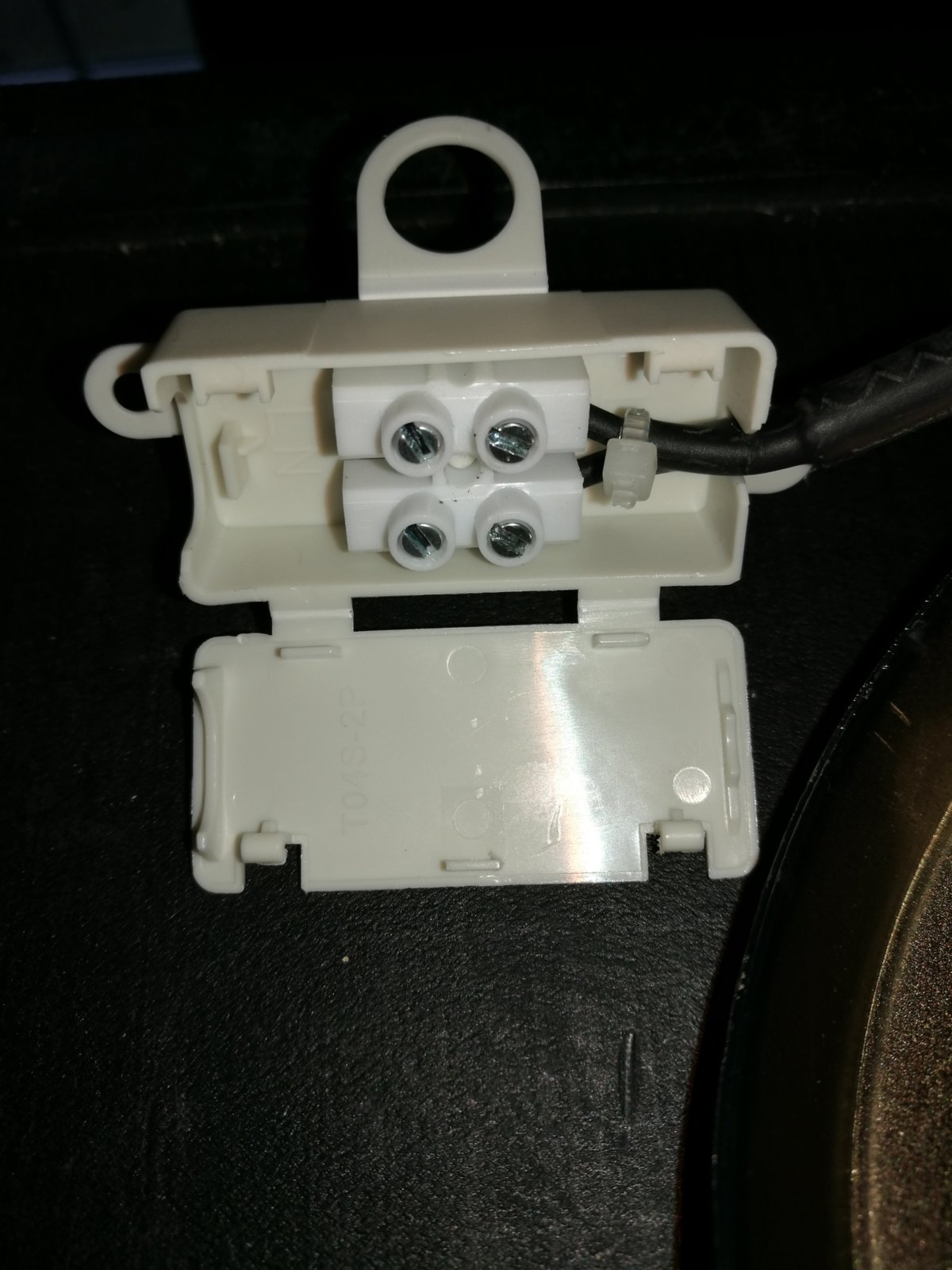

No, don't cut the flex.
Junction box in ceiling, then ?
Then no need to earth it.
That looks like a heavy pendant. Whilst EFLI's link to the Ashley box is suitable, of course, I personally would go for a...
https://www.downlights.co.uk/ct102c.html
This way the flex from the pendant can be wired up nice and easy on a table/workbench, rather than up a ladder holding up the weight. You just connect them when you're ready to mount it.

I assume you mean stranded flex and a ferrule. You can fit a new ferrule but you need a special tool. You could just twist the strands and fit them under the screw as has been done for years, or perhaps you could twist and solder them together.
