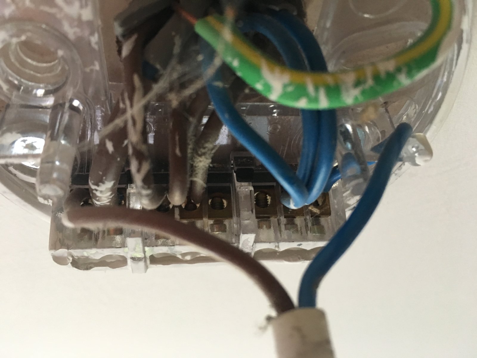

Hi all
I have recently bought a ceiling light to replace a pendant but I am unsure how to connect it since it has a few more wires than usual :D
Could anyone explain how I need to wire up the new fitting in simple terms.
The new light has 3 wires, one earth, one live and one neutral.
The existing pendant seems to have one switched live but then 4 brown in the middle and 3 neutral wires on the right hand side as I look at it.
I managed to fit the other lights in the house using wago connectors but that had one switched live, 3 in the middle and only 2 neutral wires on the right hand side.
If anyone could tell me what type of wago I need for this configuration I would really appreciate it.
I have attached a picture of the existing fitting.

It's only got one more L & N than usual, but other than that it's just bog-standard ceiling rose wiring (even though done by a bit of a twit who stuffed multiple conductors into one terminal whilst leaving others which he could have used empty), and you really ought to get your head round that before doing jobs like this.
In simple terms by getting your head around how lighting circuits work, and thus knowing how to connect the various wires. It really is only a few hours work, and trying to do it by just following instructions to put-this-wire-in-that-hole without understanding why is really not a sensible basis for electrical work.
But I expect someone here will do that for you, particularly those who disagree with the idea that you should be encouraged to learn something useful, and who are more interested in having a go at me for suggesting such a thing than actually acting in your best interests.
[EDIT]blue you mean brown[/EDIT]​
Why it has an extra cable would be interesting for you to find out, but assuming everything is working as it should, it has no bearing on replacing the light beyond making sure you have connectors suitable for connecting everything as it currently is.

Ones with enough ports for the number of conductors you have.
It's connected in the same way it is now, which is the same way as the others were. The wires have the same functions, there are just more of them.
The fact that it has more wires than the others just means you need connectors which can accept more wires.
