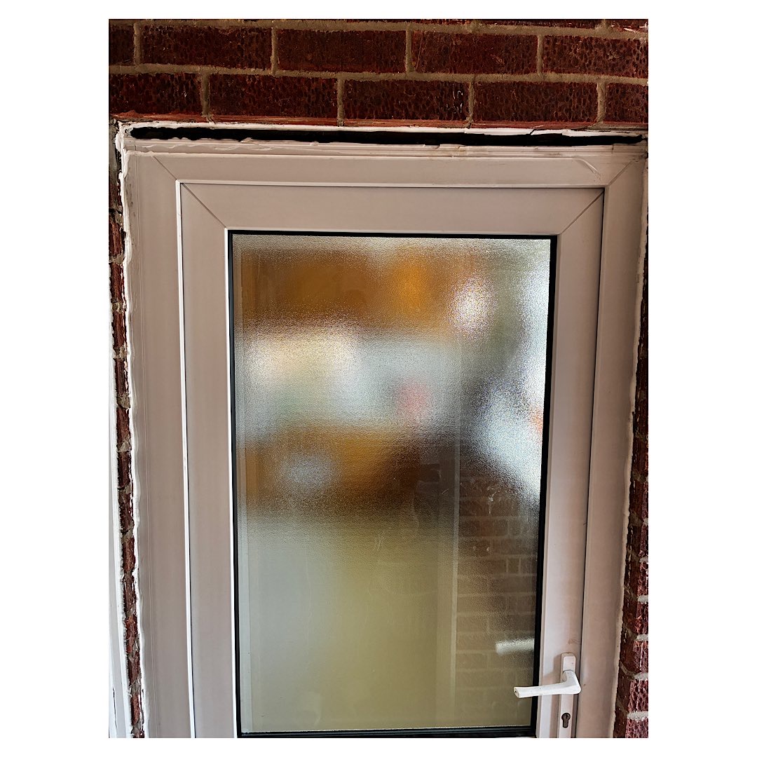

Hi all,
I need to replace a door which is external grade albeit it is all internal- it separates the kitchen from an unheated utility area. I was going to replace it with something a bit nicer looking, wooden etc.

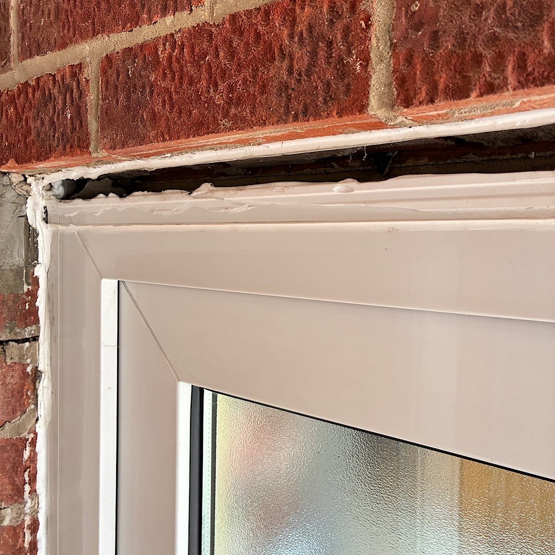

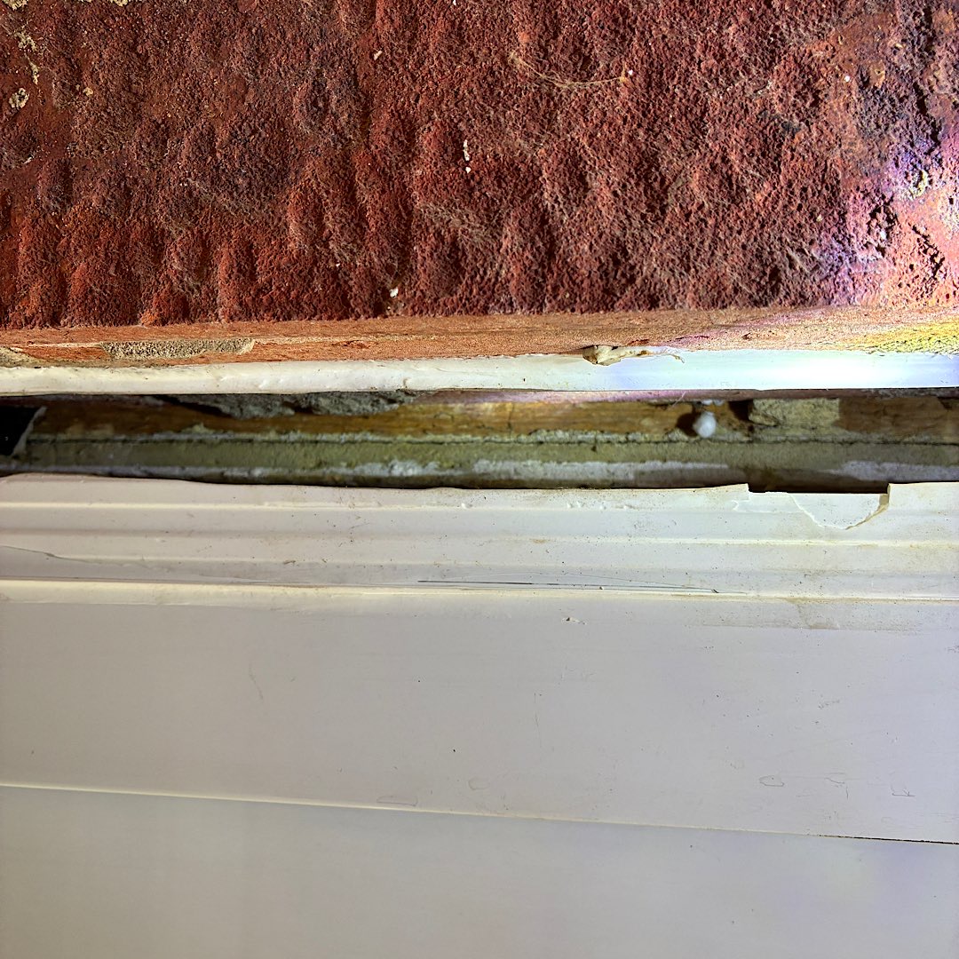

I've removed some of the upvc trim pieces to help measure up, and accepting I need a bit of tolerance I just wanted to check a couple of things. On the kitchen side there is what I assume is the concealed lintel albeit where the door actually is, there's just single skin brick and nothing supporting it underneath as such. Does this look right?
Secondly there's an 18mm gap between the bottom of these bricks and the top of the existing door which I assume shouldn't necessarily be there and I can just size it as per the size of the opening (measuring from 'outside' dimensions where there's no plasterboard) and then just take away the recommended tolerance?
Thanks in advance for any pointers/advice.

The outer skin may not have a lintel, particularly if it’s a 60s era house. Inner skin should, and there will be ties between them, but I’d add an outer skin lintel as part of the work.
Other possibility is there is a catnic-type/eaves lintel set really far back, can’t really tell from pic
Get in with a torch, if it's just plasterboard then you have the option of raising it. If you want the plaster work for an inch of extra height. Otherwise your new door opening may end up behind the edge of the plasterboard.
Best guess is the door was ordered before the floor was done, so they left themselves loads of margin.
As you say it appears to be a single skin with no lintel so presumably not a load bearing wall but you would have to tell us what is above it to be certain. My guess would be that at one time there was an internal door and frame there which has been replaced with a UPVC or aluminium external door for some unknown reason. The old wood frame wood have supported the brickwork but it must be sound after the door was replaced because there does not appear to be any sign of it dropping. Have you thought about just replacing the glass panels with something more decorative or even just painting the casing. Seems like you may be creating a lot of unnecasary work by replacing the door and frame.
The bricks look quite modern. Use a strong magnet to test if there is a steel lintel that we can't see.

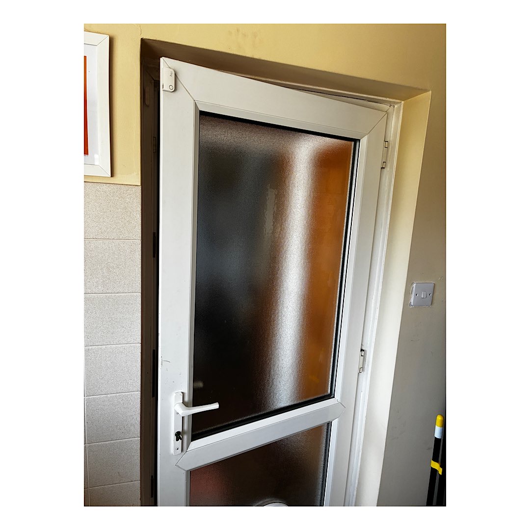

Thanks all for the assistance- much appreciated.
So...past that outer brickwork and where the door frame currently is, I can see a wooden beam running across, and then plasterboard. I've attached a photo of what is behind.
This wall is the old external cavity wall and would have potentially led to an attached garage, or possibly not an opening at all. I don't know whether the old garage ran all the way across the gable end. The previous owners extended above the garage and added a utility room on the back (ground floor) which is where the door currently leads to. The house was built in 1970. Extension done in the 90s I think.
I've fished around with a magnet in the gap and this course of bricks and can't find any indication of metal anywhere....

Depending on the age of the house, it may well have been built by placing a wooden frame, and building the wall around and above it.
These often come to light when wooden doors and windows are replaced with plastic, and the brickwork above is not adequately supported, eventually cracking or sagging.
If your brickwork is still sound you could probably wiggle a steel support into place, packed round with stiff mortar. Try to do it before you start building work as hammering and banging may trigger movement.
That wood may be a bit of packing to bring it lower down, with a lintel above it or (more likely) it's the bottom edge of a taller wooden lintel that's holding up the wall above.
Perhaps drill a few easily filled shallow holes on the plaster side, see what's beneath. If there's no lintel at all then you need some work doing.
If there's a lintel on the plastered side only then it's not ideal but debatable whether that's an issue. That inner wall holds the roof and any floors or ceilings above, the outer wall only holds itself up. It would have originally been better supported by a wooden door but it's probably not a major issue.
Thanks- I'll do some investigating on the other side as suggested.
Hi again all,
I have now checked and there is a lintel, so all good there. I've ordered my replacement door which has arrived (solid hardwood door and frame). The frame size is pretty much dead on to the aperture, giving a little wiggle room obviously.
