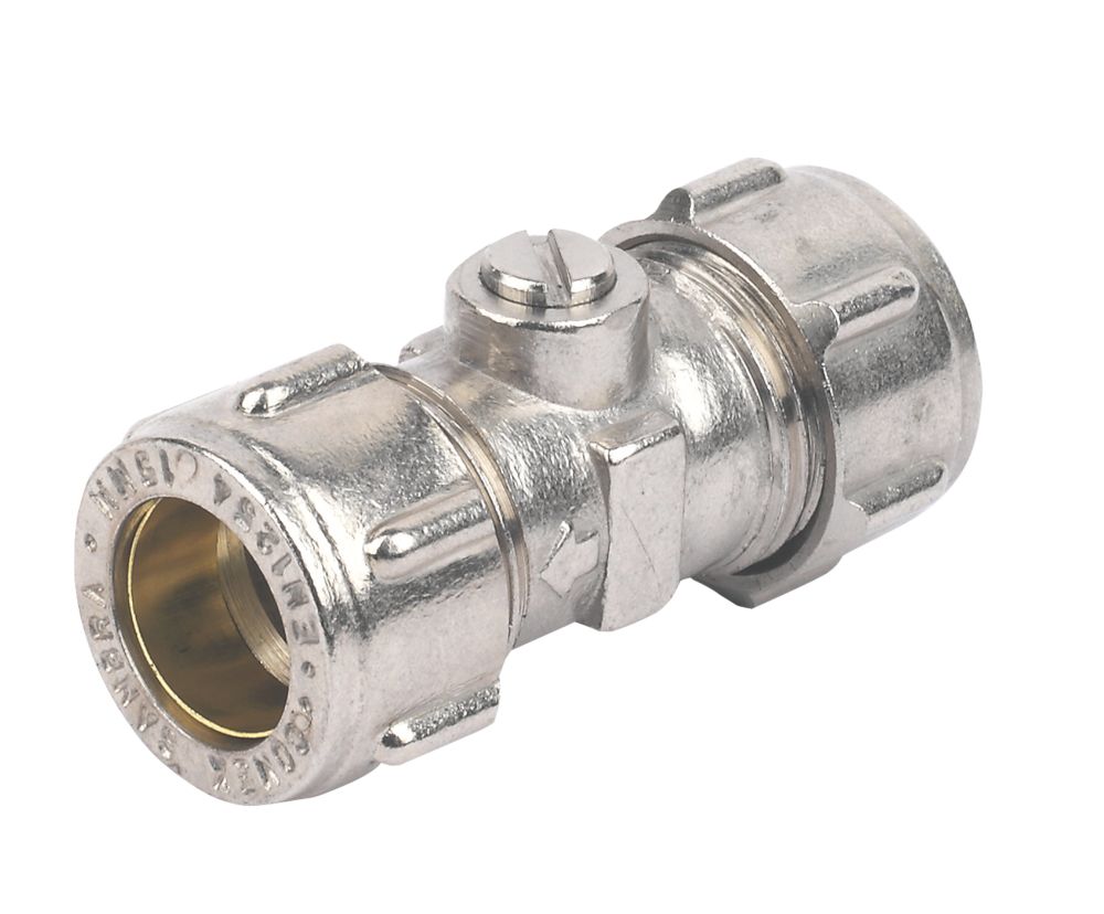

If it really is modern, then you should find some isolation valves.
ae235
Then you would at least be able to turn your stop cock back on.
