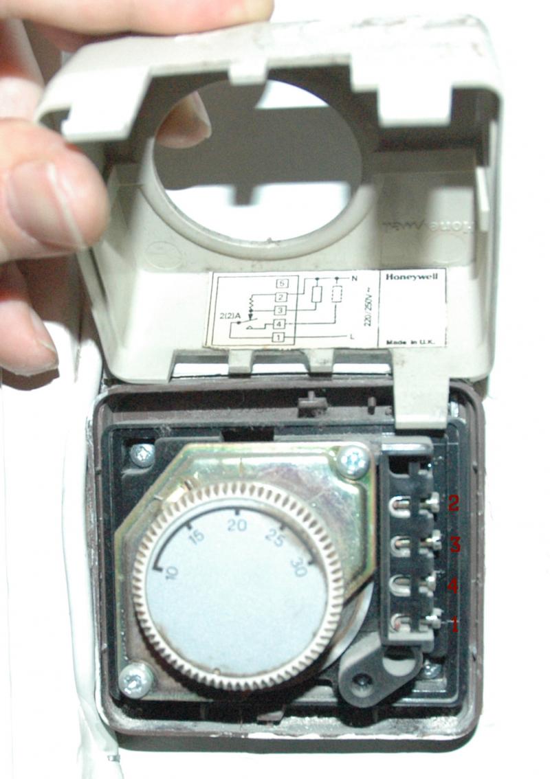

Still left over from the original installation is the main thermostat for the central heating, it is an old Honeywell model (see picture). What I would like to do is to replace it with a wireless thermostat so that I can move the control unit into the basement which is the coldest part of the house and the one room which does not have control valves on the radiators.
What I need is some advice on what wireless thermostat would work with my existing wiring. I have attached a picture of the thermostat. There are three wires coming in (I have marked them on the image); line 1 is the live wire, line 3 switches on if the room is cold and off when it has reach desired temperature. Line 2 appears to be off all time time (at least when measured with my electricians screwdriver)

Your wireless room stat will usually comprise of two parts. The receiver and the sender. The sender is the room stat that you've taken a picture off and the receiver is the switching relay. The switching relay box is best placed near too the wiring center, depending on what type of system you have its *usually* between terminal block positions 4 and 5.
Check out a S or Y plan schematics.
Then your room stat will just sit over the old wiring (un-used)

Ideally what I would like to do is to replace the existing thermostat with the receiver of the wired unit and then place the sender in the basement which we need to control the temperature. The existing thermostat is in one floor down from the main controls which are right at the top of the house. I am a little worried that if I place the receiver at the top of the house and the sender in the basement the signal might not be strong enough to control it.
Since my original post it has occured to me that I would need to run a separate power line to the receiver since I am assuming that none of the lines running into the existing thermostat is a neutal.
What is puzzling me though is why are there three lines coming into the thermostat? Lines 1 and 3 make perfect sense to me, I don't understand if line 2 (which appears to be off all the time is likely to be doing anything.
2 Is neutral.

2 goes to N,
1 Goes to L (left hand of the two)
Link second L to A
and 3 goes to B.
Of course I am assuming you are going to use a CM921/927 as your replacement and that the current room stat is CORRECTLY installed.

Look at the wiring diagram - it's inside the stat. See the pic you posted!

Brilliant! Thanks a lot; I had not twigged that the box on the diagram represented the boiler, it now all makes perfect sense as does your wiring instructions. I was looking at CM921/927 as the replacement as people seem to rate it it and had already downloaded the installation guide.

Thanks for all the advice, in the end I went for a DT92E (which has the same relay as the CM927 just fewer features and is about 1/2 the price(£77). Fitting it was very easy and the signal has no problems with our tall house.
I think this will easily have paid for itself by the end of the winter!
