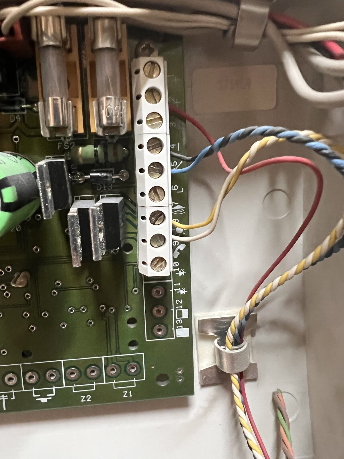

Hi all; long time reader; first time poster here!
I am in the process of replacing my old alarm panel (FM4000E) with a Texecom Premier Elite but have hit a bit of a snag with the external alarm sounder. I've basically realised I cant' remove the panel without setting off the external bell box and sadly I live in a block of flats with the bell box in the hallway which is quite deafening.... Therefore I have a few questions:

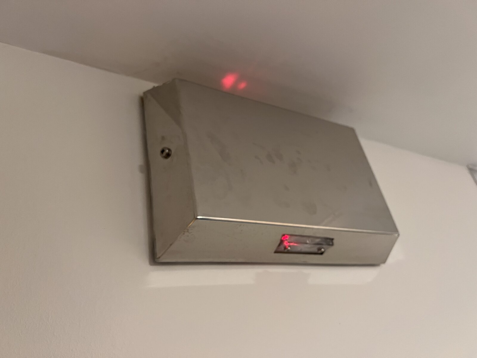

1. Does anyone recognise what model of bell box this is? I believe this was installed in 1999 under the previous owners so this might be a push. I have sadly tried to find it to no avail.

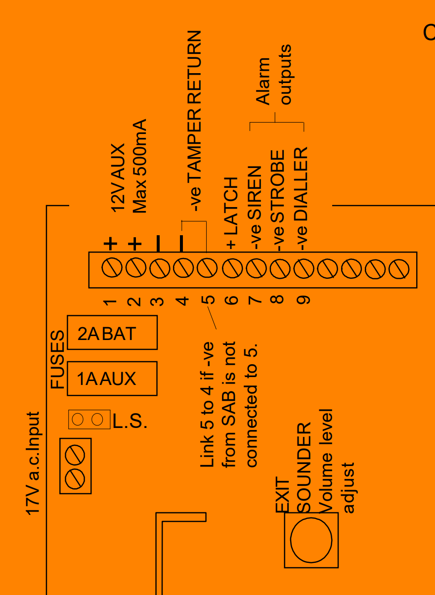

2. It's my understanding that I can keep it in hold off via connecting +12V & -12v to the battery. However the alarm manual has somewhat confused me; is it the light blue or black wire (4 or 5) for negative? (with + being red).
I did try to remove the external sounder cover briefly to disconnect the internal battery but it was encased & given I live in a block of flats I had to quickly put the cover back on to avoid deafening the neighbours.
Thank you!

Looks similar to a rapier but the light appears to be in the wrong place from the models i can find images of.
You are keeping this bell box yes?
The way i read that is there is no link between 5 and 4 therefor what ever is in 5 should be the -ve of the SAB.
