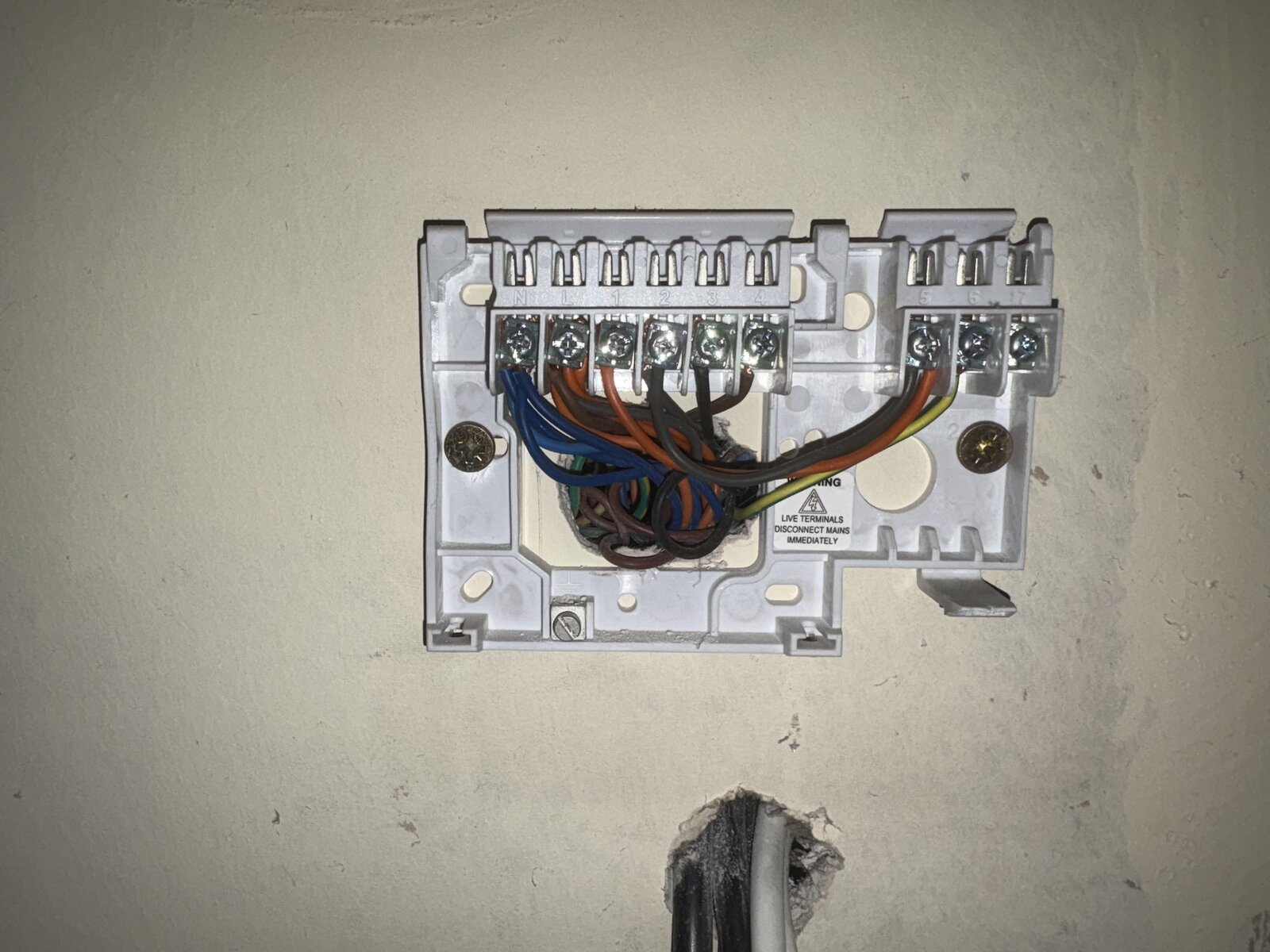

Hi
I’m looking to replace my Climote with a hive. I have tried it but can only get downstairs and hot water working with hive control can’t figure out how to get the upstairs wired to work or is it even possible to do it with hive. I’ve looked at other posts on this but can’t figure out. Any help would be greatly appreciated. This is the wiring for Climote. I have 3 zones hot water downstairs and upstairs.
Thanks from your reply
Can I wire to have upstairs and downstairs come on from the hive together instead of splitting
Do I need another hive thermostat and controller to operate 3 zones and how would I wire this from what I have .
Can I ask why you want Hive? Drayton Wiser do a 3 channel kit which would suit your Installation.
