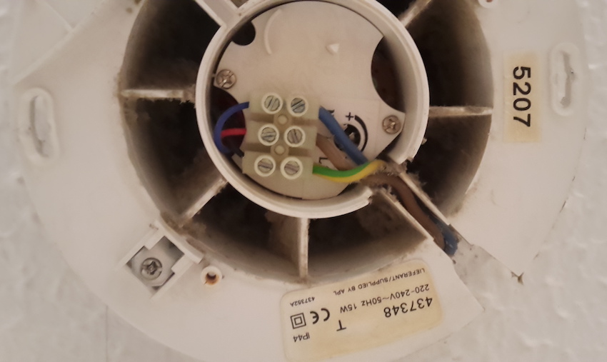

Hi
I want to replace the extractor fan that I inherited in my bathroom, which has now broken. It had a timer on it. It came on when the light was switched on and then turned off a certain amount of time after the light was turned off.
The old one currently has 3 wires attached to N, L and LS.
The new fan needs to be connected to Neutral, Permanent Live and Switched Live. I'm assuming L = Permanent Live and LS = Switched Live. Would you agree?
However, having read some similar posts on this site, I'm thinking that there should also be another earth wire. The other posts suggest that this should be folder over and kept away from the other 3 wires.
I've added some photos. Appreciate your help on this.
Rich

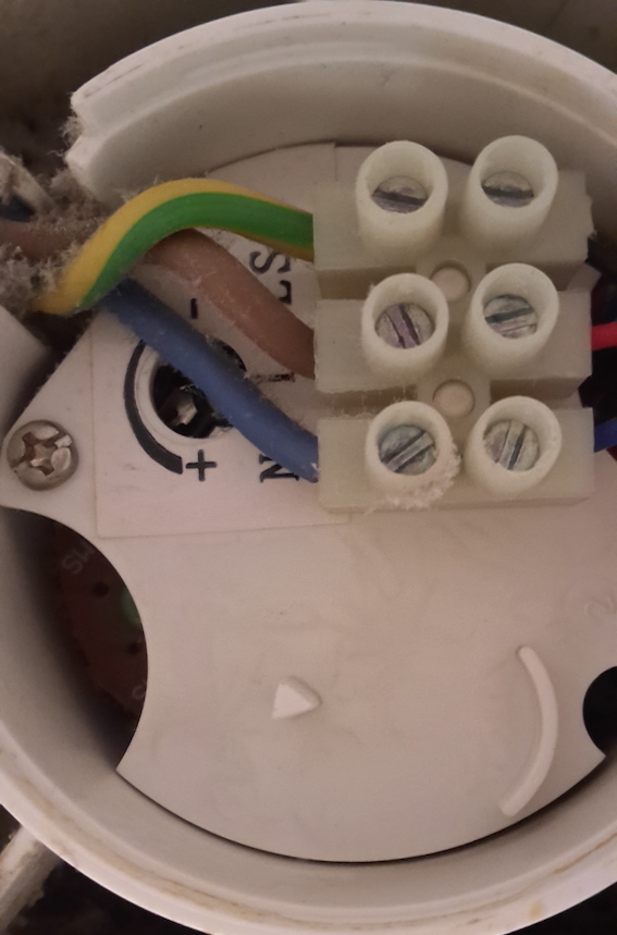

It would seem the earth core has been used for the switched live.
Not ideal - should at least be sleeved both ends with brown sleeving.
By rights the cable should consist of 3 cores AND an earth wire.
If it's easy to change the cable, it would be a much better job.
Admittedly the real earth wire wouldn't actually get connected to the fan, it would just get terminated in a separate connector block - but there you go.
Yes.
There is a green/yellow wire in your picture but it is not being used as an earth wire. This raises a couple of issues.
The first is that BS7671 requires an earth wire to be taken to each point and each accessory. A fan is not an accessory but if the flex feeding the fan is fixed wiring then the terminals of the fan are a point. Your picture appears to me like the flex is burried in the wall, in which case I would argue it is fixed wiring and therefore to be compliant there needs to be an earth core.
The second is that a green/yellow core has been used for something other than earth. Doing this without marking it as such using sleeving is noncompliant and can become dangerous if the next person to work on the installation does not notice what has been done. Even if it is marked then it's questionable practice though depending on how exactly you read the relavent regulation it might be barely passable.
Putting all this together I would assume that the fan was installed by someone who either didn't know or didn't care about good wiring practices. My next question at that point would be "what else has this guy done".

Thanks everyone for your help on this.
To confirm, the flex is buried in the wall and the earth wire has been used for the Switched Live (LS).
Based on the above, ideally I would replace the cable with 3 cores and an earth. However, since this is in the ceiling, it is difficult to do without damaging the ceiling. The earth wire running to all points is for future need, so not required at present. Therefore, I can continue to use the cable which is there. Best practice would be to change the sleeve so that the wire is brown at both ends.
I do not need to install an rcd, as I am not fitting a socket or changing the circuit.
I hope I've got that correct.
Thanks.
