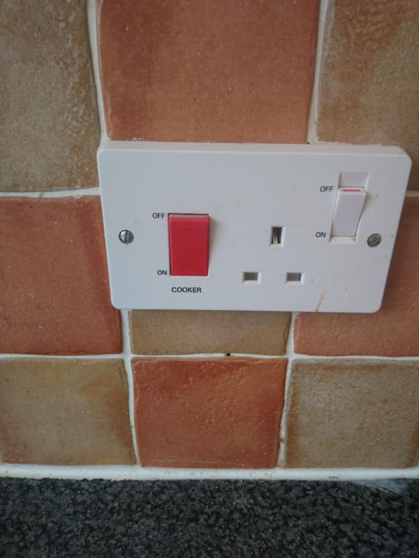

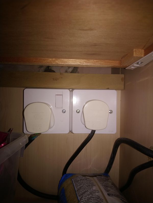

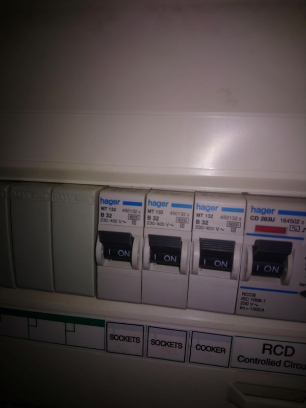

Hi,
We are in the process of replacing our gas hob with an induction one.
Looking at the wiring (20 year old kitchen) the cooker runs off a 32A RCD to a kitchen switch. When I look in the cupboard they wired this to a dual gang socket which the hob and oven plugs in to.
The wiring is 6mm to the switches.
I can swap the switches for one of these CLICK POLAR 45A EASY FIT DUAL APPLIANCE OUTLET PLATE and wire up the new appliances.
My new oven is 3.5Kw and the hob is 7.3kw.

Your cooker circuit can have both the new oven and hob connected via a dual appliance outlet plate.
Just to help, if you need to talk about it to anyone, the 32A thing is an MCB (Miniature Circuit Breaker).
