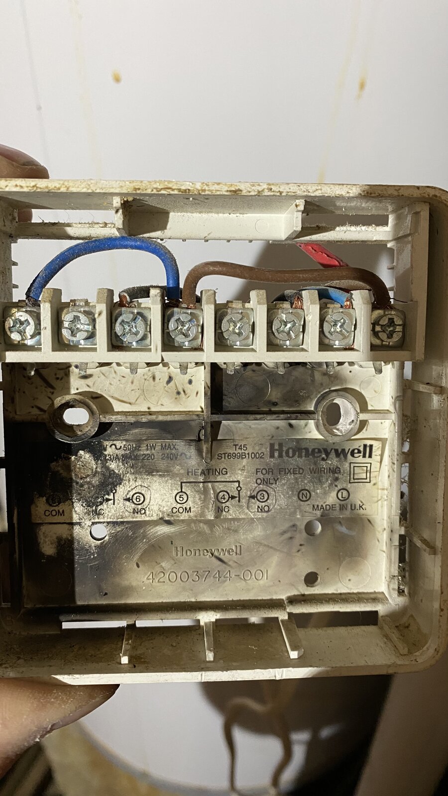

Hello, blown my programmer due to it getting a drip of water on it. so looking to replace with a new one, but not sure on the wiring
Looking to get the st9400c as this looks like a simple swap? But open to suggestions and also how much harder would it be to install one with a wireless thermostat?
Photo of the current wires.
system is a gas boiler with separate hot water tank

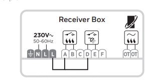

If you replace it with just a wireless thermostat, then you’d lose hot water heating capabilities. To have both, you need something like the Honeywell TR6-HW, Nest, Hive etc.
Not much different:
L - L
N - N
Link wires (terminal references included in instructions)
Heating on
Hot water on
Presently the functions of the terminals at the ST9400C are:
The existing wires move from the terminals at the ST9400C to the T6R Receiver that have exactly the same function.
So from the above diagrams:
ST (N) = T6R (N)
ST (L) = T6R (L)
ST (1) = T6R (F) [May or may not be used depends on the existing system wiring]
ST (2) = T6R (C) [Unlikely to be used]
ST (3) = T6R (E)
ST (4) = T6R (B)
The receiver also needs links between the second (L) (A) and (D) terminals as shown in the diagram.
The old wired room thermostat can be left in situ and set to its maximum setting so that it doesn't interfere with the new one. Or, if you want to remove it. That can be done by finding the origin of the cable that goes to the room thermostat. Note where the wires are connected at their origin and disconnect the thermostat cable. Then link the terminals where the two ‘live’ switching wires came from together, so that they are electrically connected.

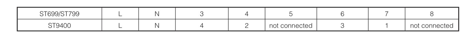

looks like what’s going to be in my budget at the moment is just the ST9400C
What’s the wiring changes on this one if anyone can help?
Have a look at this:
