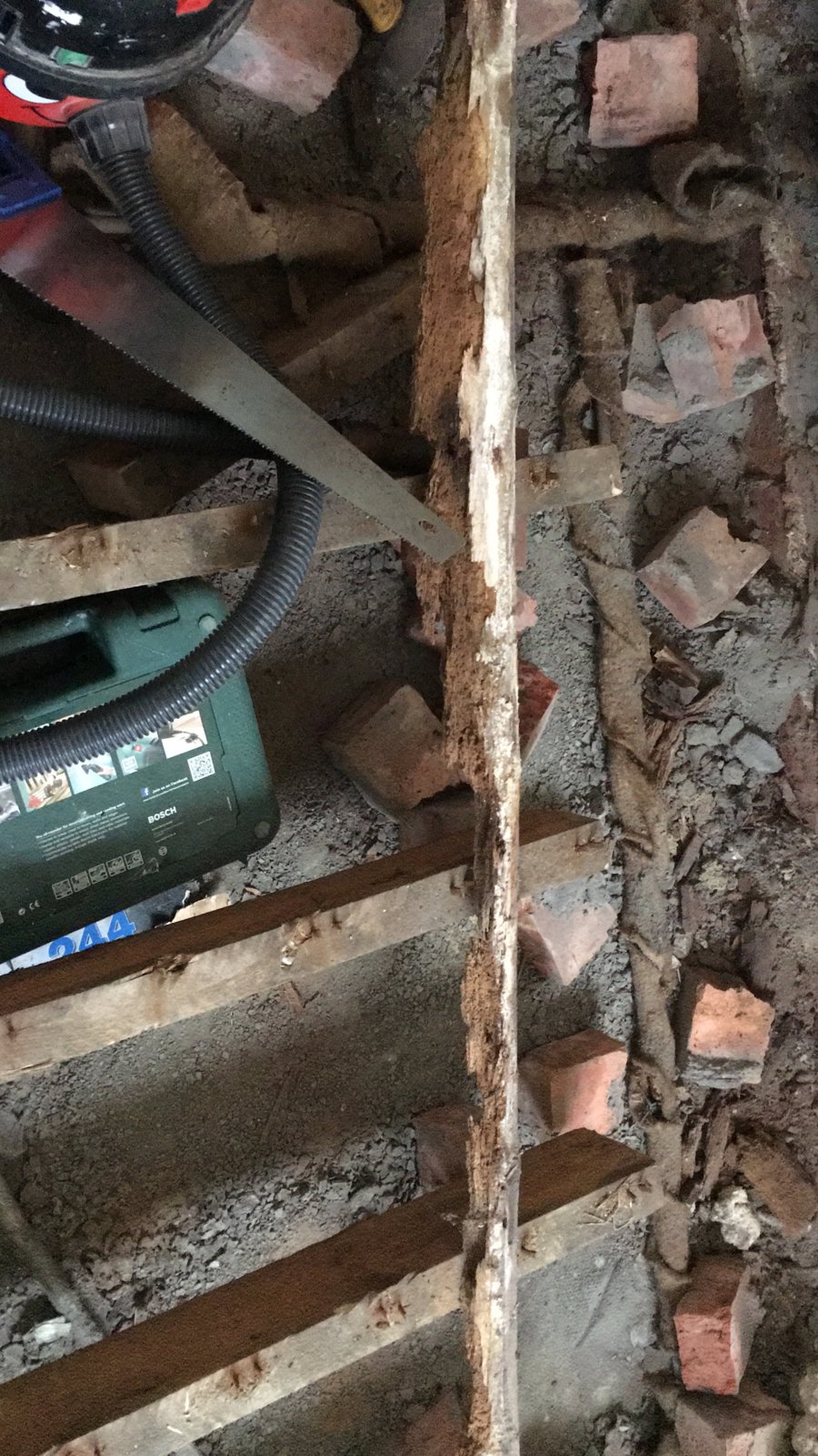

Well I don't think these were doing too much...
Only problem is that the joists run under the floor in the next room as well so I'm not replacing the whole length, just sistering new ends.
This is all that was left of the horizontal board they were sat on.
Aside from the high drive there was a lot of mortar piled against the base of the wall bridging the dpc along most of its length on the inside wall.
If these weren't running under the living room floor I suspect it would all have collapsed quite a while ago
How much overlap do I need between the old joist and new section?
I've got a load of radiator pipework right up against the last joist in the room and I'm thinking the easiest thing would be to cut the old joist before the pipe then move the pipes so they are behind the new bit of joist.
If I did that though I'd only have about 750mm of overlap.
