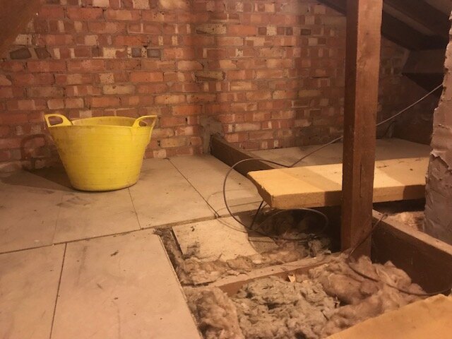

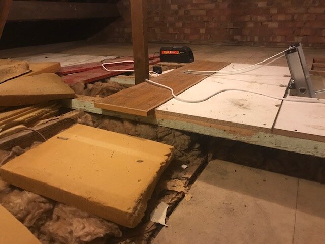

I currently have different thickness of insulation:
- some places with 270mm (or maybe slightly less) of insulation which had been boarded over
- some places with 270mm but not boarded over
- some places with less than 100mm and boarded over
- I cannot really see what there is at the eaves as the roof pitch is quite low and it would be difficult for someone to add something there
Are building control likely to ask me to top up insulation to 270mm?

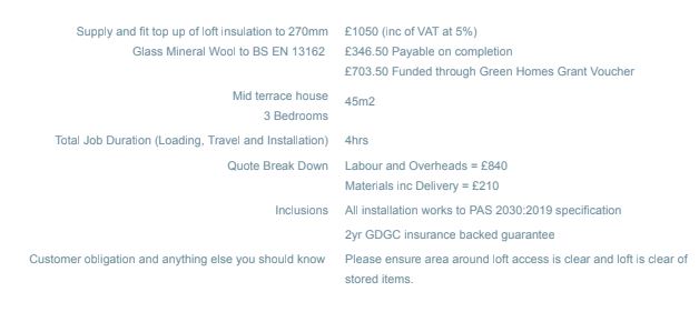

I also got this online quote from a company that can access the Green Home Scheme:
£345 payable after the grant voucher is applied
The quote mentions topping up to 270mm, but I'm unsure what that means and what materials they'll use; are they just unrolling fiberglass into the loft? Are there other materials available that don't release fibers into the air?

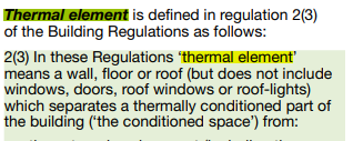

@woody - I think that shows @frutbunn interpretation is correct. A "thermal element" ....which separates a thermally conditioned part of the building.... So if there is adequate ceiling insulation the roof void above is not a thermally conditioned part of the building (a conditioned space) and hence the roof is not a thermal element, hence no app needed.
That's how I interpret it as did other colleagues, though you could make an argument that the entire roof construction including the ceiling is all one element, this is the view my old boss took, though this may have been swayed somewhat by the fee chargeable for one quick visit.
