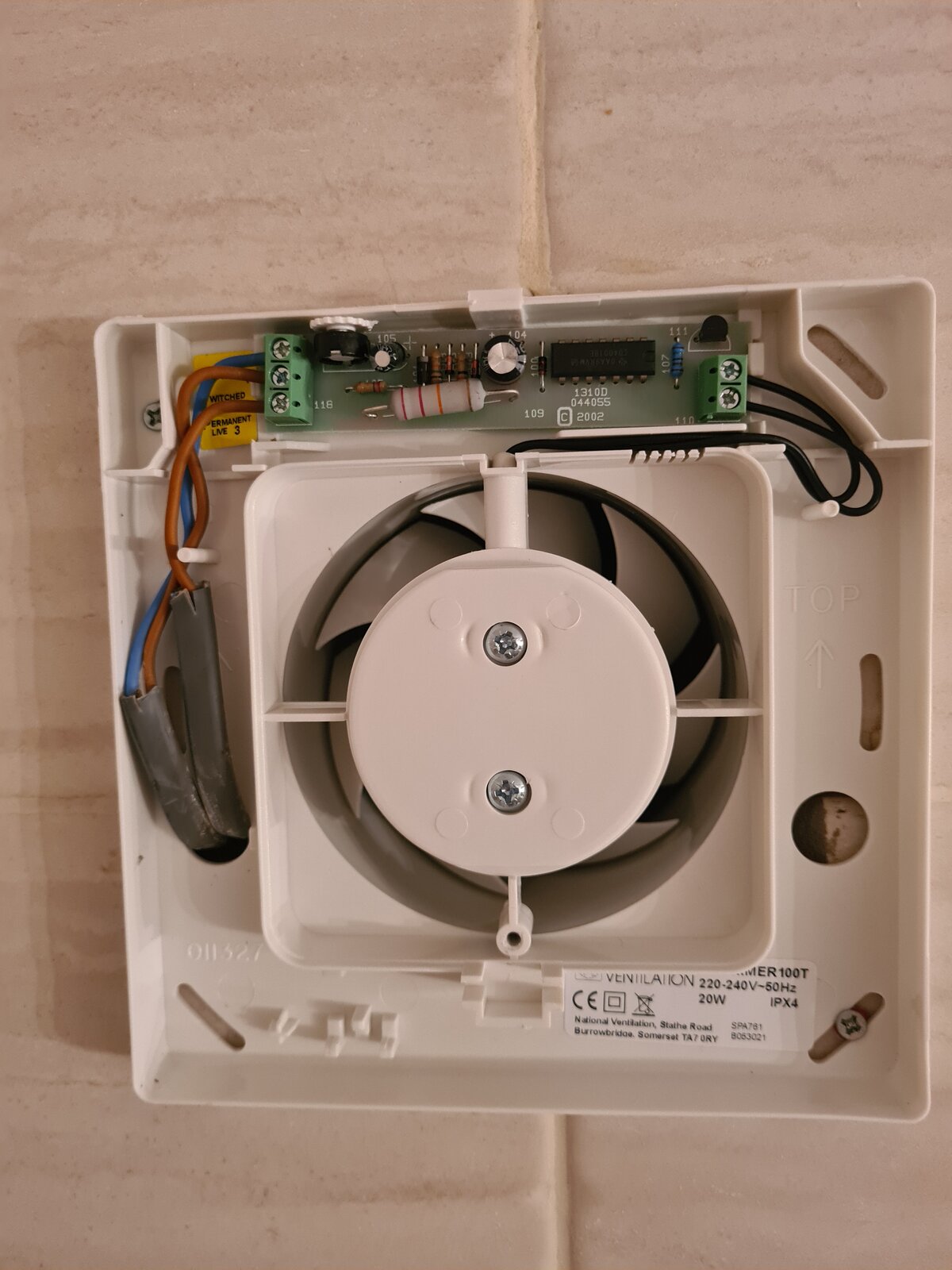

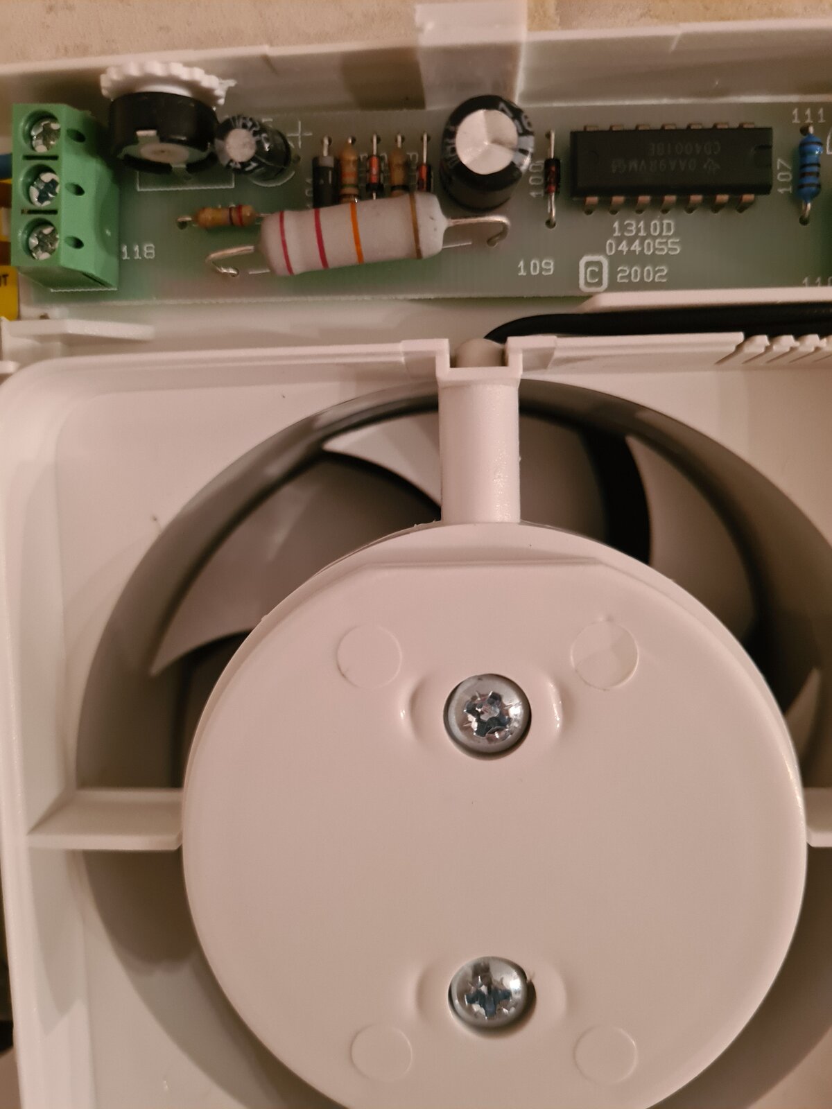

I have attached photos, it's the big grey thing I'm finding to be quite hot, like it feels warm through the plastic casing, is this normal would you think?

A resistor that size: they are expecting it to get hot by design. Not great design in my opinion.
Pretty standard on these things, however as said above, not the best design but most of these fans are similar inside. The inccidents with these things going on fire tend to be more to do with stalled motors and the internal thermal protection in the windings has failed to operate, I've found them before where the motor was stalled, getting hot and had melted the cover fixings in place. The best thing you can do is to keep it free of dust and fluff and if the bearings start to fail (you'll hear it) switch it off before they go totally and seize up

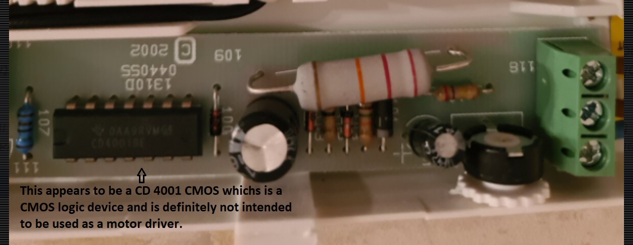

The resistor is likely being used as a voltage dropper resistor, a very inefficient design - perhaps even designed for 220v, rather than the UK's 240v.
A very strange ( or very inventive ) circuit design. A CD4001 is four logic gates which can each switch up to about 6.8mA maximum at 15 V supply
