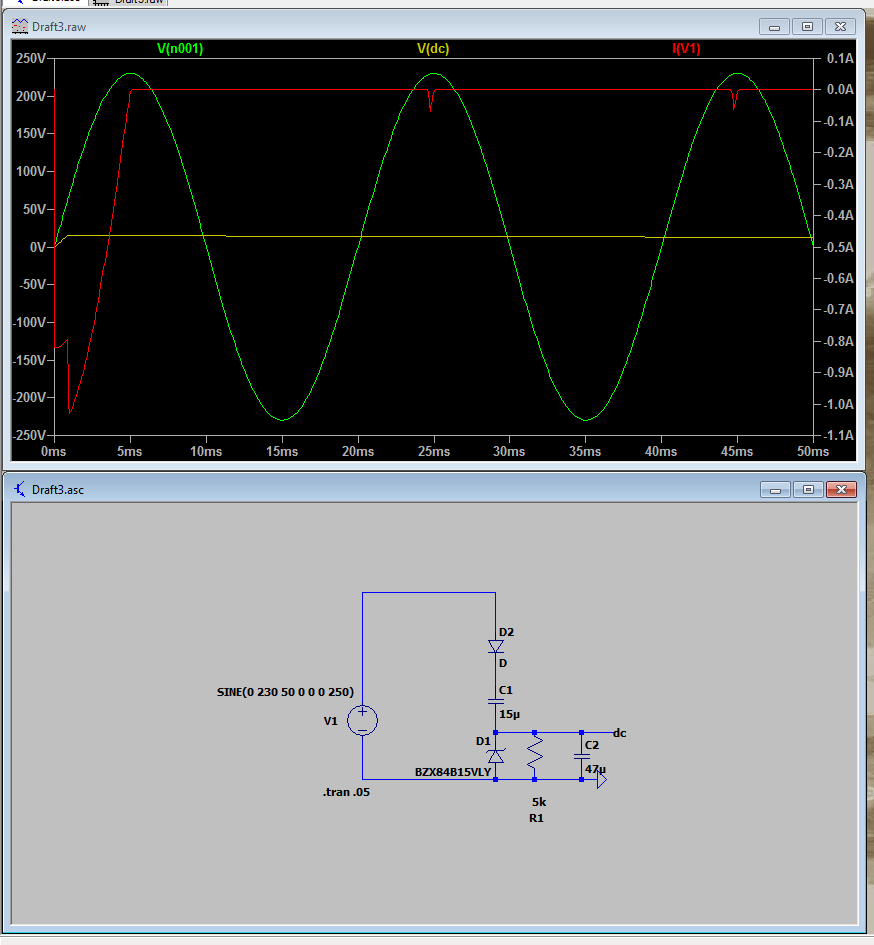

What you suggest doesn't actually work (try simulating it to see why). However something like this might:
The 5k is a rough guess at the average load.
What you suggest doesn't actually work (try simulating it to see why). However something like this might: .... The 5k is a rough guess at the average load.

Well, you need to play with the components. But the red line shows the current drawn (so also through the zener) scale at right hand side.
Your version (if I guessed it right) gave about 0V at the output.

John, I only spent about 5 minutes trying 4 or 5 versions, and I accept that I might have made a mistake. What you see is the first arrangement that worked. I'll have a go tomorrow and see if I've maligned you. If you weren't aware this is LTspice, is free, and a good way to check things like this fast. I've had enough for today, so sorry for the wait.

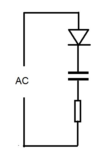

John, we were both wrong, for the reason that Bernard explained, and you later realised. If I continue the plot for a longer time, the supplied 15V just dies away. If I get time I'll try a few other circuit arrangements.
The capacitor can be charged once and only once during the first positive cycle of the supply, it cannot lose that charge as the diode prevents any current from leaving the capacitor.

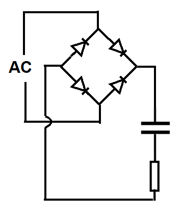

However, that immediately begs the question as to how/why cheap LED 'lamps' (and my dimming of them with a series capacitor) actually work. The answer, I presume, is that (as I had overlooked), they utilise full-wave, rather than half-wave, rectification, thereby providing the 'discharge path' for the capacitor which, as you say, is absent with half-wave rectification. This real-world situation therefore becomes this, which I would think does. will work, doesn't it? :
Returning to what started all this, if that does work, then there ought to be plenty of physical space to replace the rectifier diode with a small encapsulated bridge rectifier and to replace the infamous resistor with a 'small' capacitor, shouldn't there?

It gets more complicated.

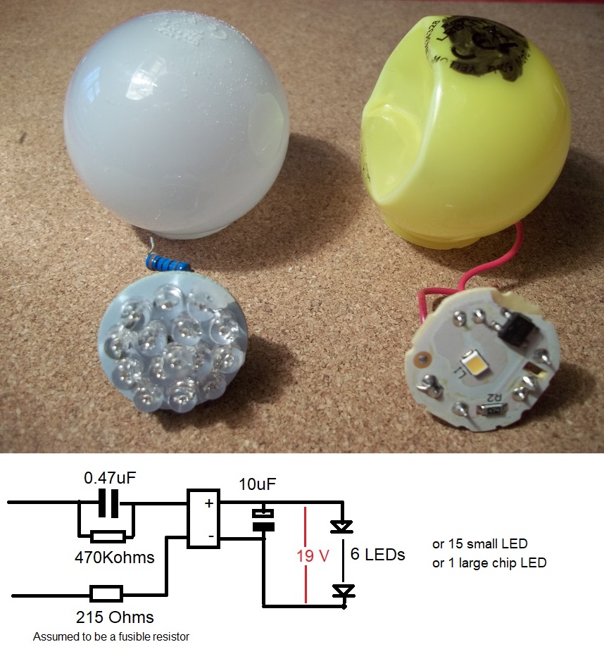

Given that two capacitors in series ( with no other components ) will have the same amount of charge ( current x time ) then the smaller capacitor will have a higher voltage ( V = charge / capacity ) than the larger capacitor
But with 1 Watt LED lamps with a full wave rectifier between the capacitors the circuit becomes a charge pump. The charge that passes through the 0.47 uF capacitor passes into the 10 uF capacitor. The rectifier bridge prevents that charge leaving the 10 uF when the AC reverses. Instead when the AC reverses the 10 uF capacitor gets another 0.47 uF worth of charge thus increasing the voltage on the 10 uF capacitor. Eventually the voltage on the 10 uF capacitor becomes high enough for the LED elements to light and also act as a pseudo Zener diode.
These LED lamps are rated at 230 V but two in series ( 115 V each ) appear be as bright as they are on 230 V.
