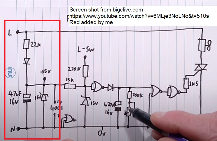

Resistor hot in bathroom extract
Why is it thought that the resistor is carrying current when the fan is off?
It is carrying current as long as the Live and Neutral are active irrespective of whether the fan is rotating or stationary
The components in the red box provide a permanent 15 Volt supply to the rest of the circuitry
But why is that necessary?
Good question :)
With this circuit in particular, there may be no guarantee of the state the NOR gates were in, when the power was turned on?
There would have to be an additional part of the circuit, to latch the fan to the permanent live for the timer duration.
Another circuit could be chosen, but this is probably the most economical for the manufacturers to produce.
As bernard has said, it's down to the powering of the 'electronics' which produce the run-on delay. If the supply for the electronics was derived from the S/L., rather than the permanent L, the fan would probably come on when the light was switched on, but the fan would then go off immediately the light was switched off, because the electronics sustaining the run-on would also have lost its supply.
To get around that would not be impossible, but would introduce more complexity, since a way would have to be devised to maintaining 'alternative' supply to the electronics after the light had been switched off - either with a battery (or very large capacitor) or by 'switching' to a supply derived from the perm L during that period.
Maybe I haven't thought this through well enough, but what I don't really understand is why they do not (as with cheap LED 'lamps') use a capacitive 'dropper', rather than a resistor, in which case the heat (and most of the 'energy wastage') would go away.
