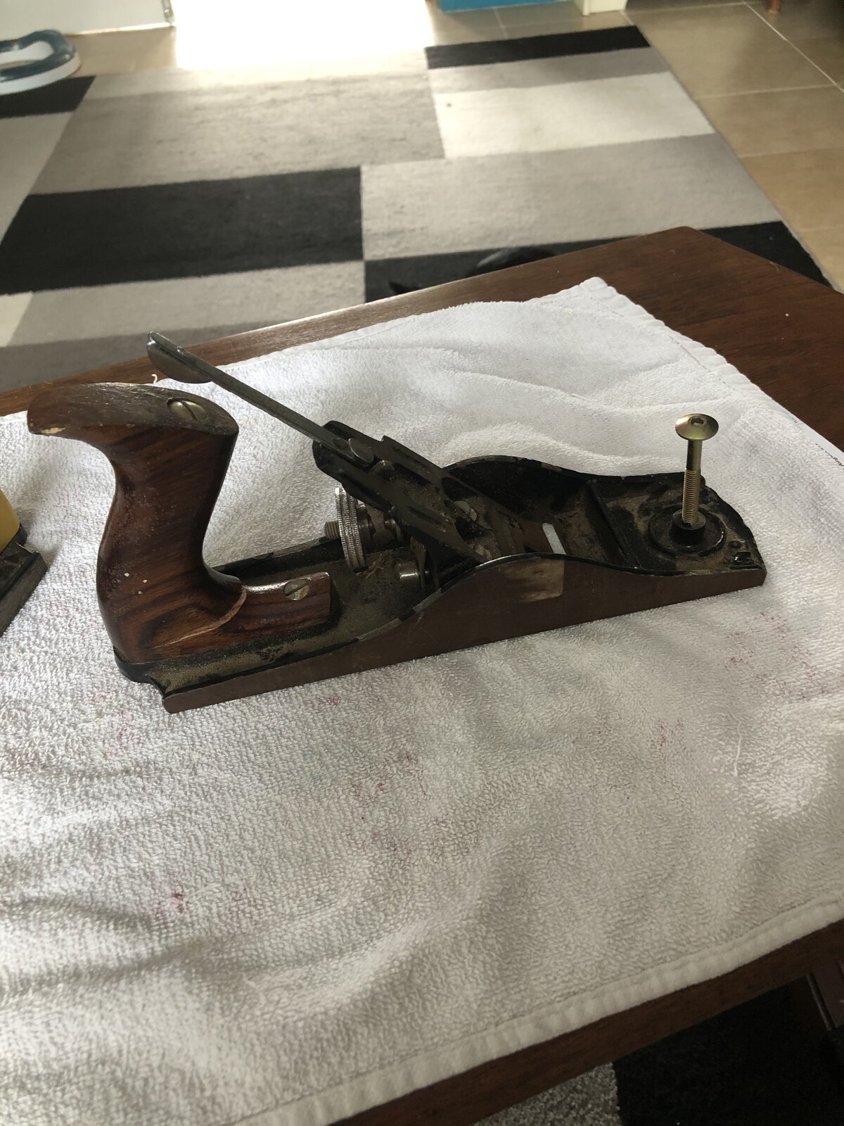

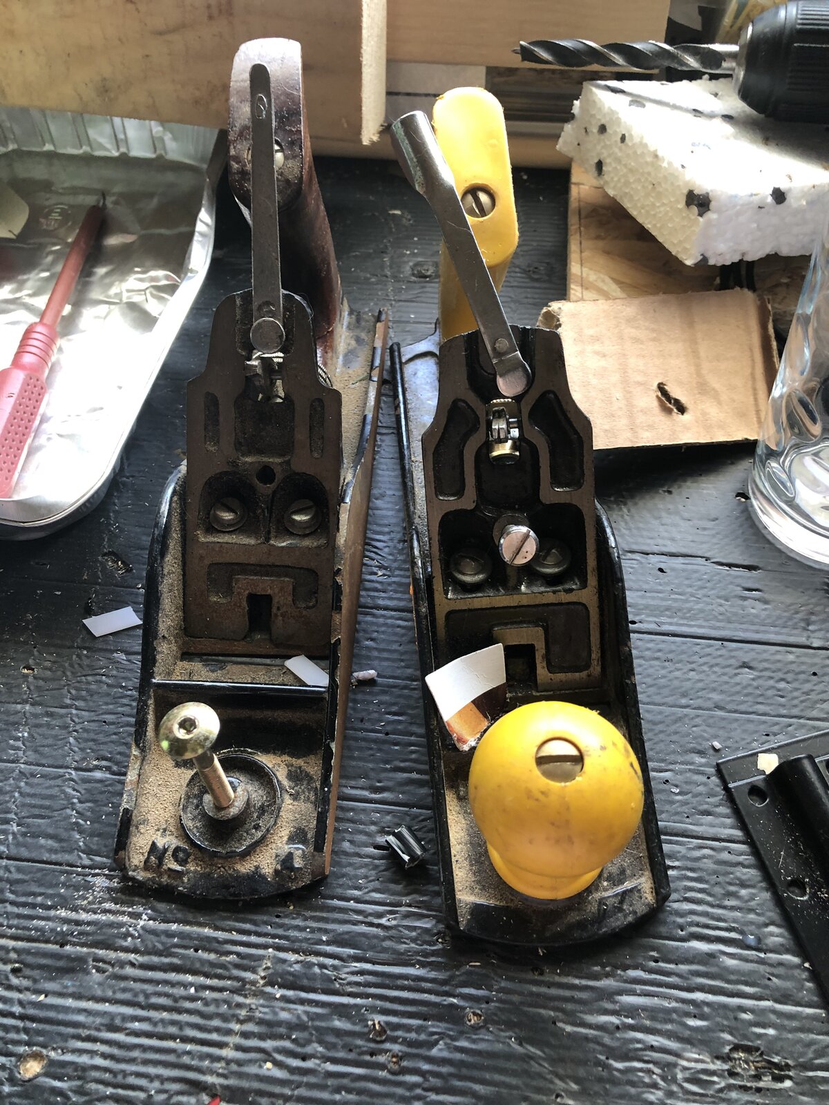

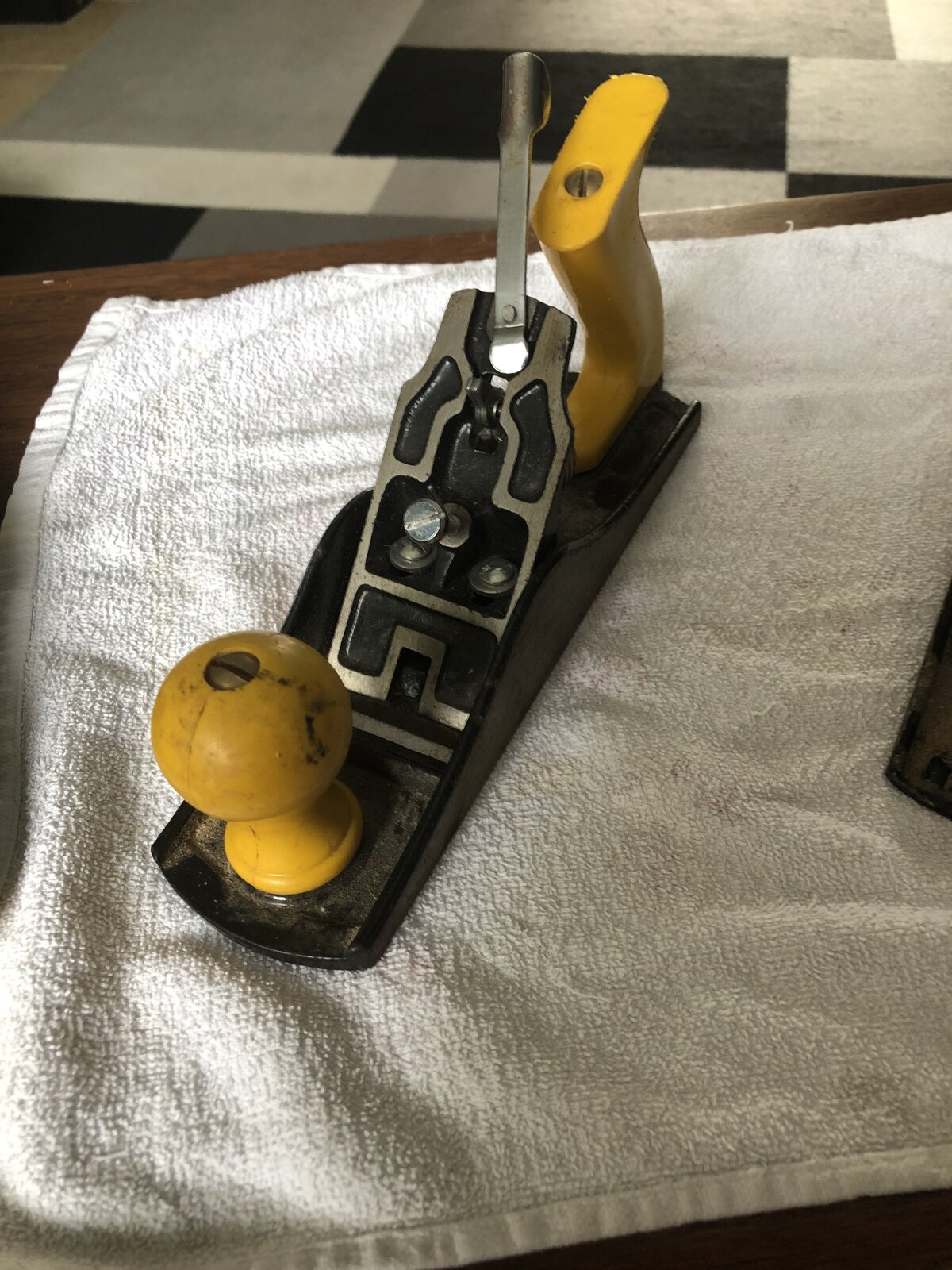

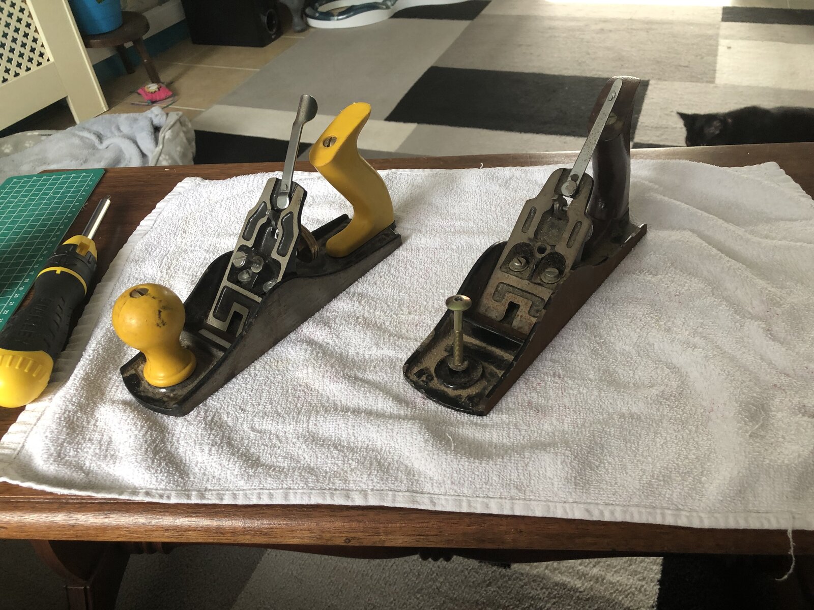

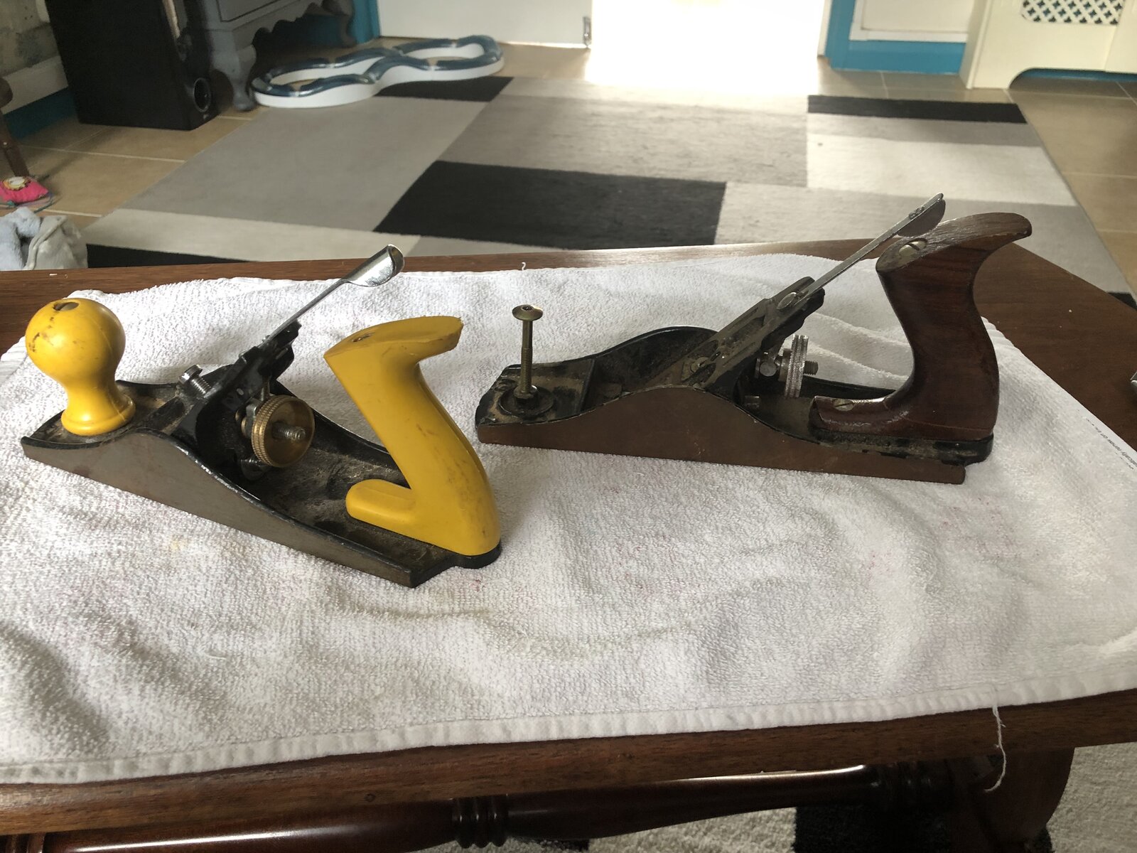

so, a couple years ago I believe, I brought 2 no.4 planes that were missing bits and I was wanting to “upgrade” other bits (the handles). I brought 5 blades, 3 were on clearance/sale, 2 were 10x the price I paid for the planes combined each minimum.

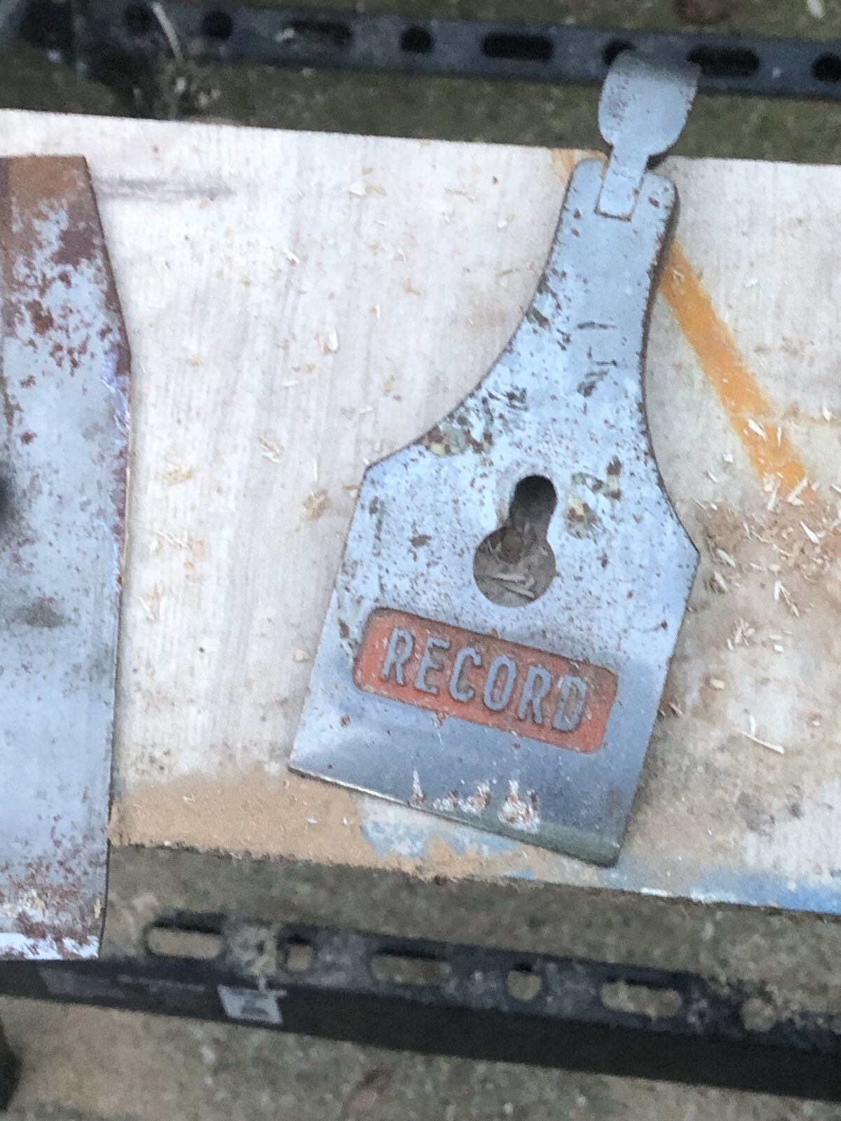

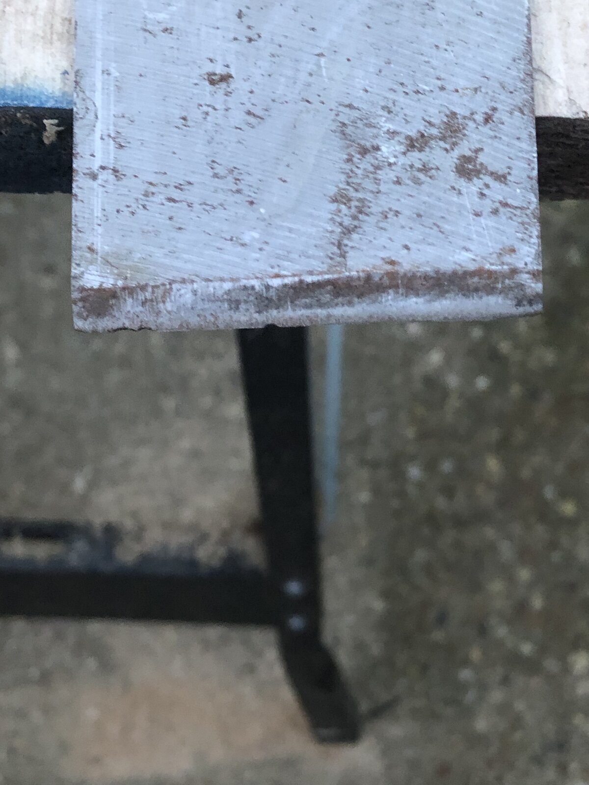

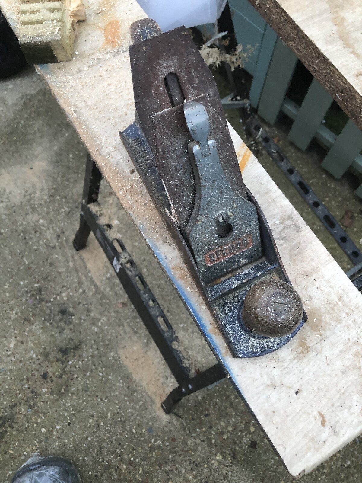

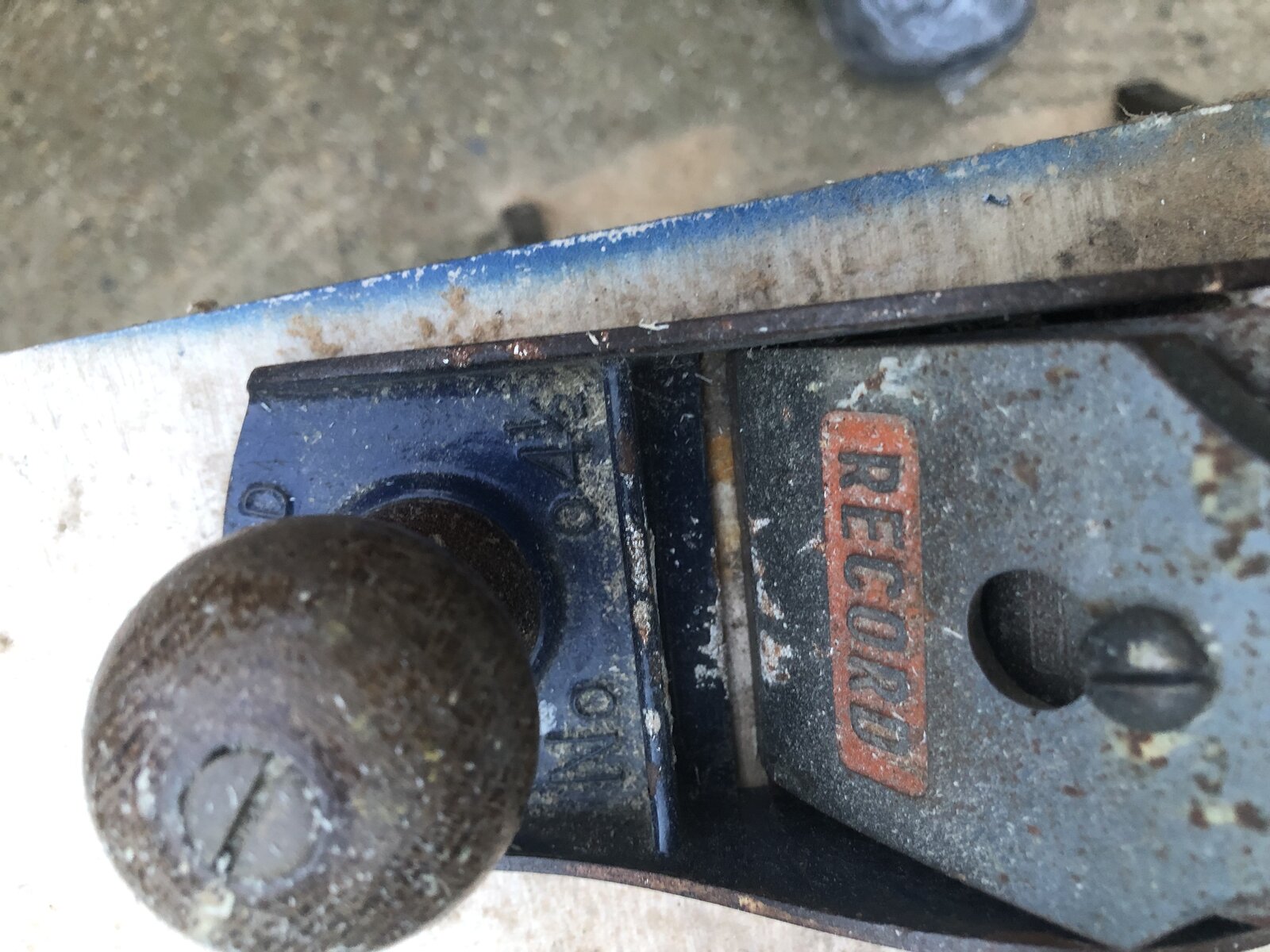

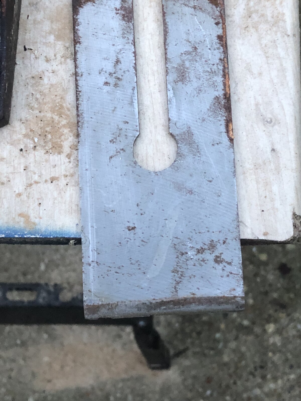

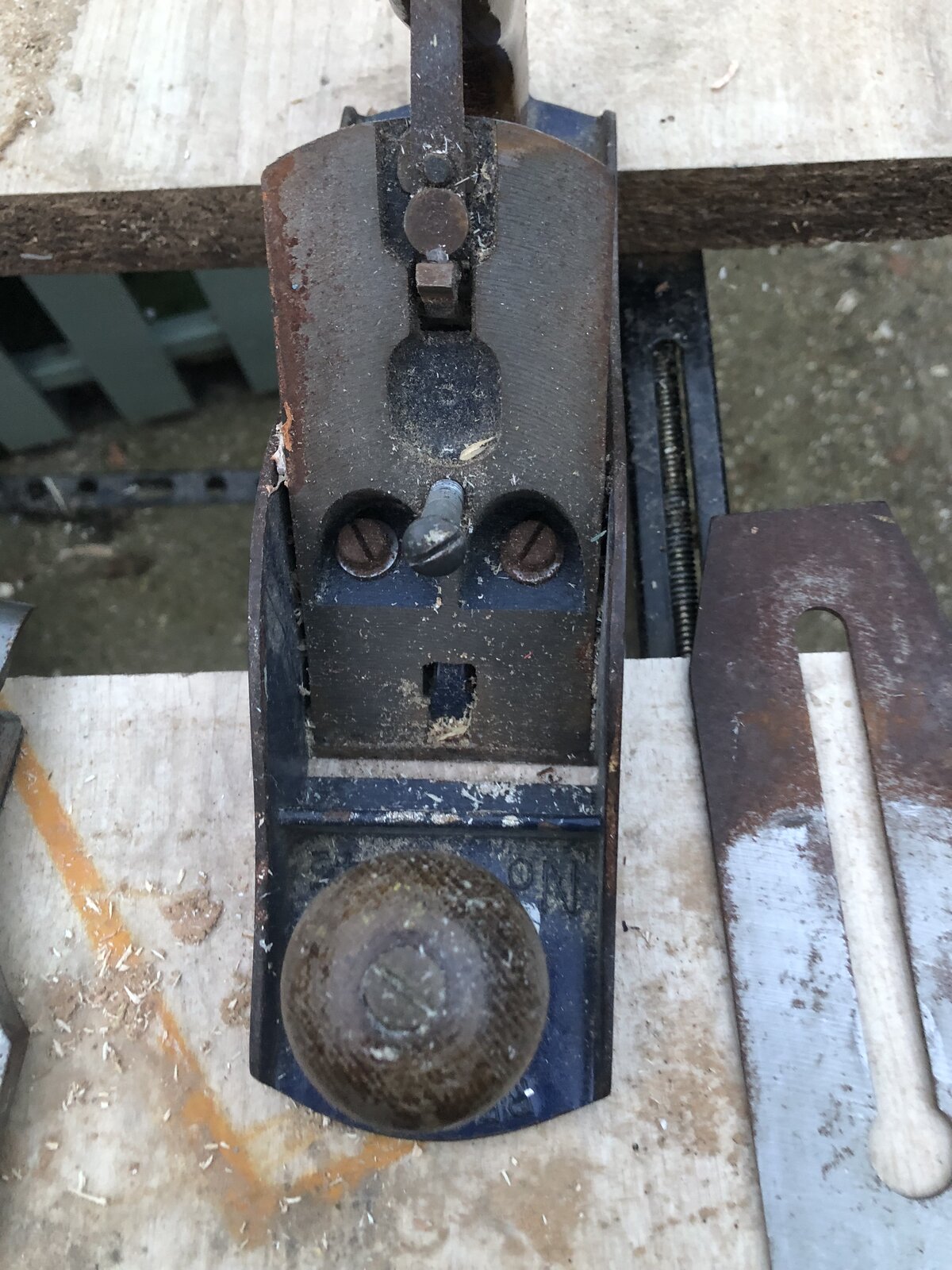

I think it was about 15 months ago I brought a beaten up record no.4 1/2 plane, no missing parts, but the blade beaten up and badly chipped. What would be the fastest way to get the iron back to full sharpness? I only have a mini sharpening station (I don’t have a bench grinder although thinking about getting one).
The problem is the missing parts really, they both require a new chip breaker and iron cap. At least that’s what think it’s missing and unknown if the names of the parts are correct so here I am… do you see anything I need, that I have missed? Where would I get the parts for these? I would also like to replace the plastic handles for real wood.

Ideally you need a horizontal whetstone grinder or equivalent, or maybe a bench grinder with a wheel that is as least as wide as your blade.
You can use thinner grinding wheels of course, but it depends on how much experience or practice you've had using them.
You can even get by with a belt linisher with an 80 grit belt, but again it needs to be wide.

so I know I am missing 2 parts on each plane, but is there anything else I have missed?

A belt linisher, such as this:
Has a belt of around 100mm wide so it's wide enough for plane irons.
It's simple enough to make a rest for the grinding angles needed.
For sure, it isn't the best machine for this but a whetstone horizontal grinder won't take out notches in the blade - it's really just for honing.
A thin bench grinder wheel isn't really suitable either - it's too easy to grind to much, overheat or generally wreck the blade unless you have had a lot of practice.
I use my linisher with 120 grit belts, and then it's on to an oil stone for the final hone.

Post a close up picture of the blade from the Stanley 41/2 plane and if worth sharpening and worth your while mailing two ways I could grind for you.

Here are some pictures of the 4 1/2 in front plane.IMG_3773.jpegIMG_3776.jpegIMG_3777.jpegIMG_3778.jpegIMG_3780.jpegIMG_3781.jpeg
