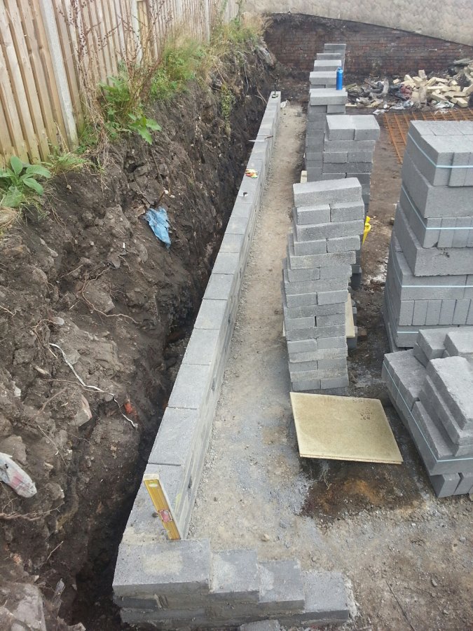

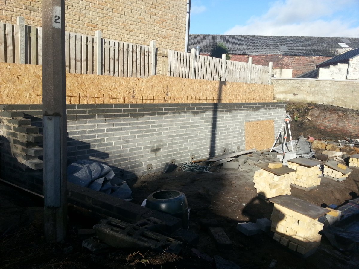

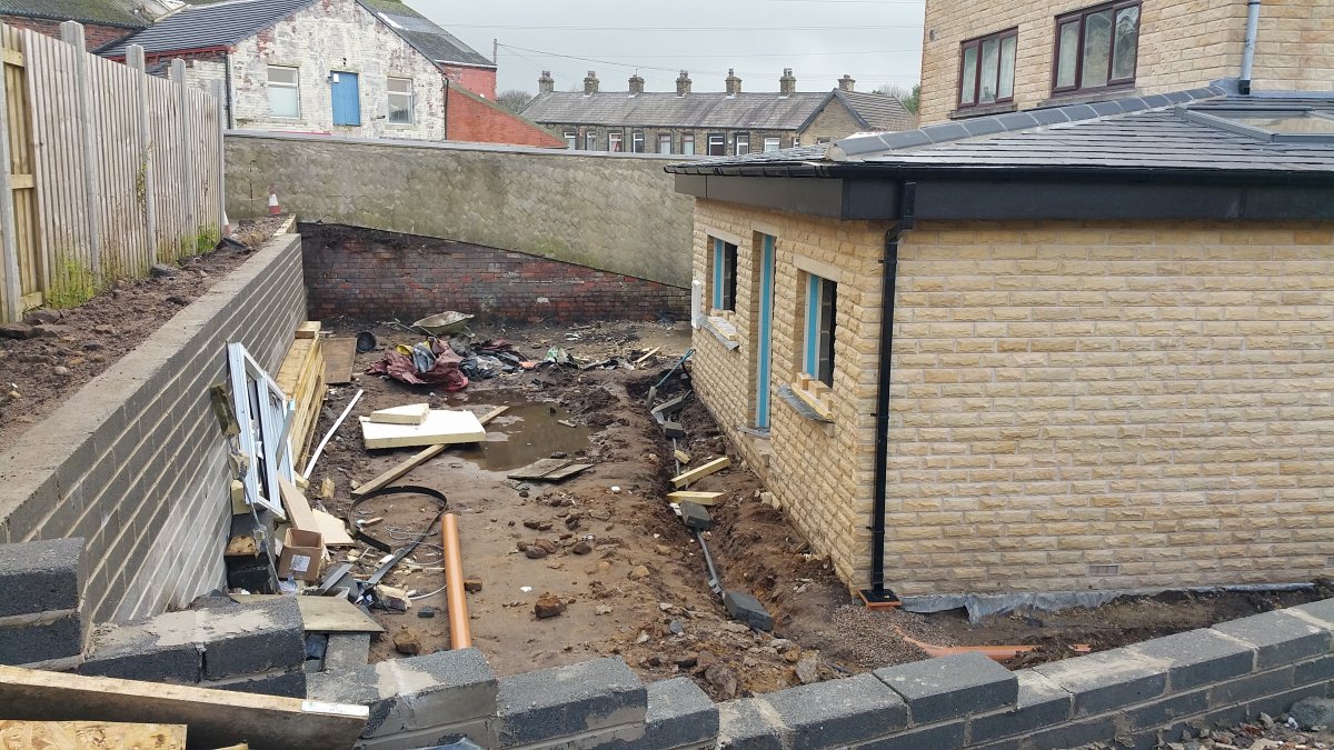

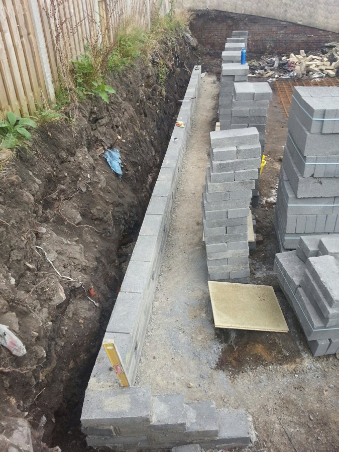

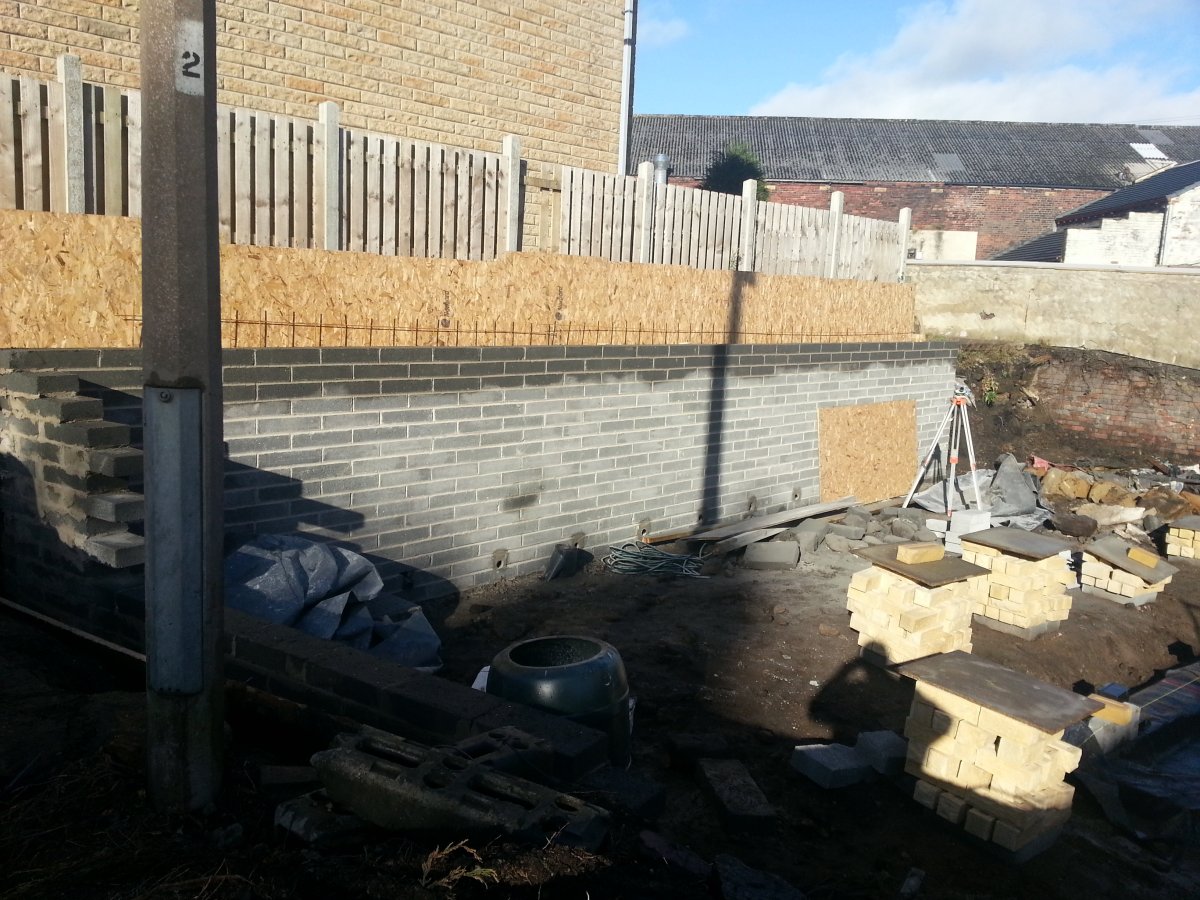

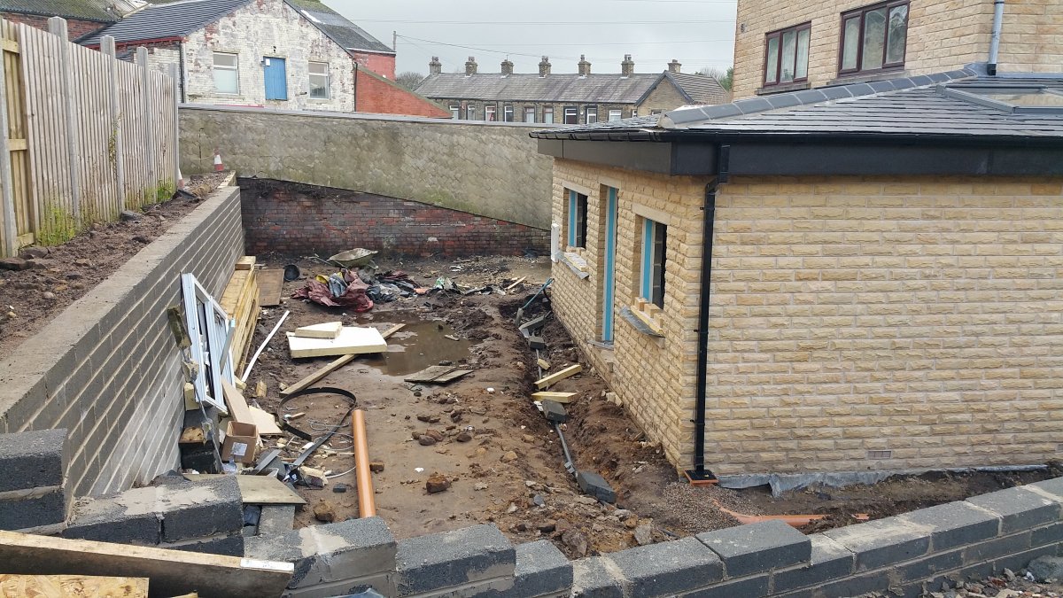

You need something like this

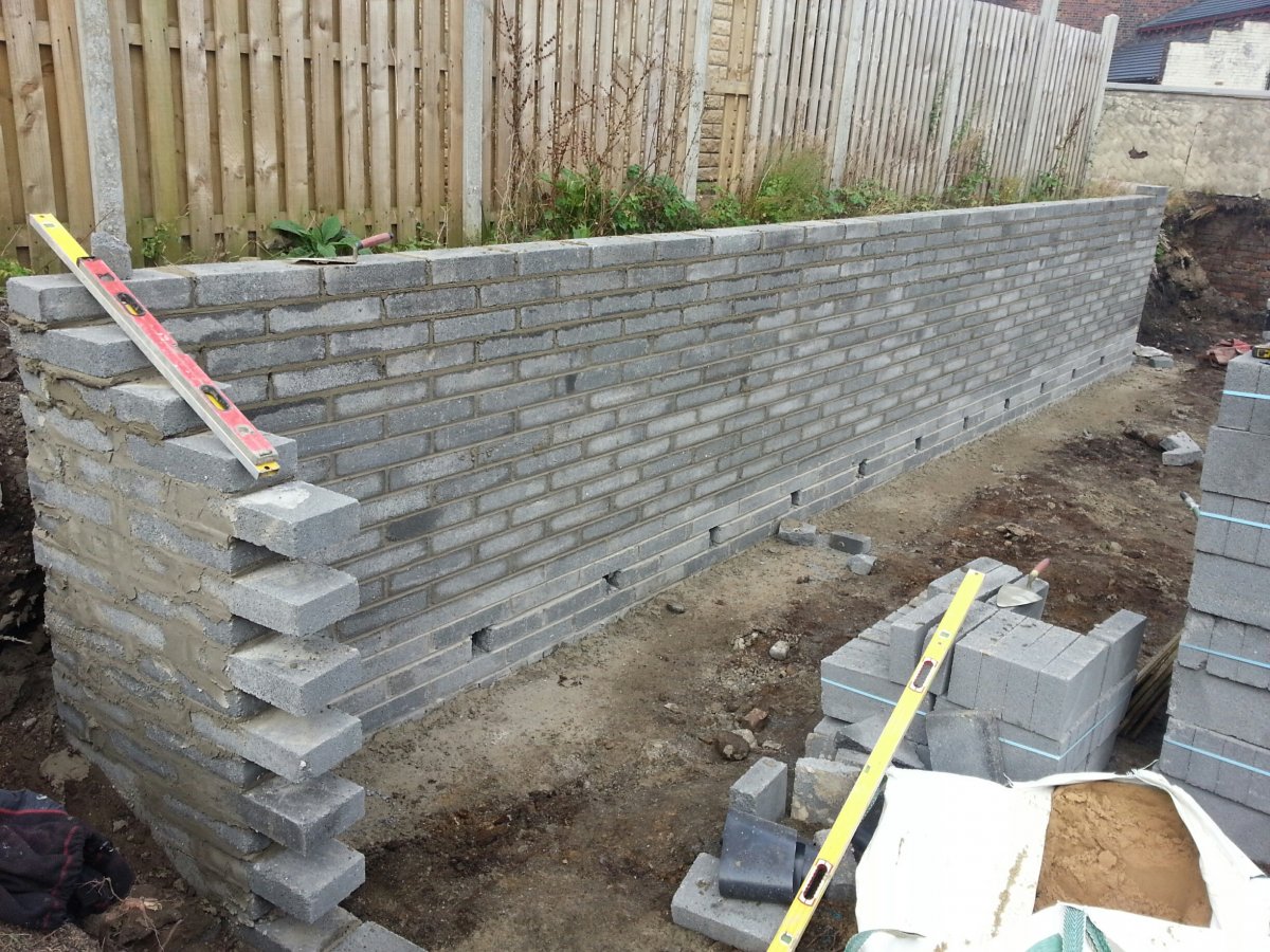

That looks really good.
I've been told I need the hollow blocks with rebar though I'm not sure if I have to if the footings are good.
Only other issue is that I can't dig deep footings. The digger have got to very hard soil/chalk so digging a trench may be difficult.

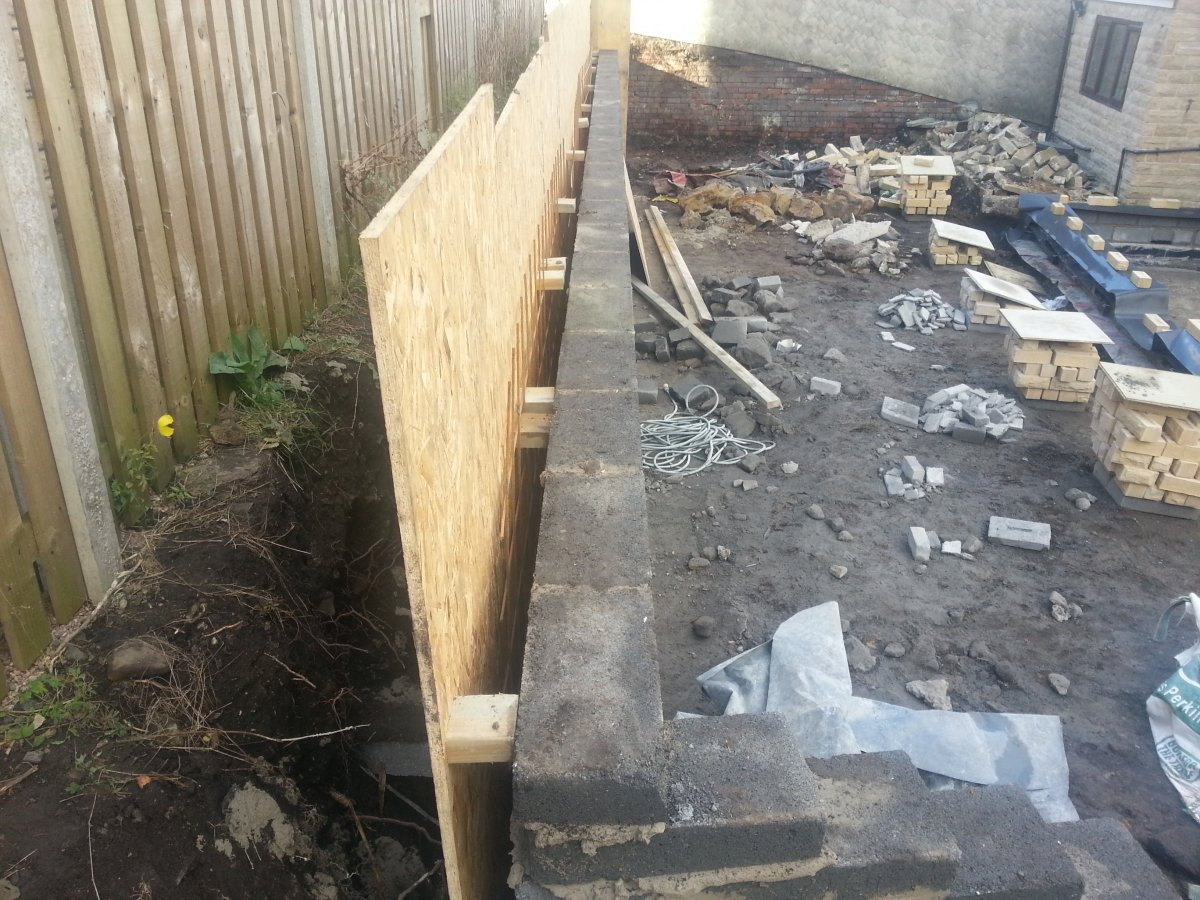

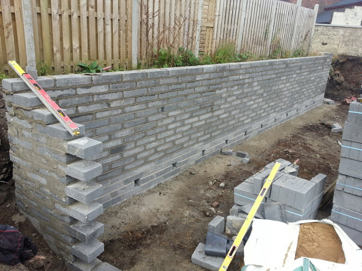

That's the block the builder quoted for so he obviously feels it won't topple over.

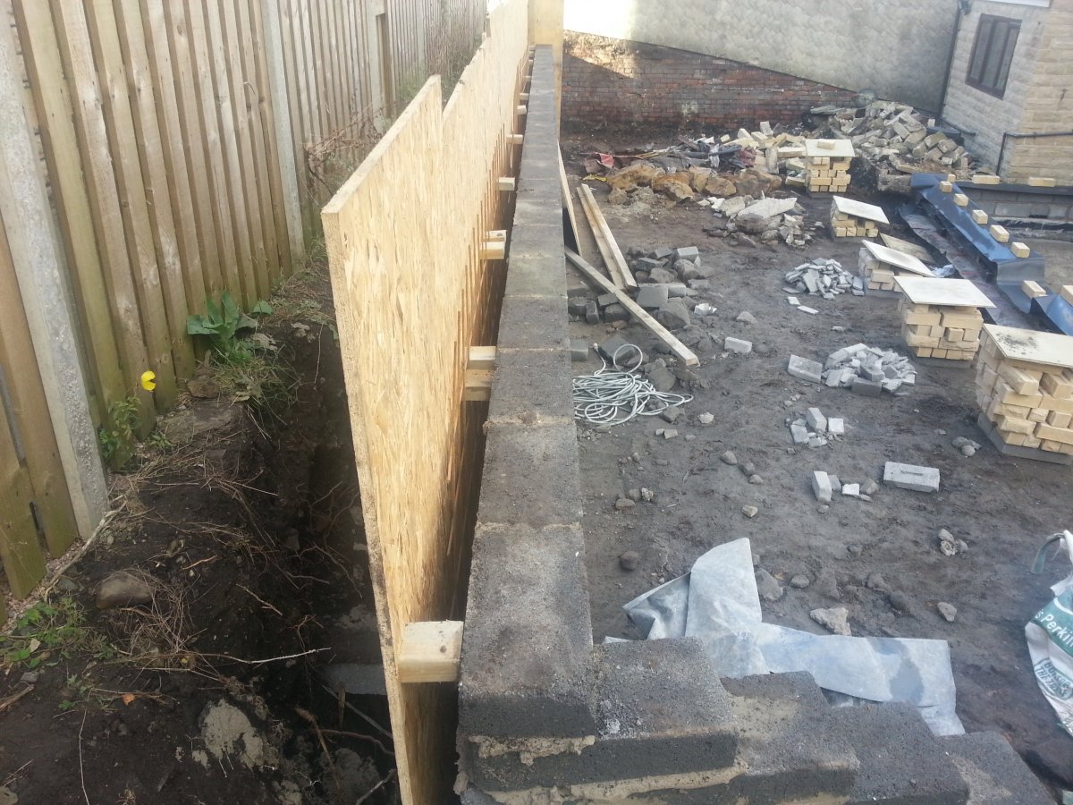

Whilst it may look good its pretty suspect if that's the finished article. 9" blockwork is ok for retaining 2 maybe 3 feet but that looks more like 5. If its still standing plumb in 10 years its purely down to good luck. Lets hope there are no small kids playing near it.
Matt I know you've been given a hard time by me and others but that I because we have seen walls fail like this. Also we don't want to put a spec on an open forum where it will appear in search results forever and others looking similar information take it as being suitable.
If you are going to go ahead with the wall anyway without an engineer I have sent you a spec of a similar wall as a guide via a pm.
The wall is reinforced with concrete with a steel/iron mesh.
